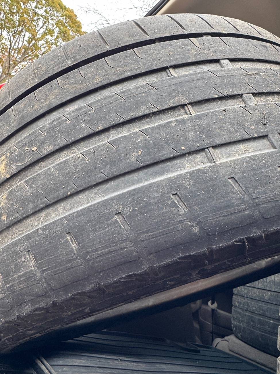

How else am I gonna take 15 mph turns at 50?
That's the problem. You have the camber to go 50 in a 15mph turn but you're not doing it often enough, so you're wearing out unevenly.
For anyone looking at tire wear, you might want to get symmetrical tires so you can flip them when the camber starts to wear further on one end, especially if you're doing a lot of highway pulls or hard braking. High torque with a front heavy fwd car is definitely like a 911 for tire wear, just flipped backwards. Ultimately your tire pressure needs to be spot on and you should drive to the alignment of the car. This is not a car you drag race. If you want to be launching it and ripping through 1st and 2nd gear, take out camber for better grip and less inside wear.
Ps4s are technically a 30k tire that typically lasts 20k on sporty cars. It likes some camber but not too much. It also likes higher pressure than you'd think, so the factory specs are really a minimum. It wouldn't be unreasonable to air up before you plan to drive it hard, especially on the fronts. Low pressure and hard driving will wear out the shoulders of this tire very quickly.
That's good to know. I've definitely been experimenting with tire pressure lately. Sounds like I'm too low. On the 275/35/R18 tires in my pics, I was running around 34 PSI front and 31 PSI rear (cold). Sounds like that might be a tad low.
Thanks for the info! I'll try some higher pressures when it's time for summer tires again.
