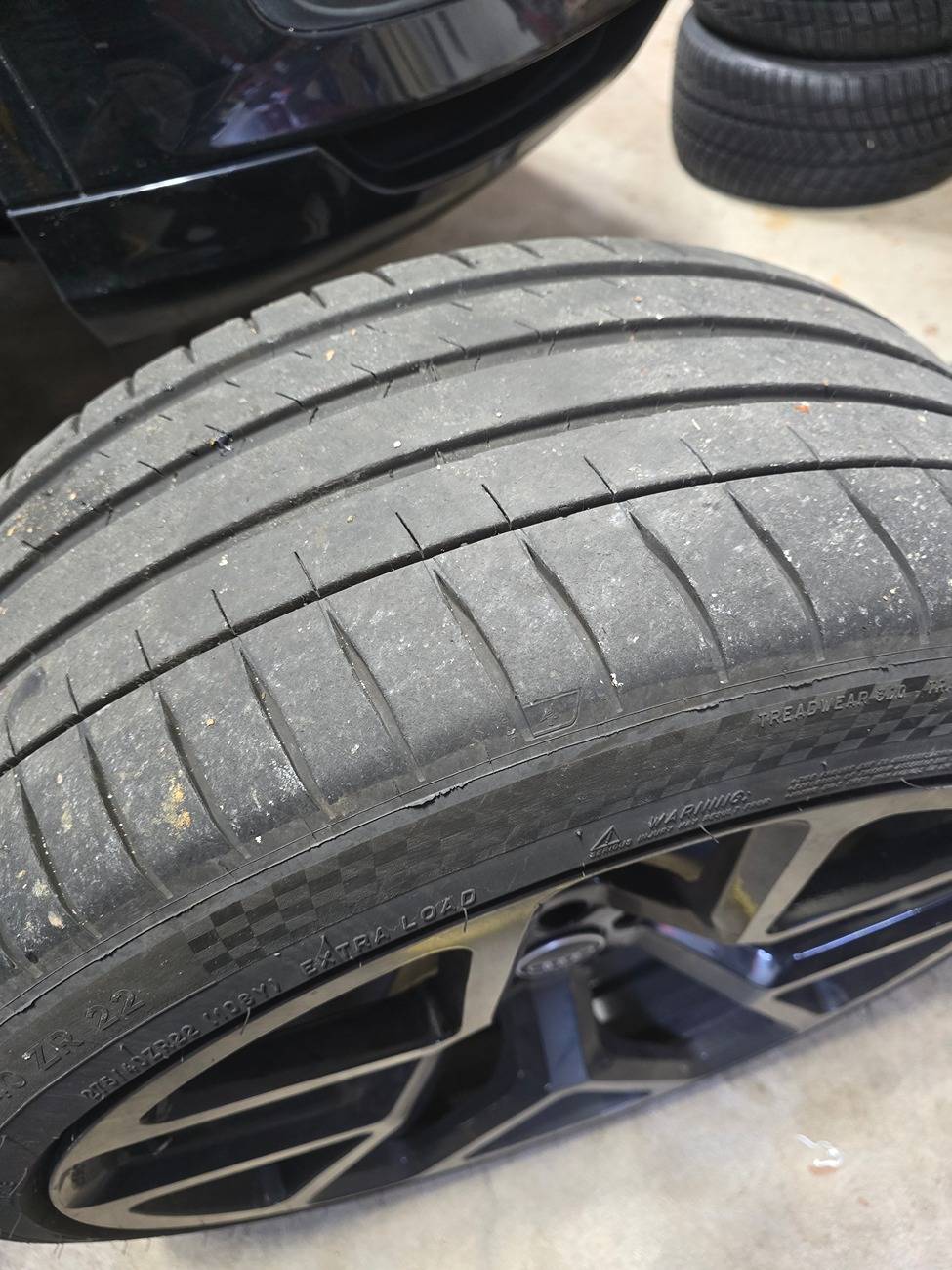

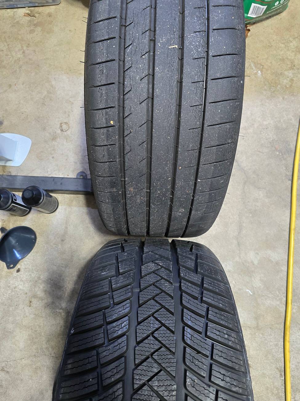

Here's mine at 3k. 9/32nds left in front and 9.5 back. One track day with a very rough surface and approximately 120 laps. The wear is even and camber correct for track use. Street use and hwy pulls would need some camber taken out.
And here's a ps4s from another car with 8k mi on it and 7/32 left. You can tell it's a lot cleaner looking because that car doesn't see track time, unless you count my wife ripping it from daycare to her work as track time.

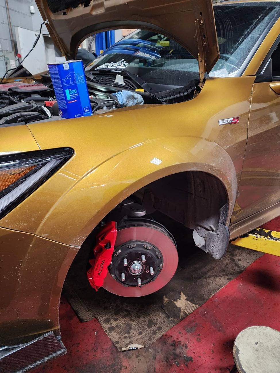

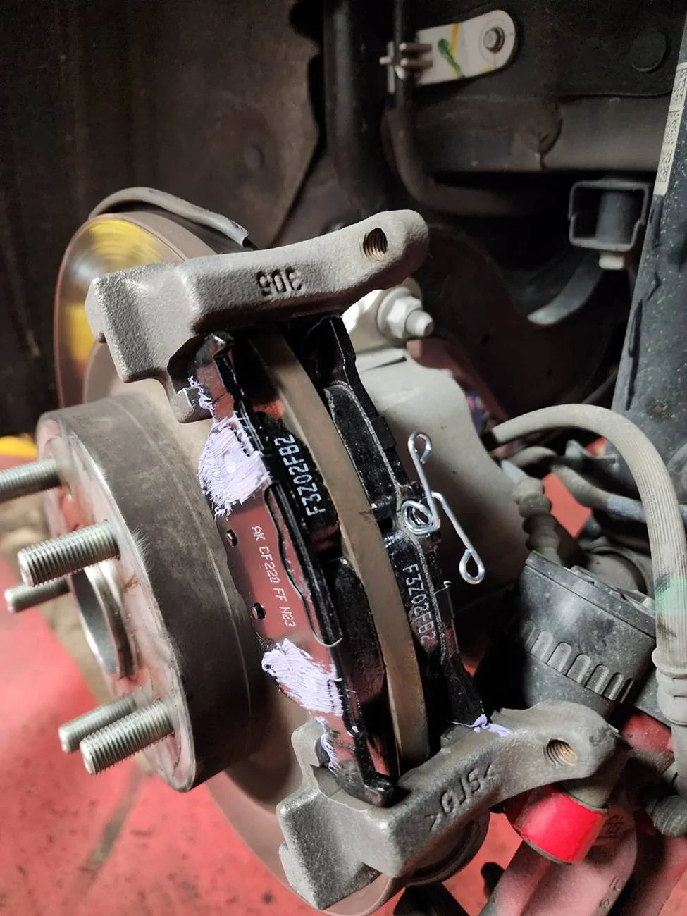

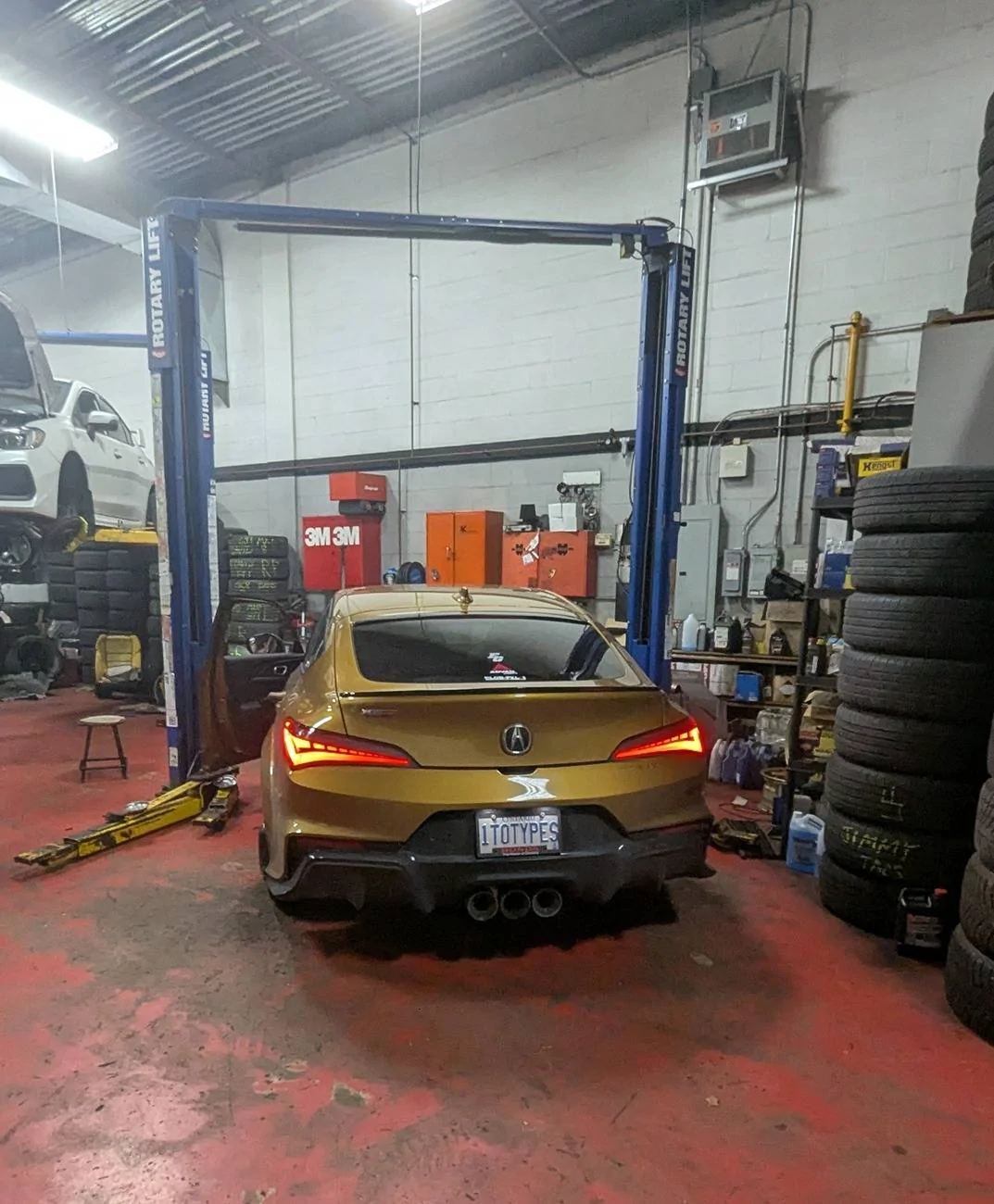

Just changed my rear pads, brake flush (ATE type 200 fluid ) - 1 track day ( 7 sessions (1 warm up, 3 hot laps, 1 cool down) 35,000 km - rear rotors are fine.
Front pads still have 50% (OEM)
Acura Integra ITS DE5 Warped Rear Brakes 10K Miles 1000159367
Acura Integra ITS DE5 Warped Rear Brakes 10K Miles 1000159370
Acura Integra ITS DE5 Warped Rear Brakes 10K Miles 1000159373
Acura Integra ITS DE5 Warped Rear Brakes 10K Miles 1000159384

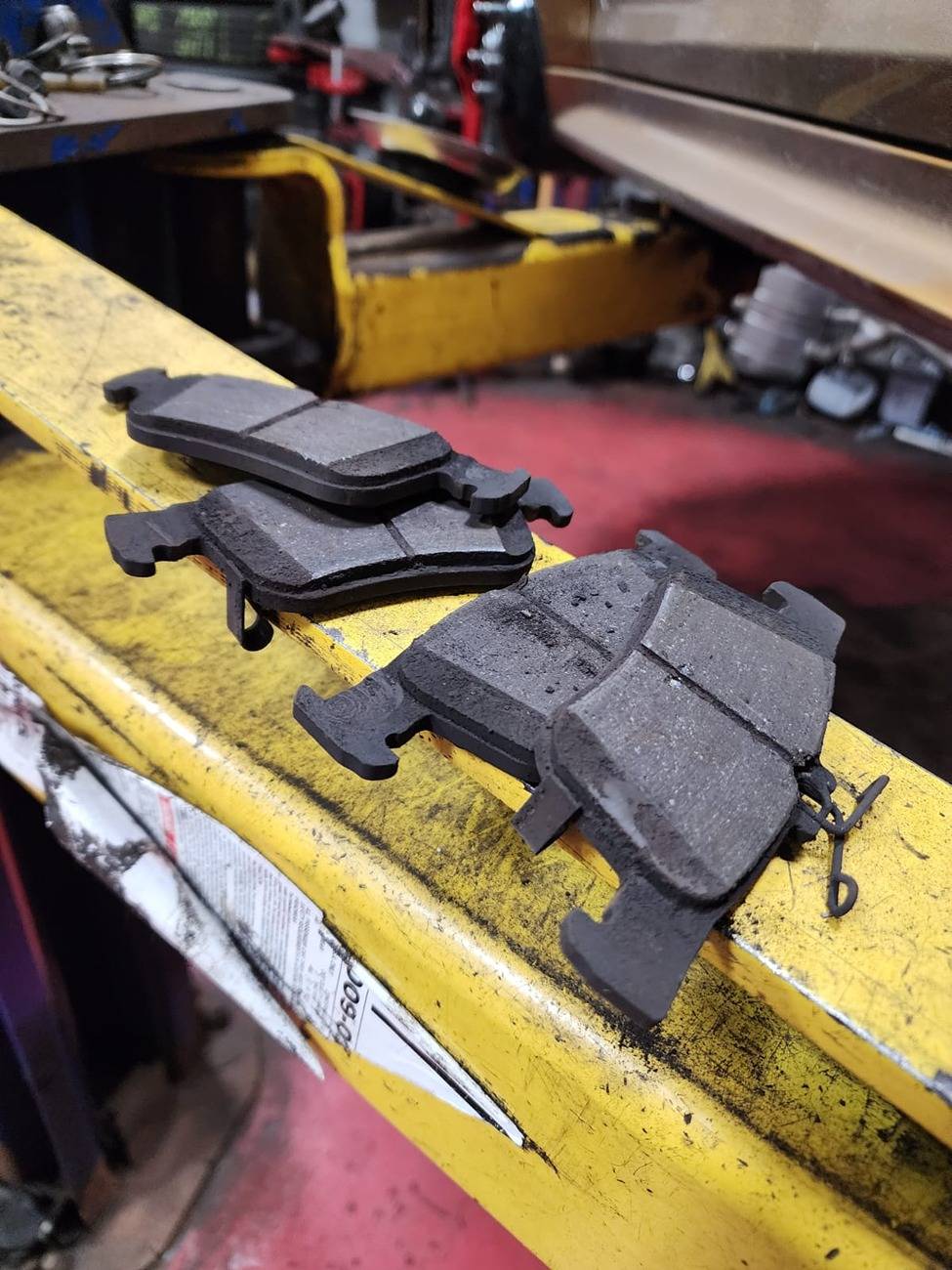

So what I’m reading is. I need to order the P3 pads “which” could last longer and be less dust then stock pads.
Already got the autel ap200 scanner coming, was on sale. Just put apex wheels today and the excitement got over shadowed when I looked at the rear pads….
Acura Integra ITS DE5 Warped Rear Brakes 10K Miles IMG_5083
