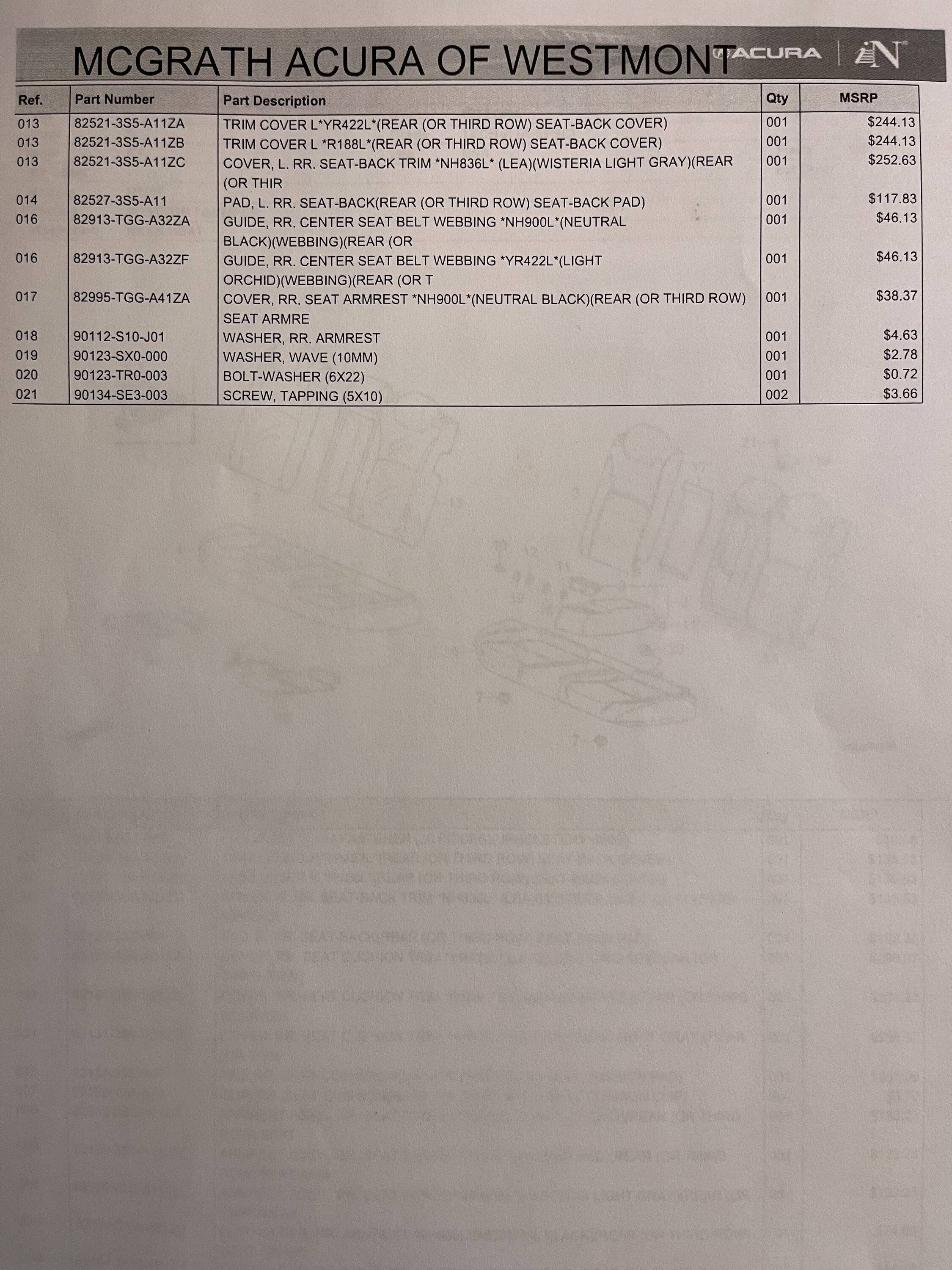

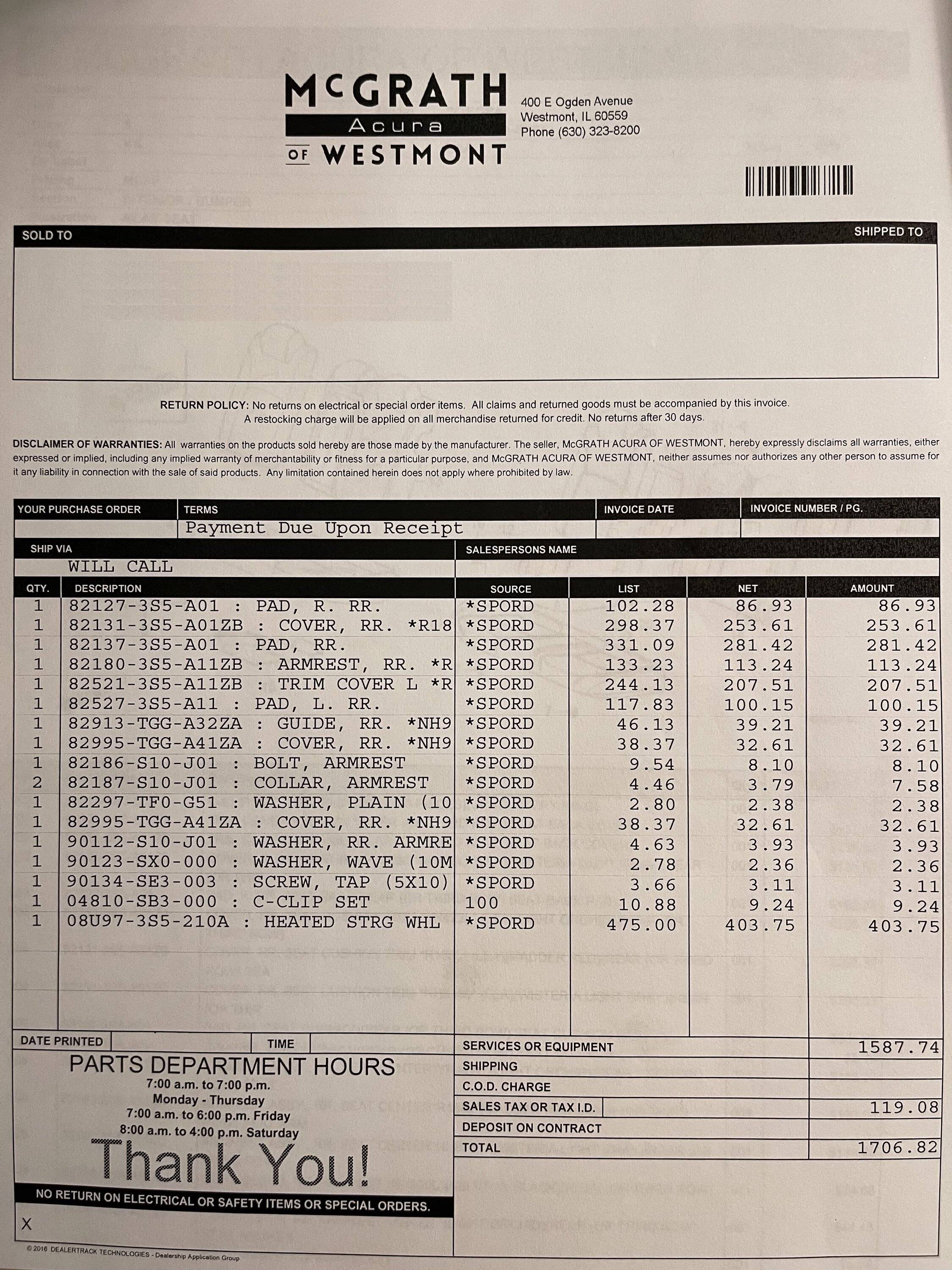

The folks at McGrath Acura were very helpful in getting all the necessary A-Spec rear seat parts, as shown in the pictures. The "List" column on the invoice is the original price, and the "Net" column is the price after a discount I received (please note that the last row is for the heated steering wheel I also ordered):
Acura Integra Rear seat swap between A-Spec and Type-S? A-Spec Rear Seat Swap Invoic

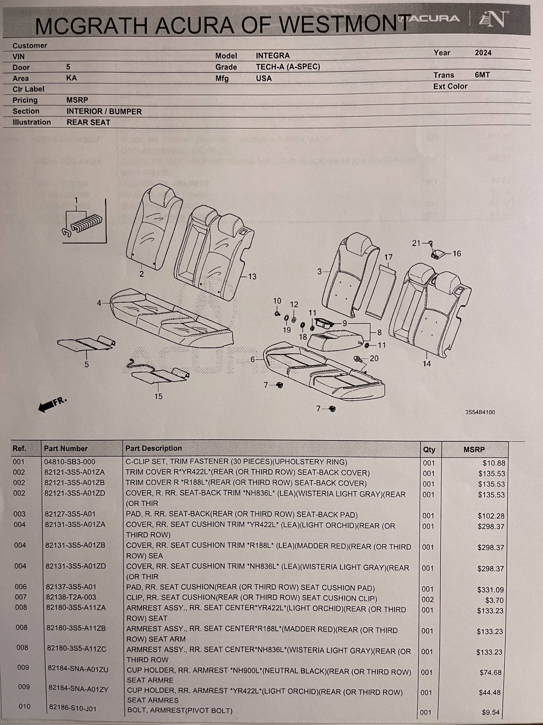

Here is another document I received detailing all the parts:
Acura Integra Rear seat swap between A-Spec and Type-S? A-Spec Rear Seat Parts List 1
Acura Integra Rear seat swap between A-Spec and Type-S? A-Spec Rear Seat Parts List 2
The labor ended up being an additional $1,100 to assemble the parts and install them, so this swap ended up being around $2,400 at the end of the day ($1,300 parts, $1,100 labor).

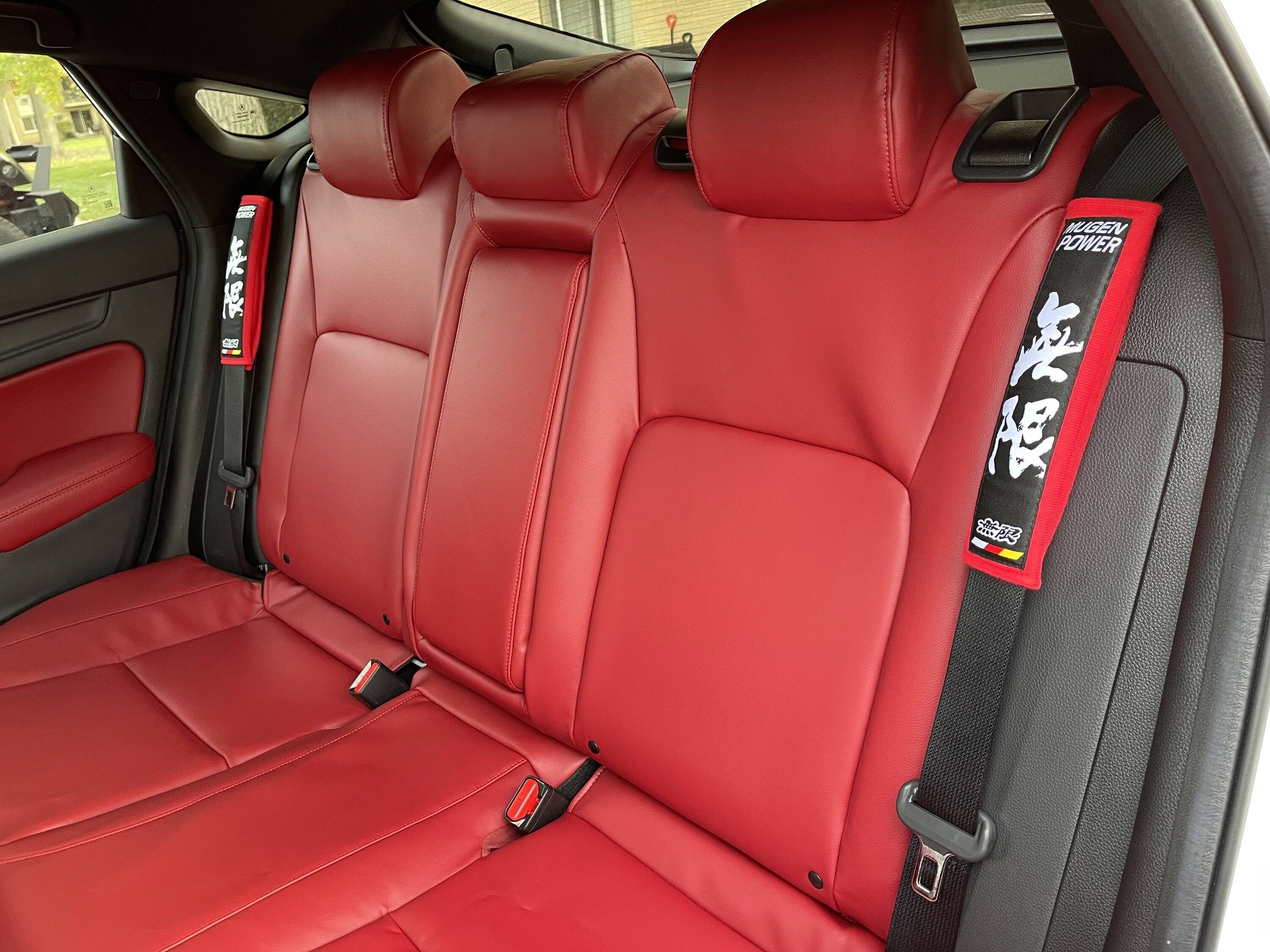

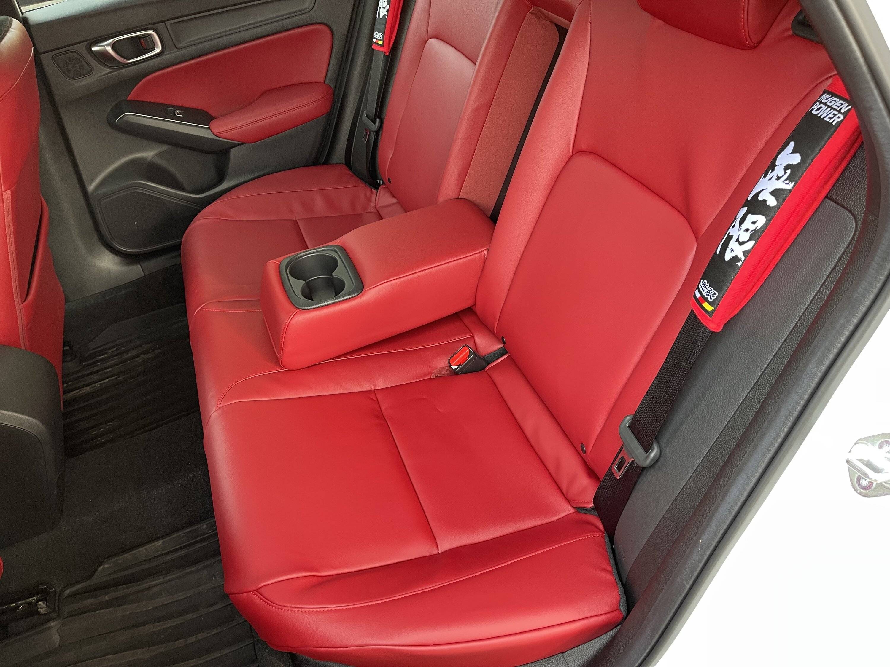

Here is the final result:

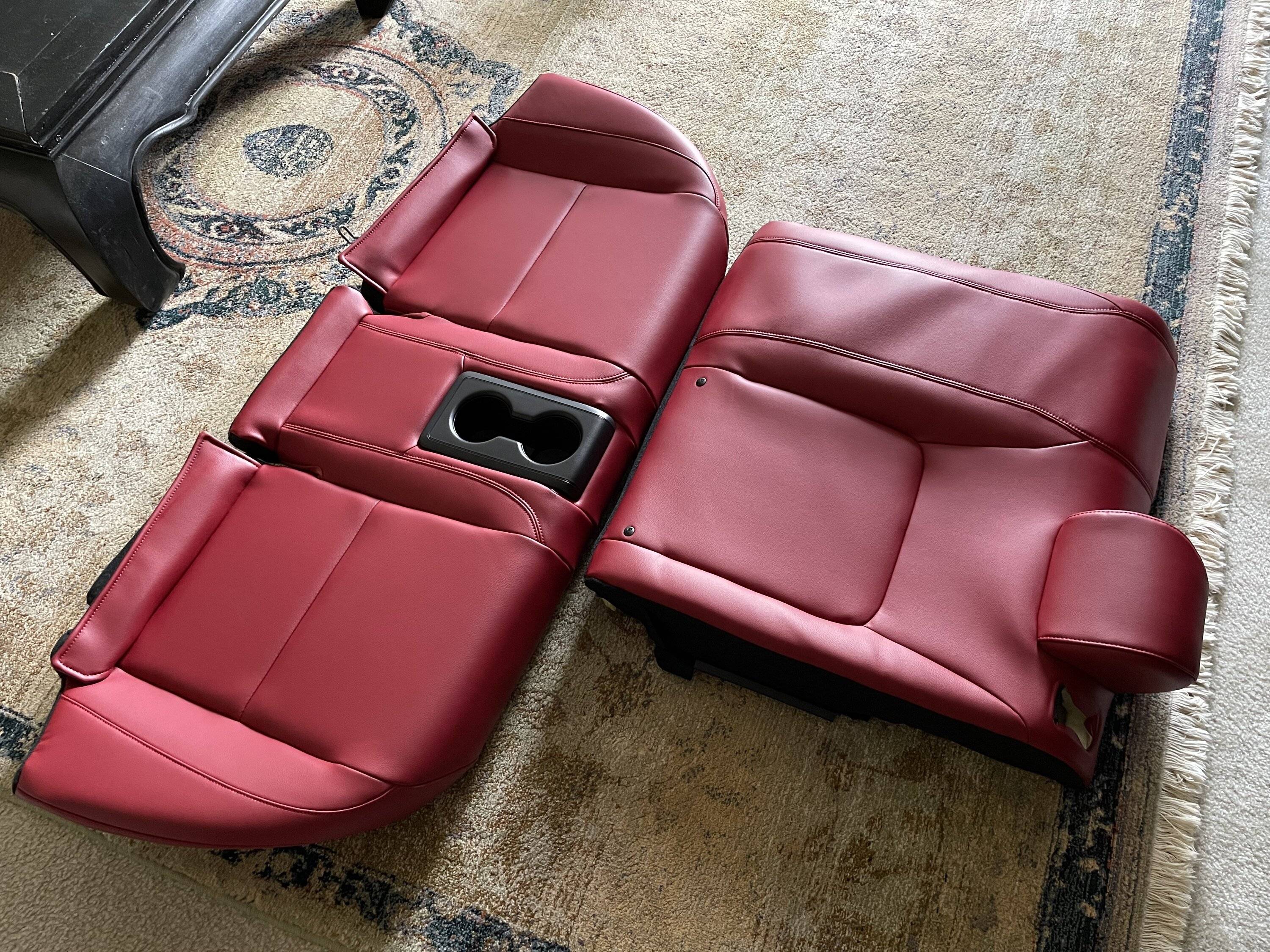

Here are the parts that came off, which I kept:
Acura Integra Rear seat swap between A-Spec and Type-S? Stock Type S Rear Seat
