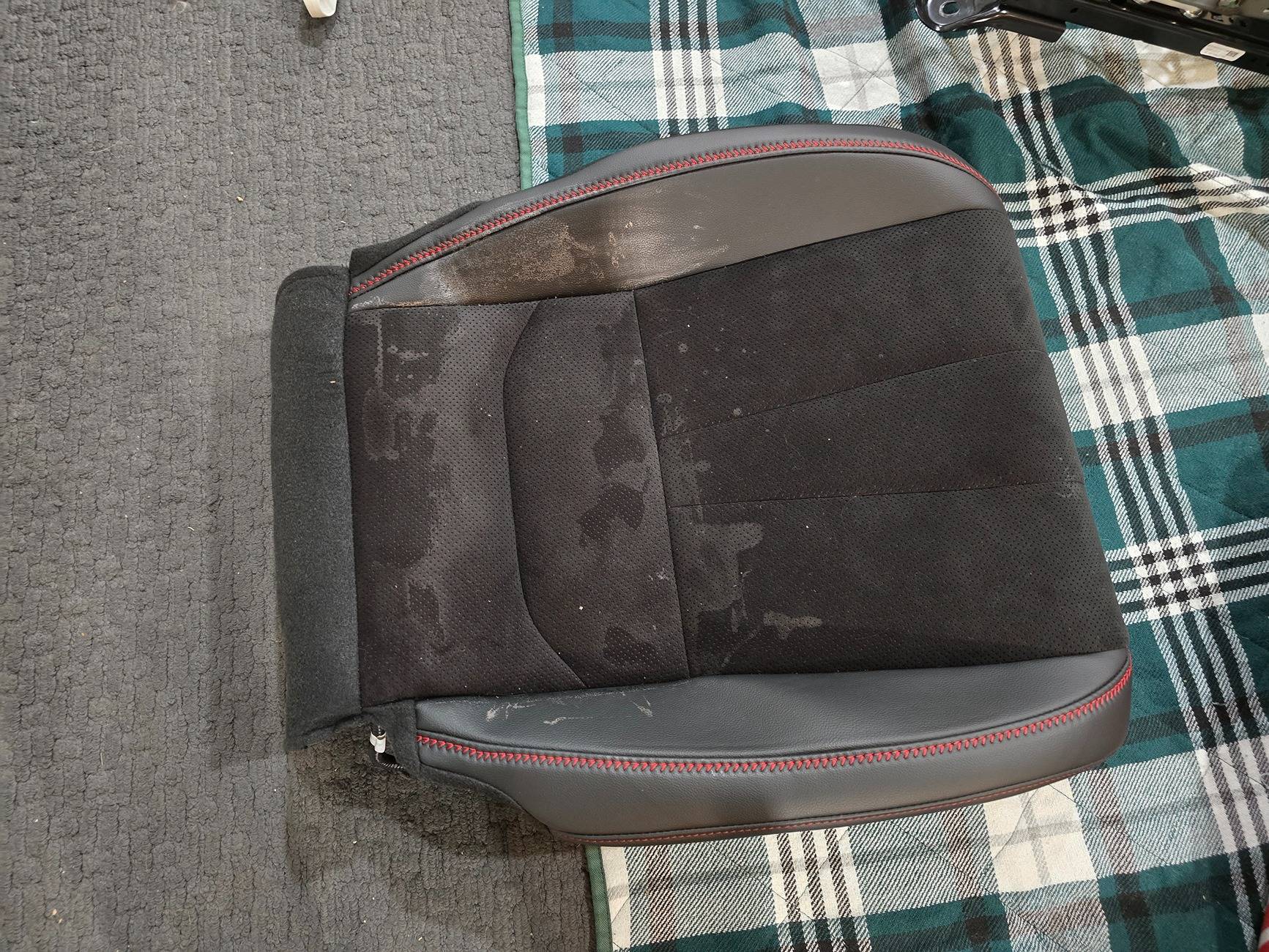

LOL. I goofed big time yesterday and spilled an entire chocolate protein shake in my passenger seat in traffic.

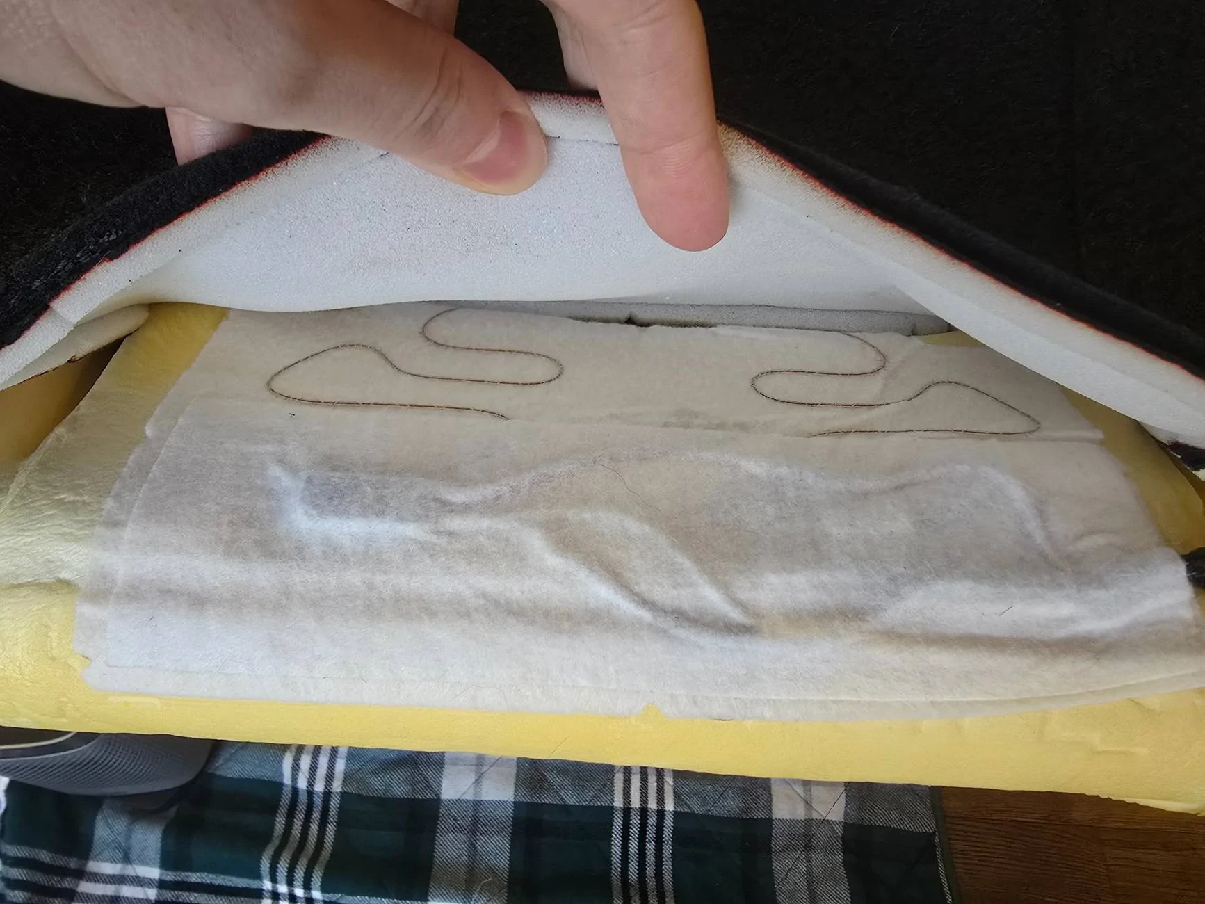

I took the seat apart in order to get into every nook and cranny and ensure the cushion wasn't soaked with it. This got me a pretty good view of the heating element. I can take a photo and share later of what it looks like and you'll see what I mean.
For now, here's a photo of my goof up,
Acura Integra Seat warmer weak 20250228_215904
As I cleaned this up, I grabbed a photos of the lower heating element assembly. You can see where the wires are and how thin they are.
Acura Integra Seat warmer weak 20250301_155005
