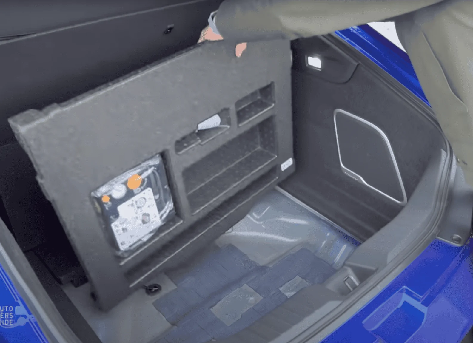

The Alex on Autos review gave a brief look under the trunk tray and it appears that that there is no threaded receiver to ratchet down the spare tire while it's in the trunk.

That would certainly hinder things! I’ll check my car at the next break and update…spare tire kit may be going back if so!

It would be cool if someone who can test drive one (or see one in the showroom), just have a look and picture of the trunk under the tray and under the inflator kit.
I would be deceived if Acura didn't put anything under there to secure a spare. Especially as the spare kit would be another accessory sold by dealers!

I have a type s and just checked. There is no threaded receiver and the area is raised to not even fit a spare. Spare tire kit is going back. You would lose storage space and the floor would be uneven.

Huge bummer on the lack of a threaded piece to hold down a spare. I wonder why that wasn’t conserved from the FL5 (ignoring that the trunk mat still wouldn’t sit flush).
