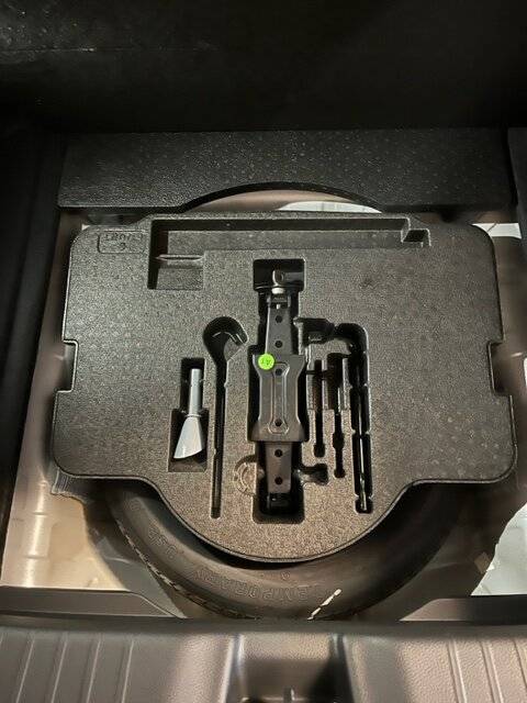

Hi everyone. I have mounted the spare and the tire changing kit from my 2019 Accord under the hatch tray. Fits perfectly, all tools work as designed. there is a very slight flex to the tray, but as long as you're not putting huge weight back there it should hold up fine. Tire seems to be right size too. If you're looking for other options.
Great news. Now I can see if the salvage yards have the jack!

135/80/R17 is the spare from the accord. saw that listed on this site somewhere as ok I think. bolt pattern is the same. fits perfectly with the top kit spun around backwards

So, thanks to all the info the community has supplied, I am working on an inexpensive solution to the spare issue. It turns out, there are many cars that have the correct bolt pattern for the spare. I only have left to figure which ones have the correct bore,,,,
What car is that tray from?
Thanks for the pic! Does the carpet lay flat with the tool kit top?
