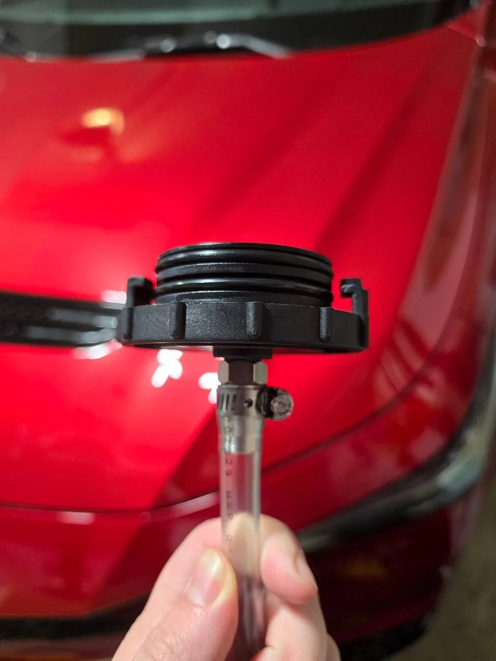

Speaking of all this brakes any buddy have a home brake bleeding vacuum kit they recommend. All this stuff makes me think it’s time to swap fluid maybe to motul 660 fluid to go at the paragon P3 pad pads.

Skip the 660. It's way too sensitive to water. Just bleeding it on a humid day can dramatically affect its performance. Even in my racecar I run the rbf600 and it's solid. I run the 600 in the its and it's great, but like all higher boiling point fluids, it needs a minimum yearly flush. Ime with 660, it needs bleeding every 3 months to stay stable.

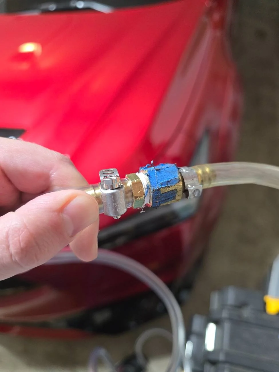

I use the motive bleeder and a universal cap that fits the acura mc which I got off Amazon. I don't fill the motive with fluid because it's both wasteful and has led to worn gaskets in the unit. Instead, I use a metal syringe (can get one from target) to draw the fluid out of the mc, and use the motive to only create pressure on the mc. Works well.
Don't forget the clutch shares the mc with the brakes, so the last step is to bleed the clutch. It does not like pressure, so bleed it the manual way.

It doesn't really matter which motive. I have the black label euro one since I wanted the aluminum spin on head for my German cars, but I also bought the Nissan style spin on later that's plastic and it works fine.
This is the adapter I got for the acura: https://www.amazon.com/gp/aw/d/B01MYXAXS5?psc=1&ref=ppx_pop_mob_b_asin_title
Definitely rub some fluid on the o rings before trying it on, because it's a tight squeeze otherwise and if it's not totally on, it can pop off when you double atmosphere.

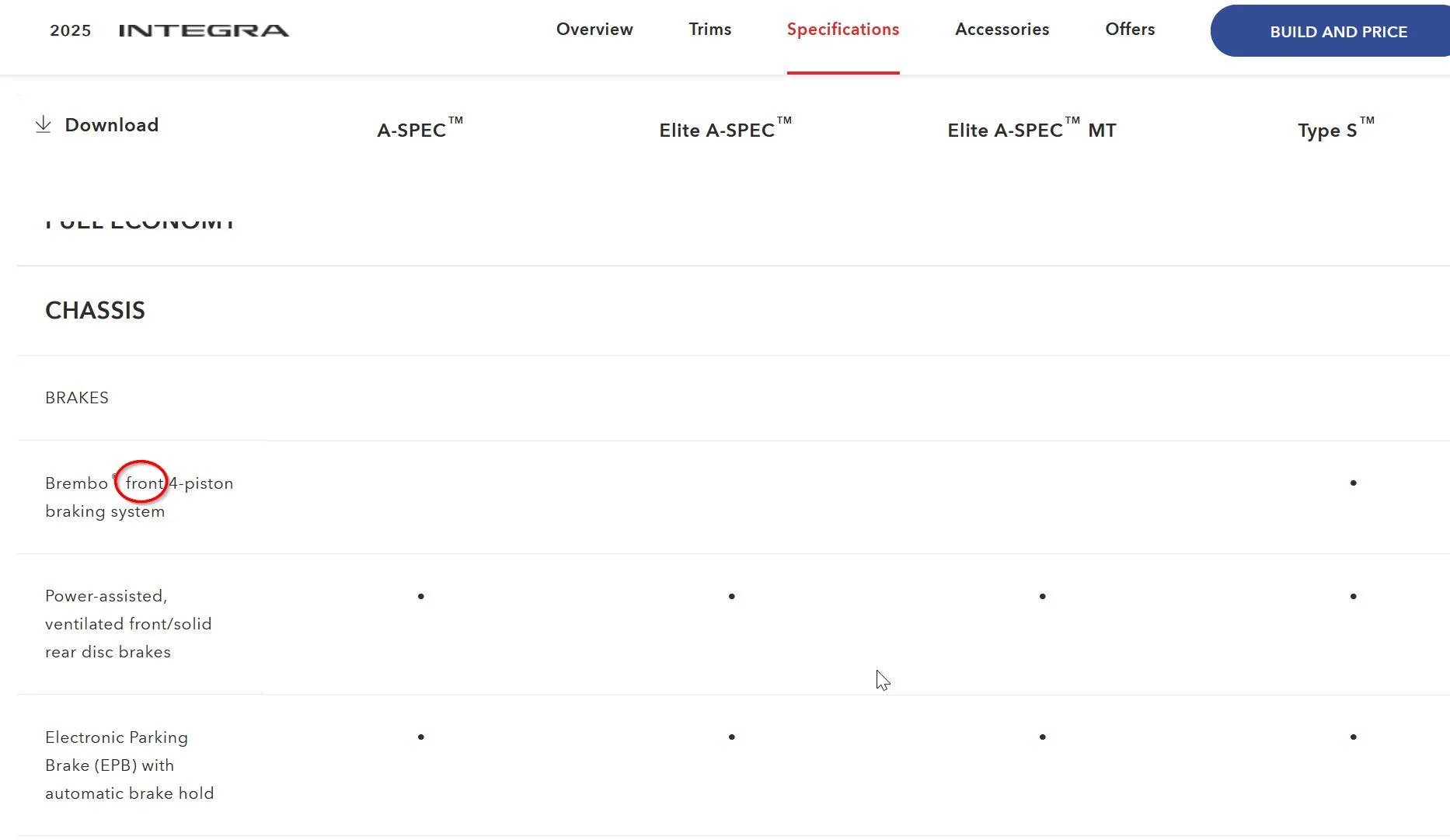

At least calipers are not Brembos (otherwise they would probably say so on the spec page). Maybe pads are...
Only the fronts have brembo calipers. The rears are likely the same as the aspec and lower trims. I don’t think they need to be, the car stops very well. What Honda/acura doesn’t advertise is that the cars induce inside wheel braking on the rears to help with turns. Took me a while to figure this out as I always felt like the car behaves almost rwd. This also causes the rears to wear quicker if you enjoy spirited driving.

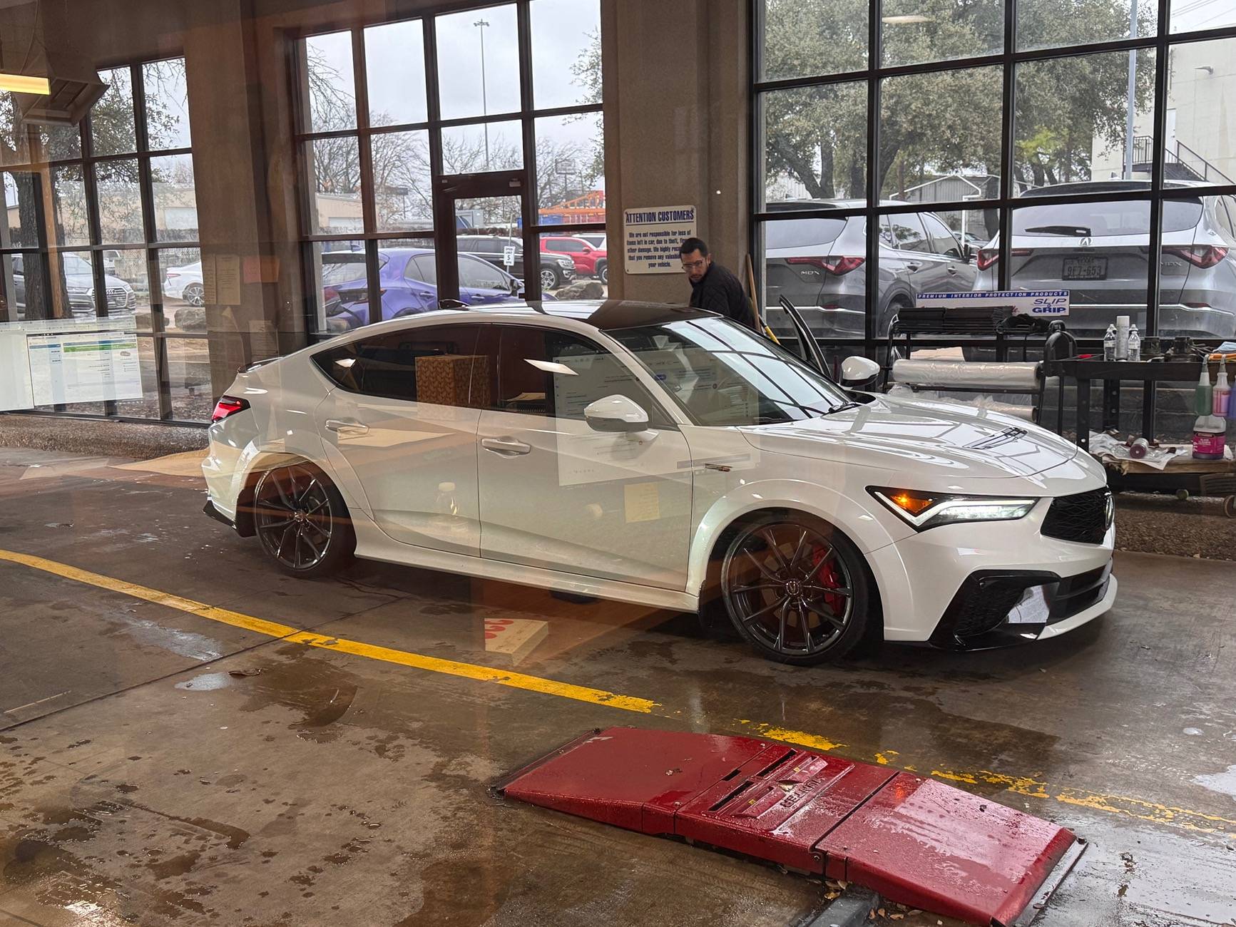

Well, I put the stock wheels on to go in for the service recall and sure enough the noise is now gone. ? Now I’m really confused…
1,554
1,075
Were your wheels torqued correctly before?
Could the rotor have been pressed at a slight angle with the wheel, leading to a wobble and noise?
What did the brakes look like when you swapped wheels? What was the tire wear like?
Krazydan19
Krazydan19
Jun 29, 2023
435
373
Austin, tx
Torched corrrect and checked them too. Wheels looked perfect nothing rubbing pads looked lower in rear but not gone. I ended up changing my appointment when I got there after he told me it would be 6 hours rather the 2 hours I was told. Will know in couple weeks if they find something. I don’t know. They had 3 type s on the lot. All on black interior

mine had this issue, likely it was from the floating disk. Took the wheel off, properly clean the contact surface and the noise is now gone, try that first maybe
