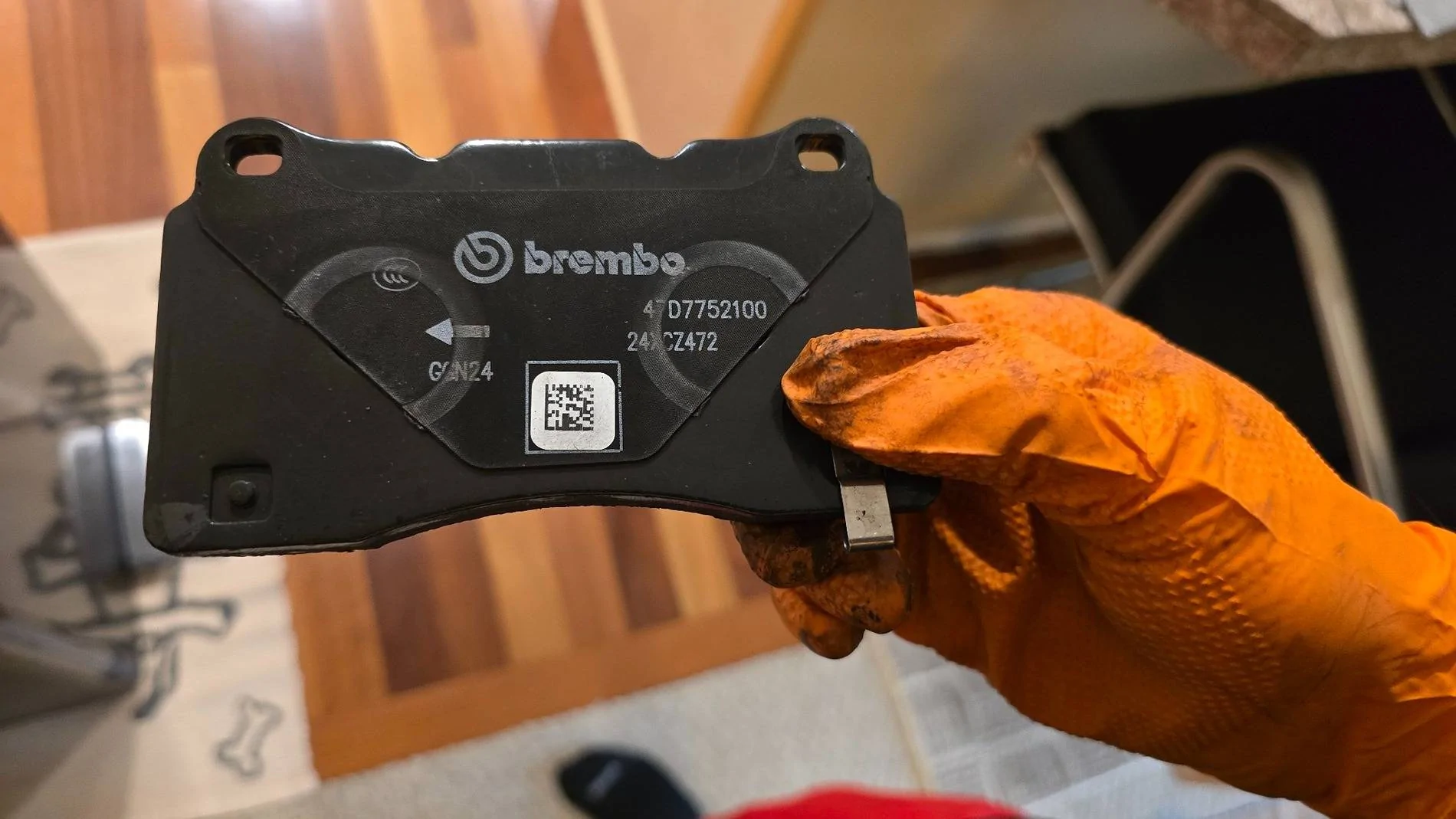

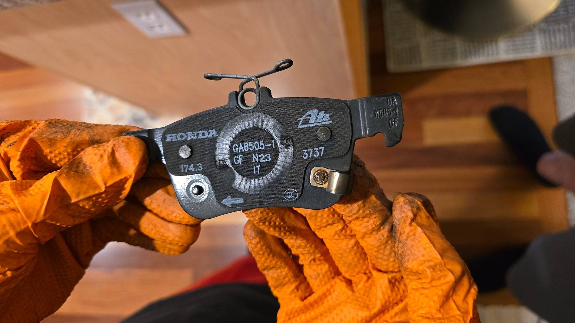

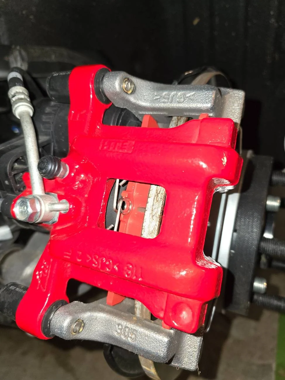

I can help out here a bit, the rear calipers are Ate, as are the rear pads. The fronts are Brembo pad and caliper obviously. I replaced them with Paragon P2s front and rear but will be trying some Endless SSM+ soon.
Stock front Brembo pad:

Honda/Ate rear pad:

My caliper which is very similar just a slightly different part number:
Honda/Ate rear pad:

Not uncommon for the oem to vary. Ate makes a pretty good caliper, and decent street pads.

Just on looks alone you can tell the rears are not Brembos. They would never put their name on such wimpy looking calipers. Actually, calipers may be an overstatement, they are more like clothespins.
I doubt the rears need to do much (besides vectoring, which apparently causes a shitload of pad wear) but I am surprised Acura didn't make an effort to at least make them look serious.
Brembo does make floating calipers. You can go to autozone and buy basic B silver floating calipers stamped with brembo on them for certain applications.
Keep in mind on most platforms the rear only does 20% of the braking, and on fwd platforms it can be as little as 10% due to the weight being up front.
Looking wimpy and being wimpy are two different things. There is nothing wrong with this caliper, and I would take it over a fixed rear setup because you can have the epb. If it was fixed, you'd need to either have a drum on the inside of the hub, adding weight, or you'd have to have a complex dual solenoid setup applying pressure to the inside and outside piston. This adds even more weight and complexity, as well as reducing wheel clearance.
