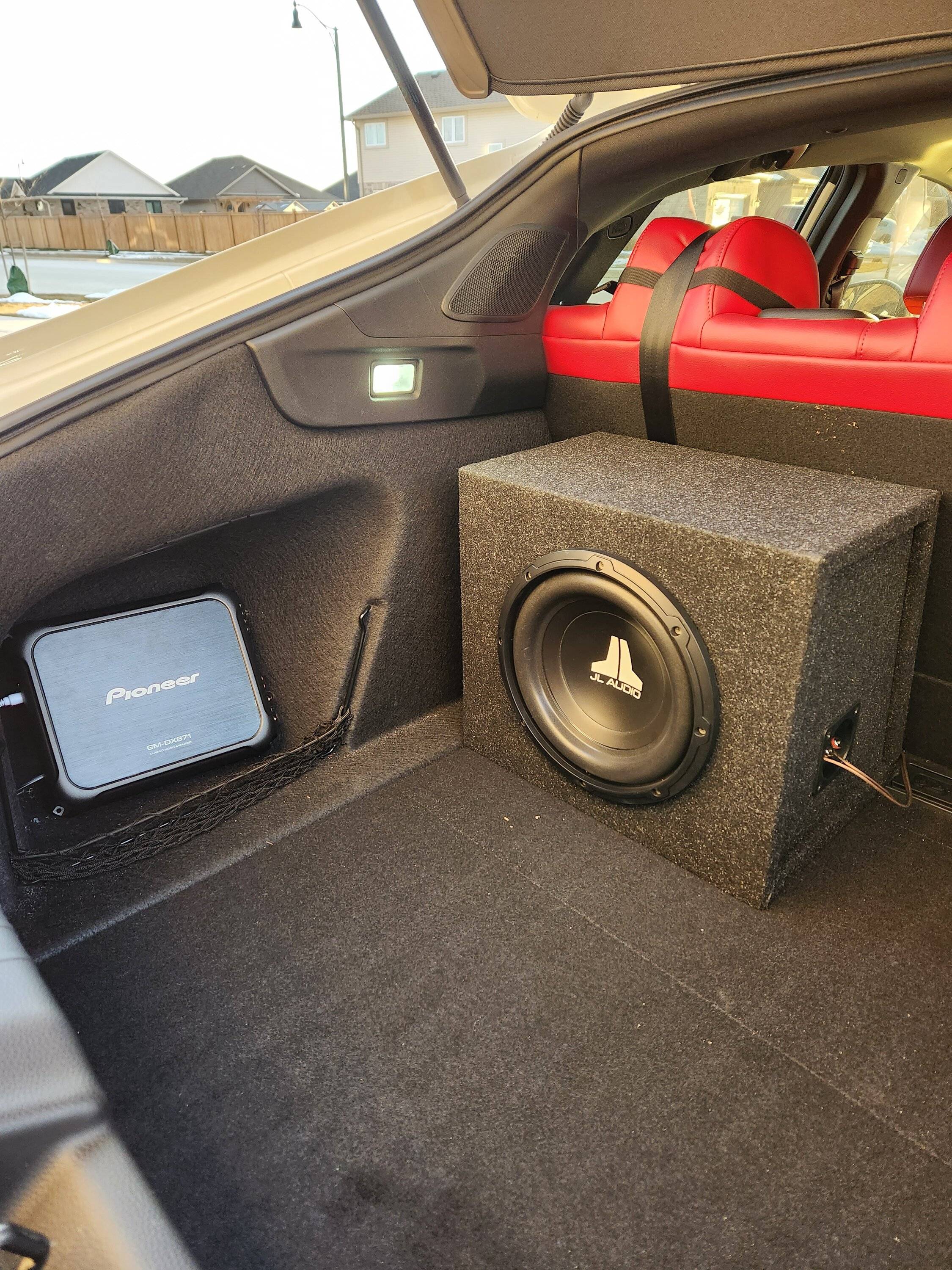

I don't even have a loc. I unplugged the factory sub and took that wire, extended it to the amp. I used a speaker wire to rca converter to go into the amp.

Ya it automatically detects if it's speaker level or not. I'm just using a 10" jl w0v3. Single voice coil 4ohm. so only 300watts from the amp. Figured I'd start with that and if I want more I can buy a 2nd one and run 2ohm and get 500rms out of it. But I'm happy with the output. I don't want the outside of the car to rattle toooo much.

I Installed a mono amp and JL sub. So for wiring. I cut the wire going to the factory sub. I used a speaker wire to rca adapter (see pic). RCAs plugged into amp for signal. My amp accepts speaker level input so no need for a loc. Also no need for a remote wire. The amp gets the on/off signal from the rca input. The rest of the amp install was standard.

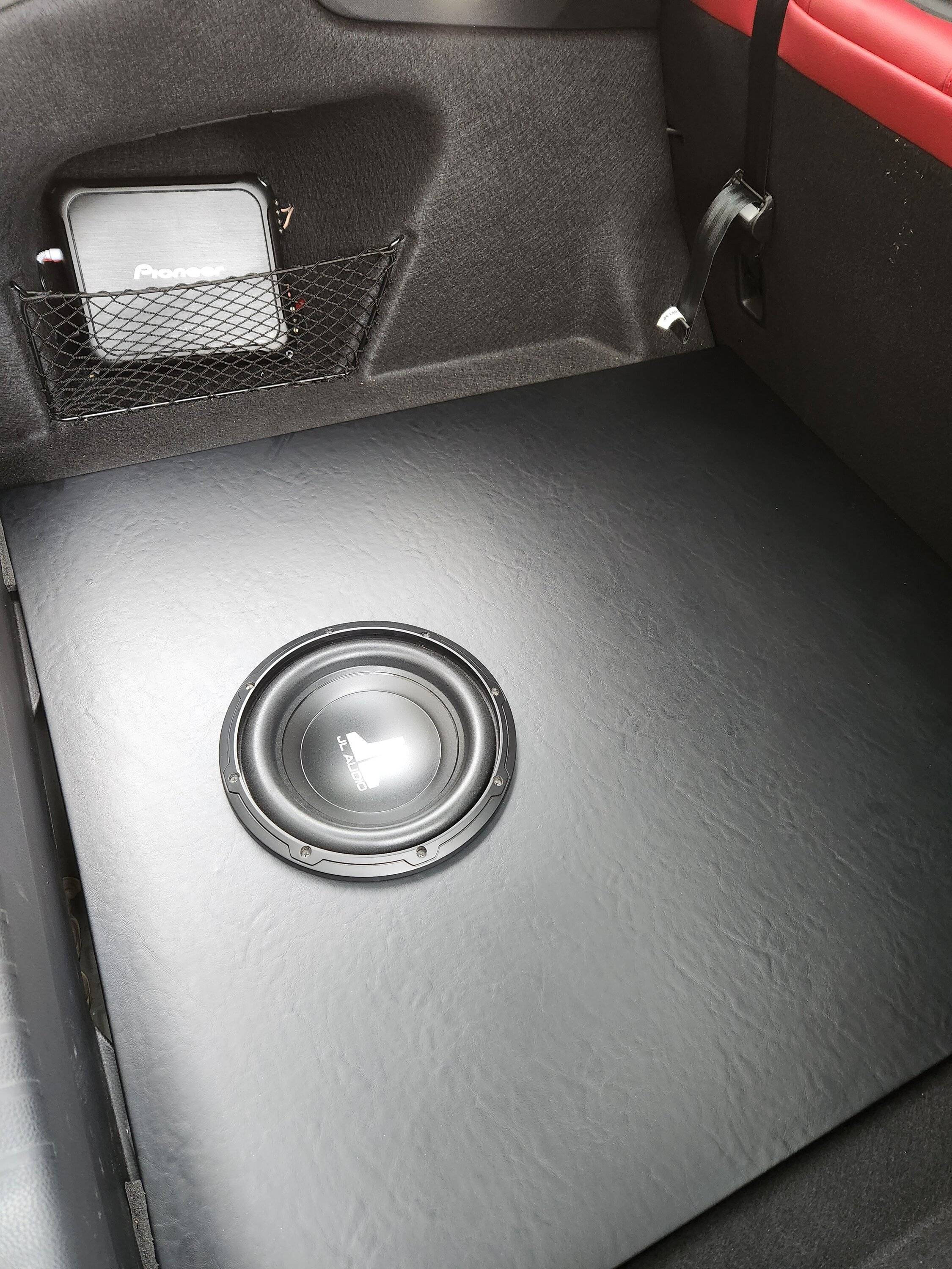

Nice. I was just thinking about a similar setup using the spare tire space.
Ya lots usable space there. I wasn't concerned with adding a spare tire so I made the space serve a good purpose. Just made a box to spec for the sub. Spray foamed the floor, carved it to get the perfect height. Then, dropped in the box. I used more foam on the outside of the box against the floor to secure it in place.
Fun little project
