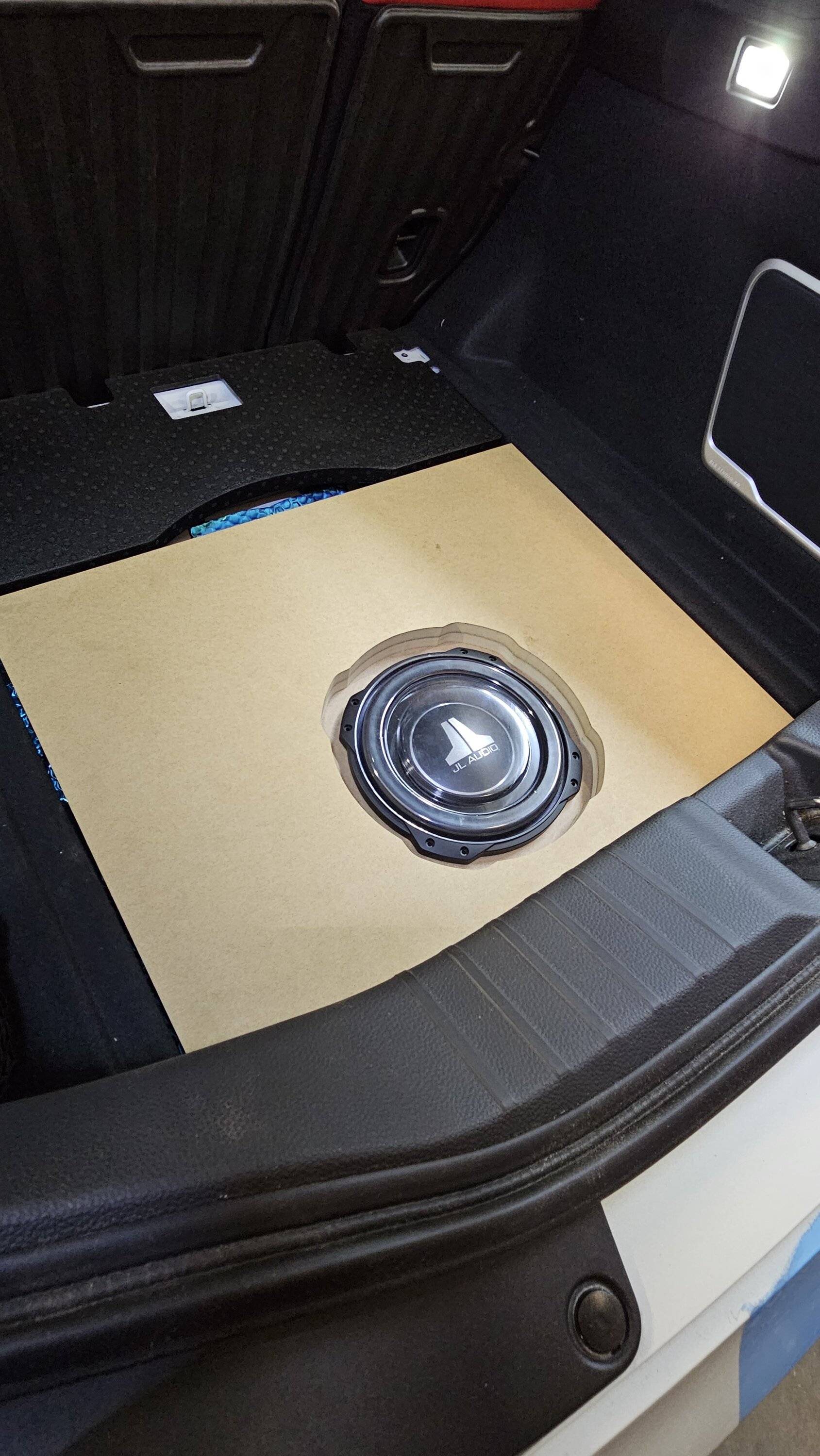

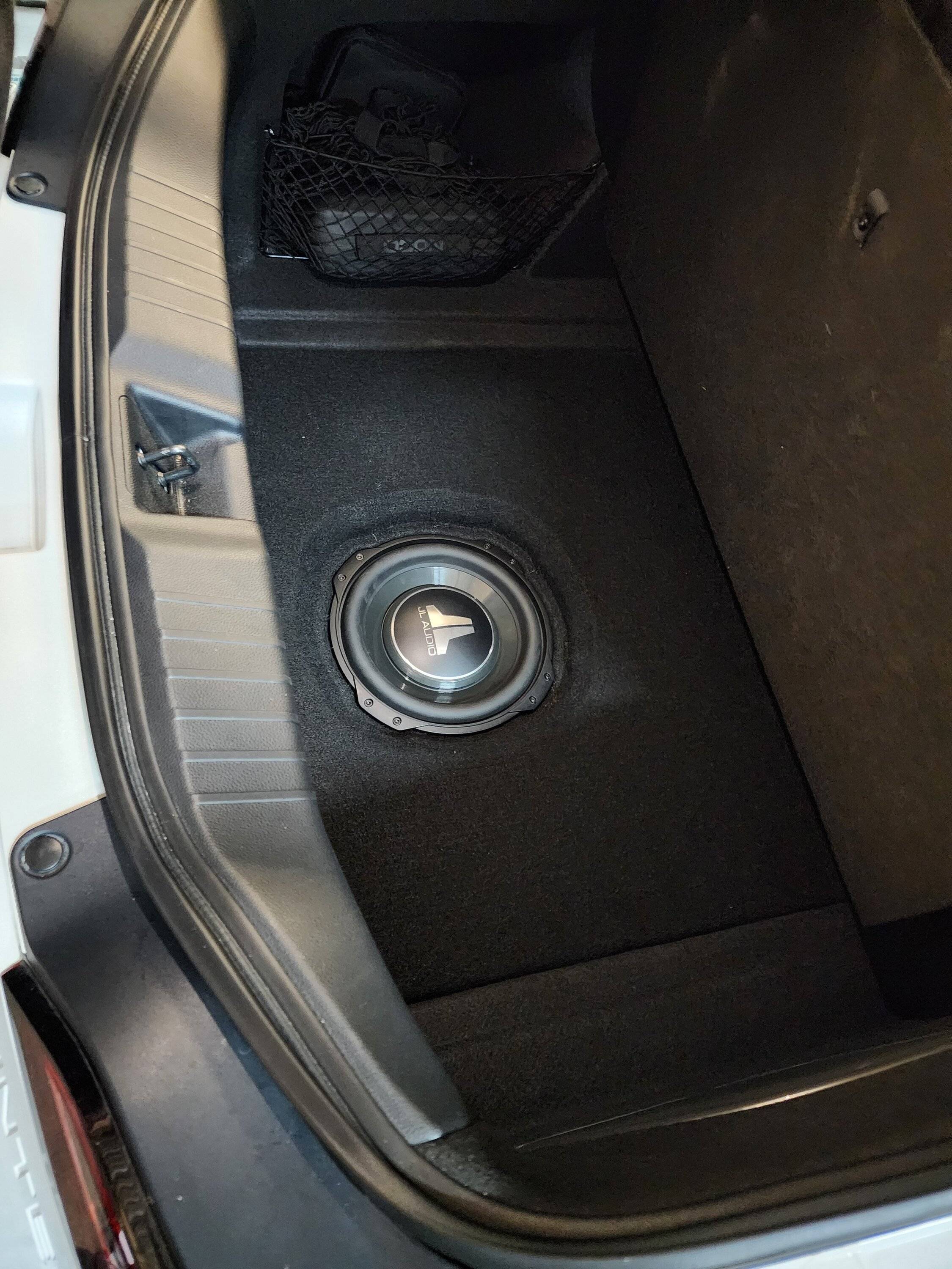

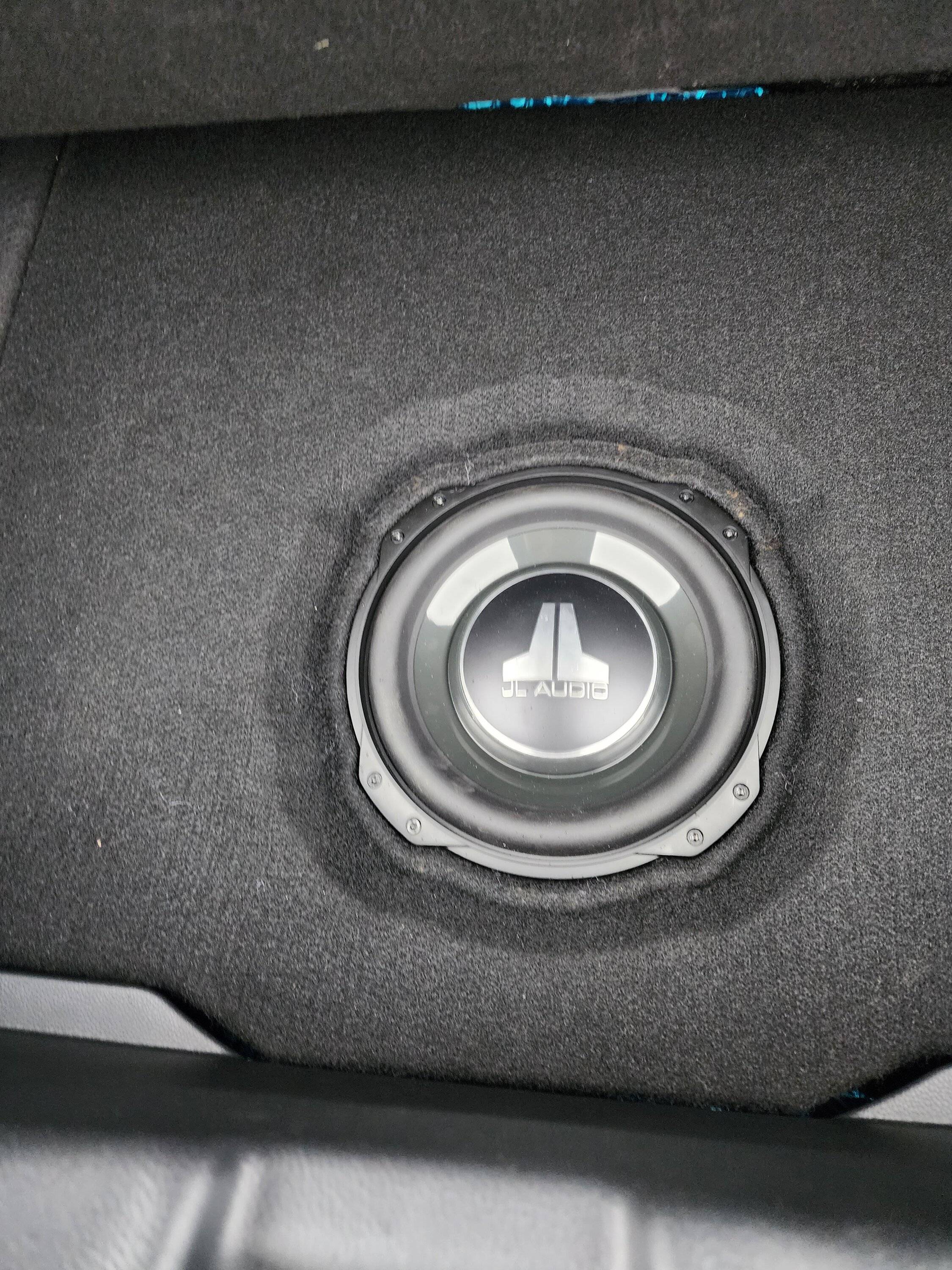

I love the use of the spare tire well. This gives me an idea of using one of those thin subs and integrating it with the floor but recessed to fit a grille and protect the sub since I do put a bunch of stuff in my trunk. I was thinking of just getting a downfiring box for a thin sub and securing it to the trunk floor but this would be a lot cleaner.

I was on the fence for awhile and then one day I smelled burning voice coil. I didn't blown anything but I was definitely trying too hard to get the bass out of it. I knew it was time for an upgrade! The only negative is some exterior rattles, mostly the 3rd brake light. I'm sure it could be addressed without much effort.

I don't have a picture. But, behind the battery and down a bit. There's a grommet you can get through. And it comes out near the break pedal.

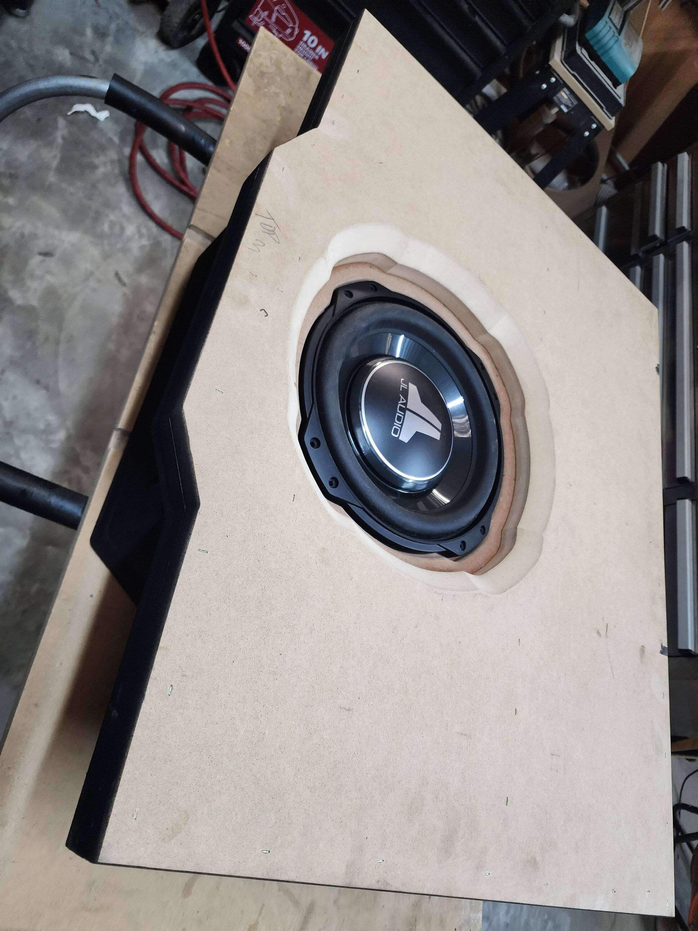

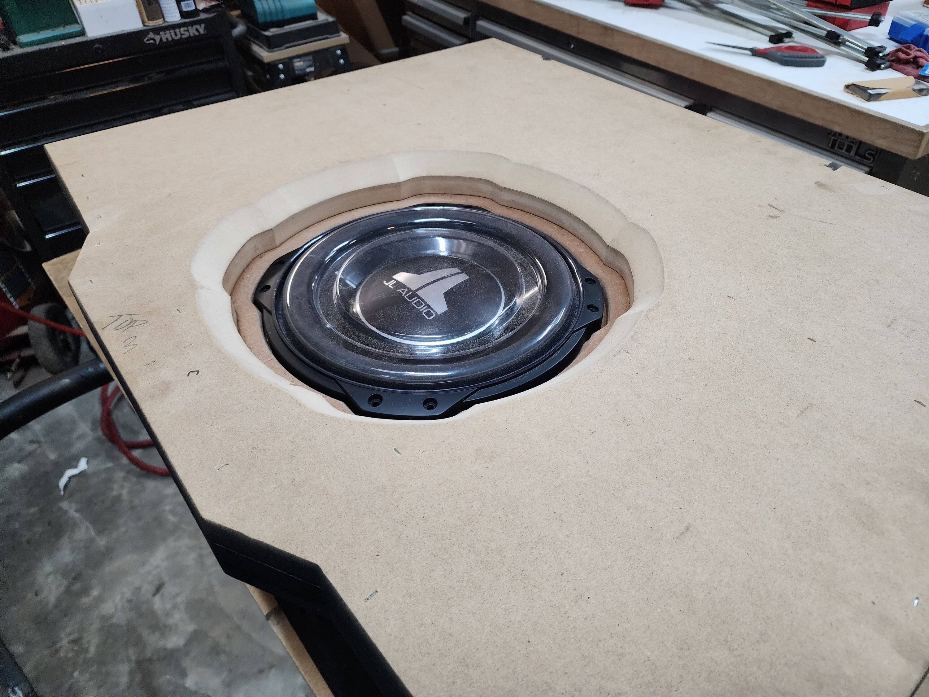

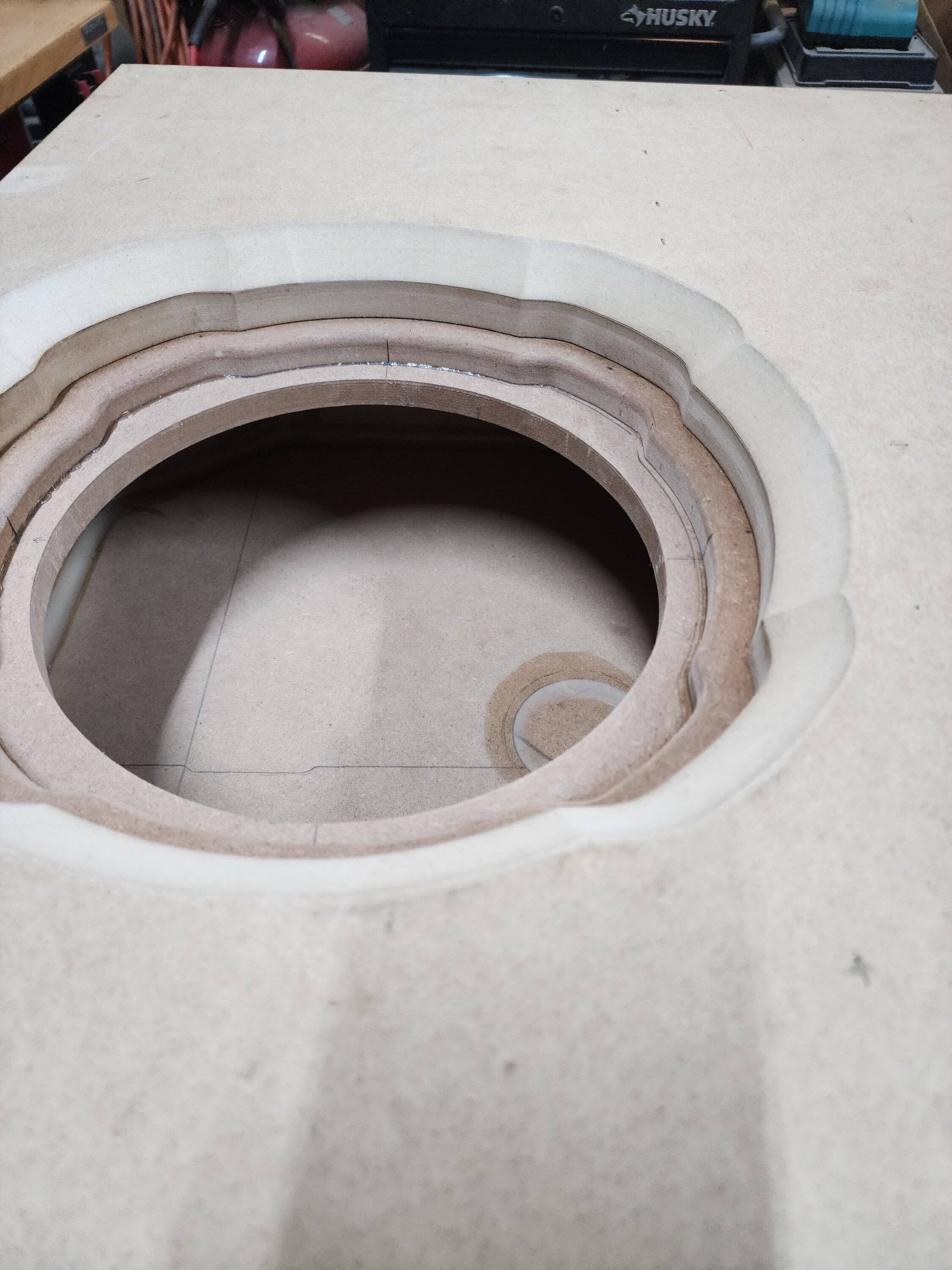

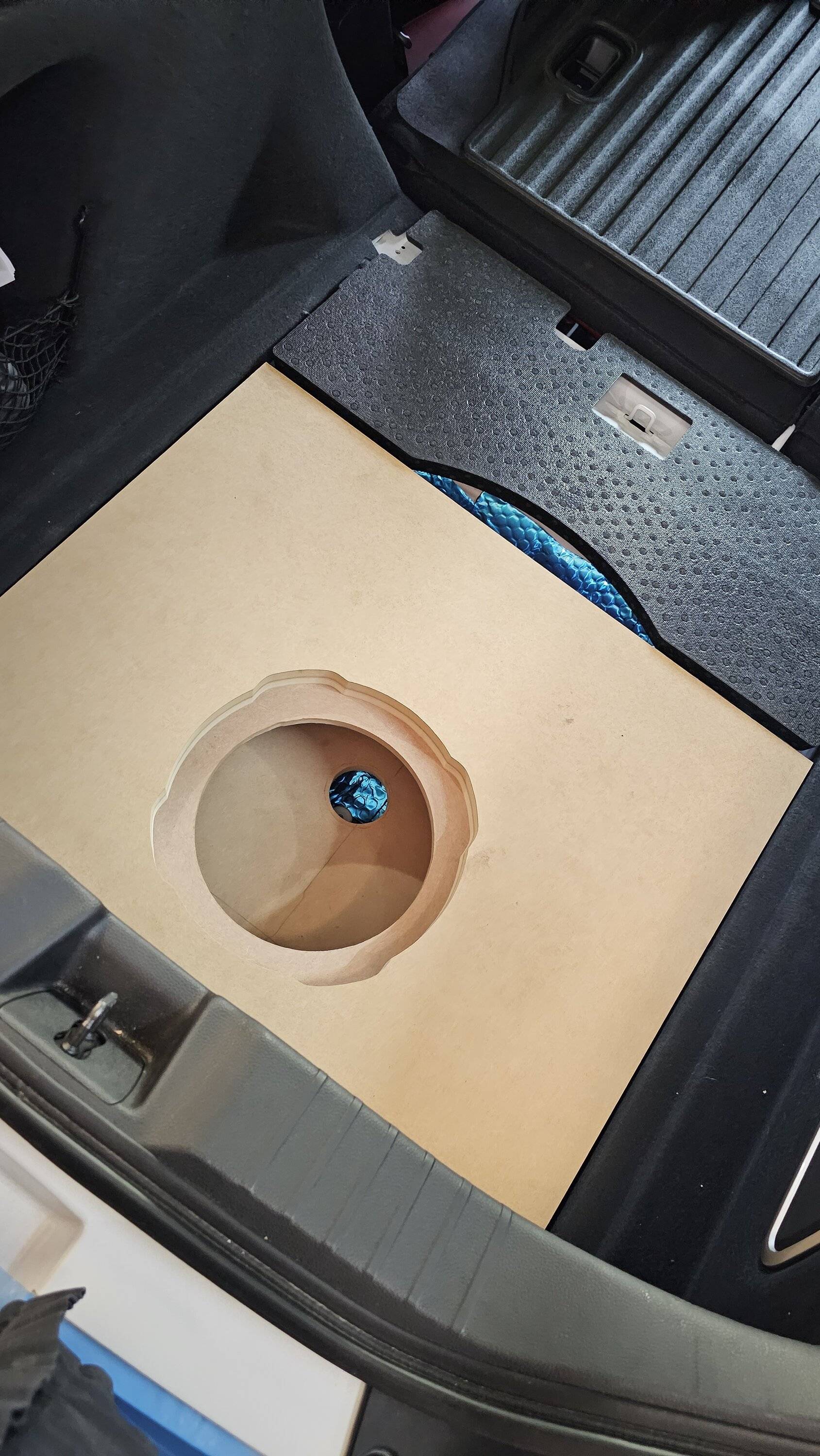

They laser scanned the foam insert to start for building the box.

Professional shop build the box and install. Amp under passengers seat.
Wow. What does something like that run? Since they have the scan could they sell on here?
Under $1000 for install, I provided sub, amp, and wires.
Box was $450 install $350, line out converter $100.. plus tax. Something like that.
Wow a decent price for work like that.

Nice. You could have a little stash spot behind the OE sub grille šŸ˜‰
