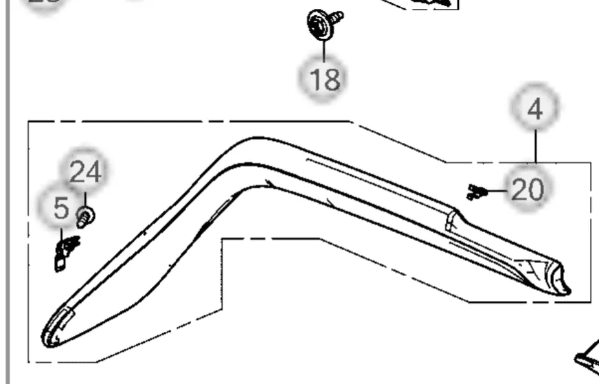

I found this in the parts manual.. looks like two clips hold it on

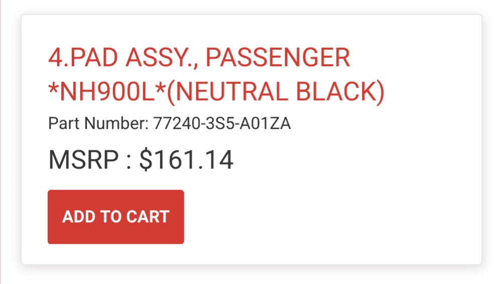

Oh or you can buy one 😢

Wasn't sure what the self tapping screw was doing, worried I would have to access it. But looks to just be holding the clip bracket in place? Already ordered this and the console cover mostly to appease my better half :) I got it for $115 though, think the console armrest was $75.

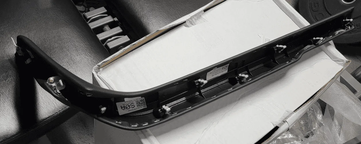

So to my surprise what arrived at my door today, but my black passenger pad! My orders were all cancelled, not sure how they got ahold of one. I just wanted to point out, while it appears it's only held on by 2 clips, that is very, very wrong... It's got a lot of clips.... Will have fun swapping them...

Photos? Thinking a pry tool should work?

Yeah, I think it should be ok, hoping most of the clips are removable with a little force once you get one edge off. Will see once I get the car.... Also if anyone is interested, I got a quote to reupholster the interior and it's way too expensive. Basically they were quoting around $300 per piece and they didn't think they could do the door panels, only the arm rests on them. So will see if I can get some Black Type-S door panels and center armrest at some point, as well as front headrests.
