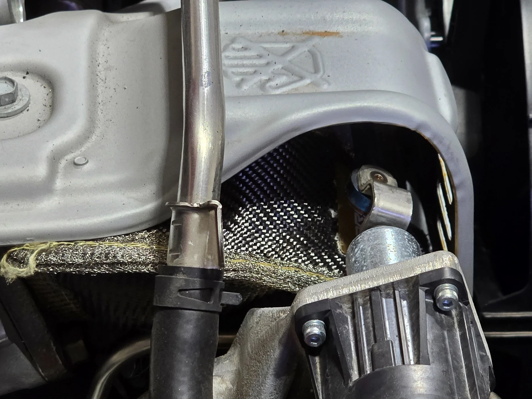

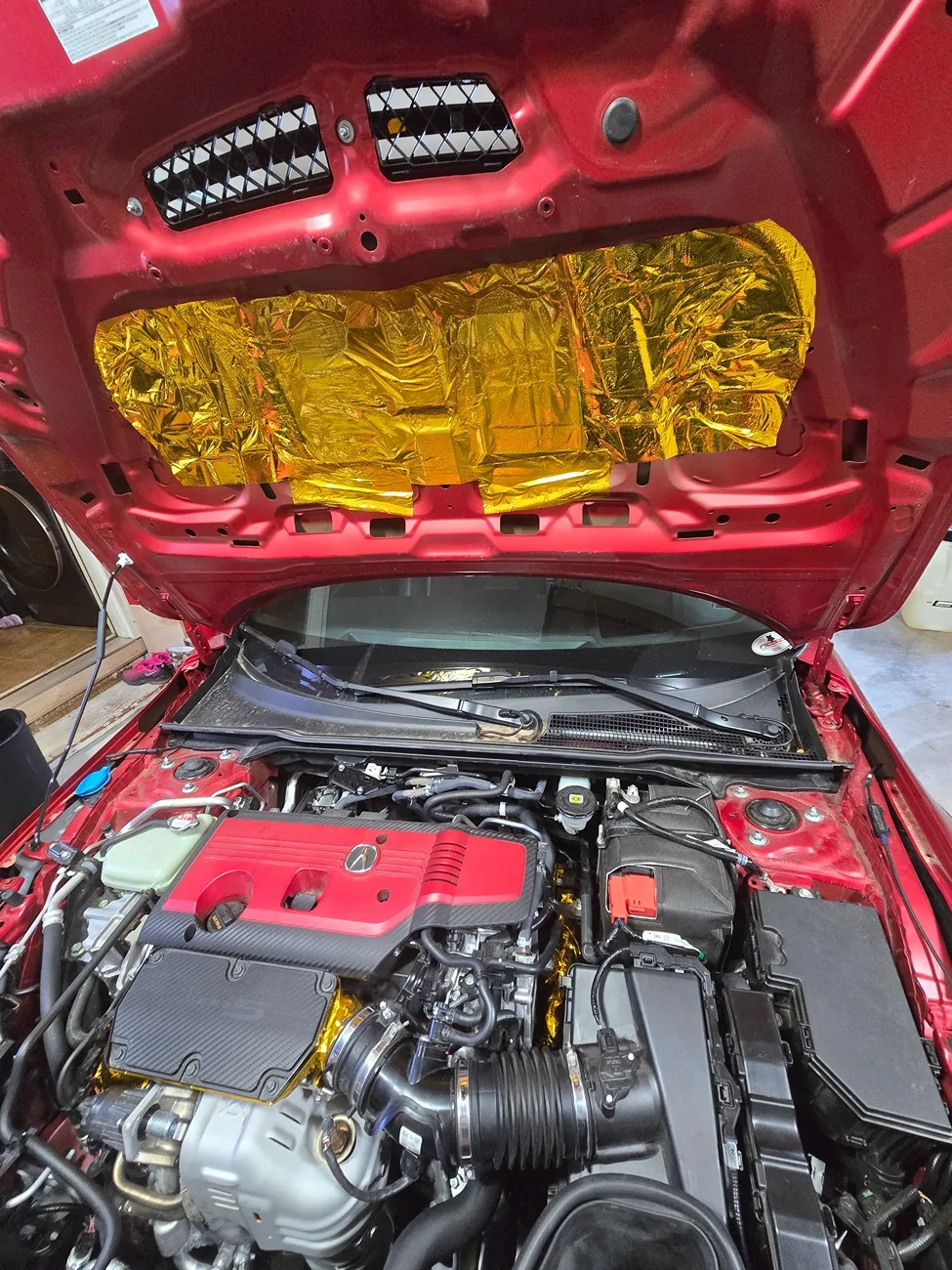

I replaced some gold foil on the intake and charge pipe today. I had some cheap stuff before and the heat was making it brittle and lose color so I went to the pricier stuff. I'll add on more in a few places later (bought about 300$ of the stuff and used about 170$ worth so far), but it's at a diminishing returns level. The hood addition is new with removing the engine insulator. This will help pull more heat and keep the hood from cooking. On track the foil helps keep iat down quite a bit. The turbo blanket also helps a ton. My iat stay within 20F of ambient on track when about 75F out.

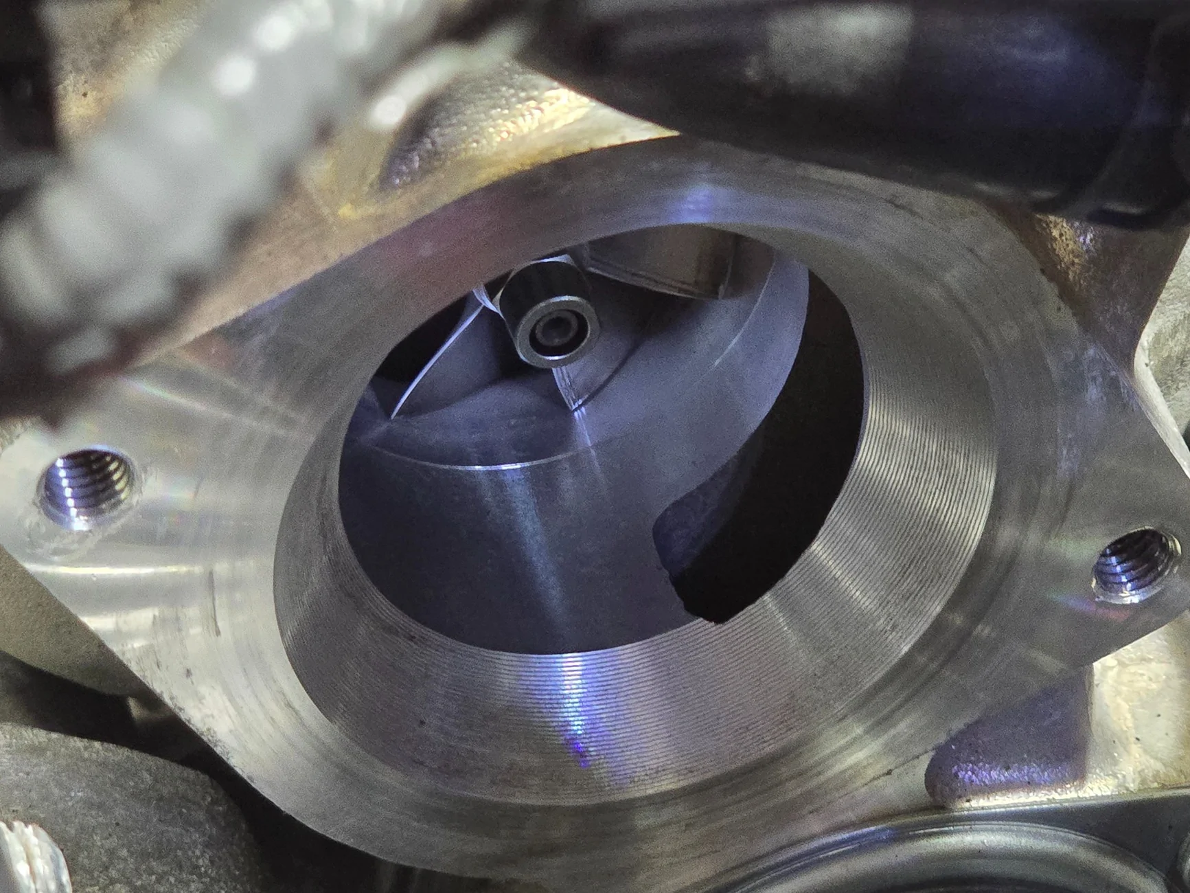

Also shot of the turbo below. For anyone wondering whether the stock intake is a flow restriction, I refer you to the surface area of the turbo inlet. At about 45mm stepped down from 56mm, I don't see any reason the factory intake would restrict anything for this turbo.

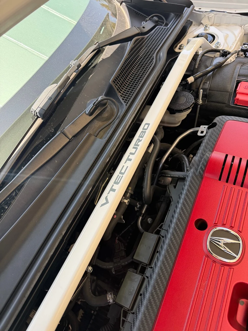

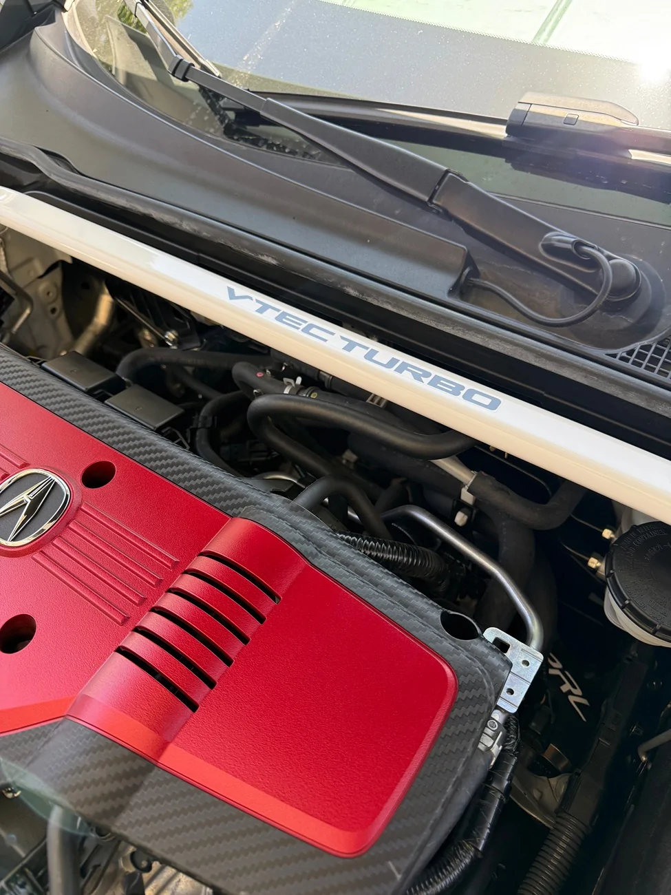

Removed Ultra Racing badge and added FK8 factory β€œVTEC Turbo” emblem/decal.

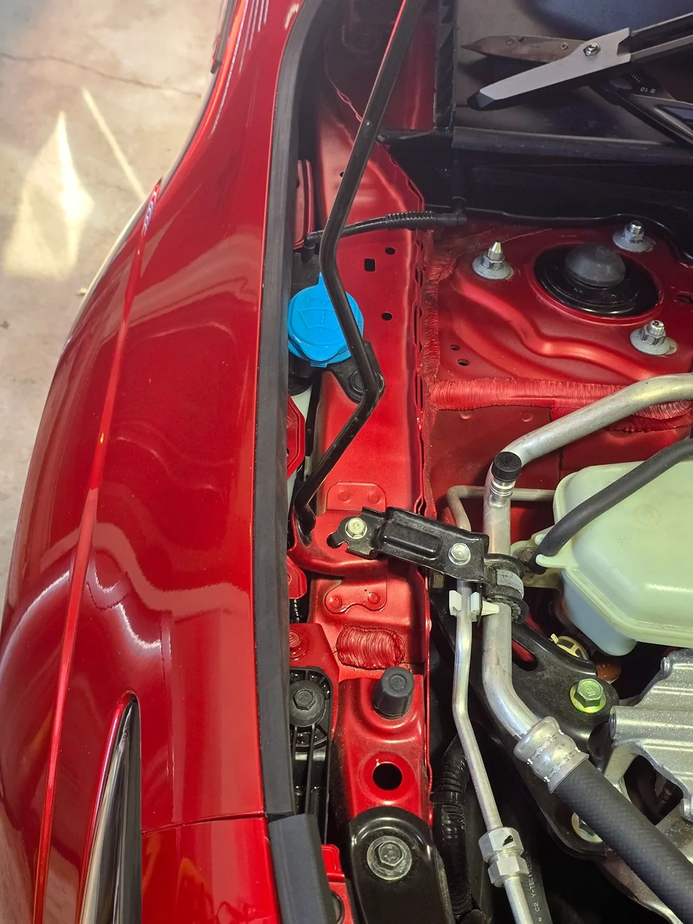

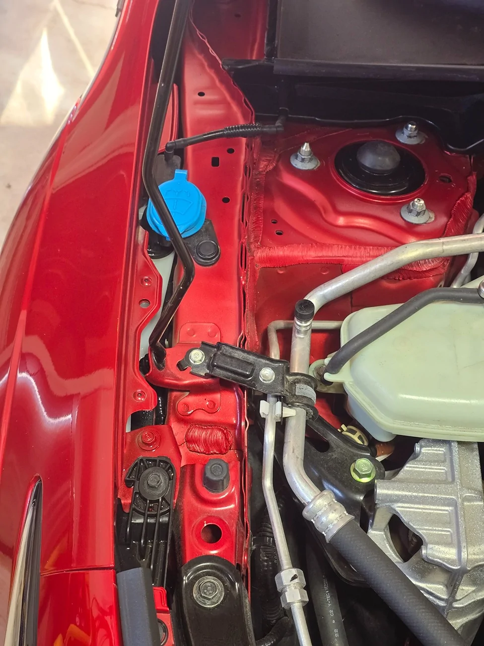

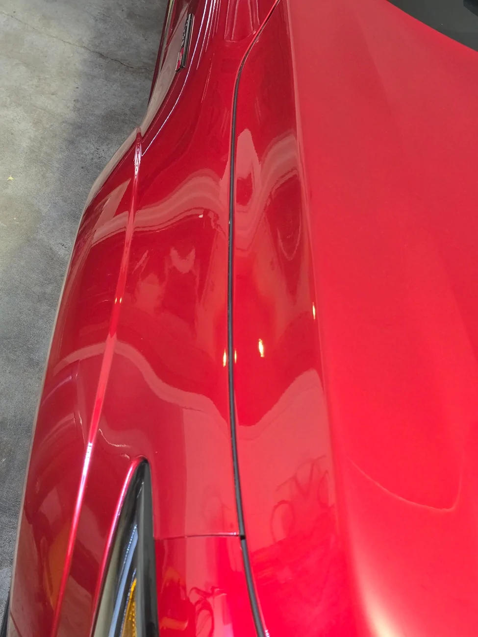

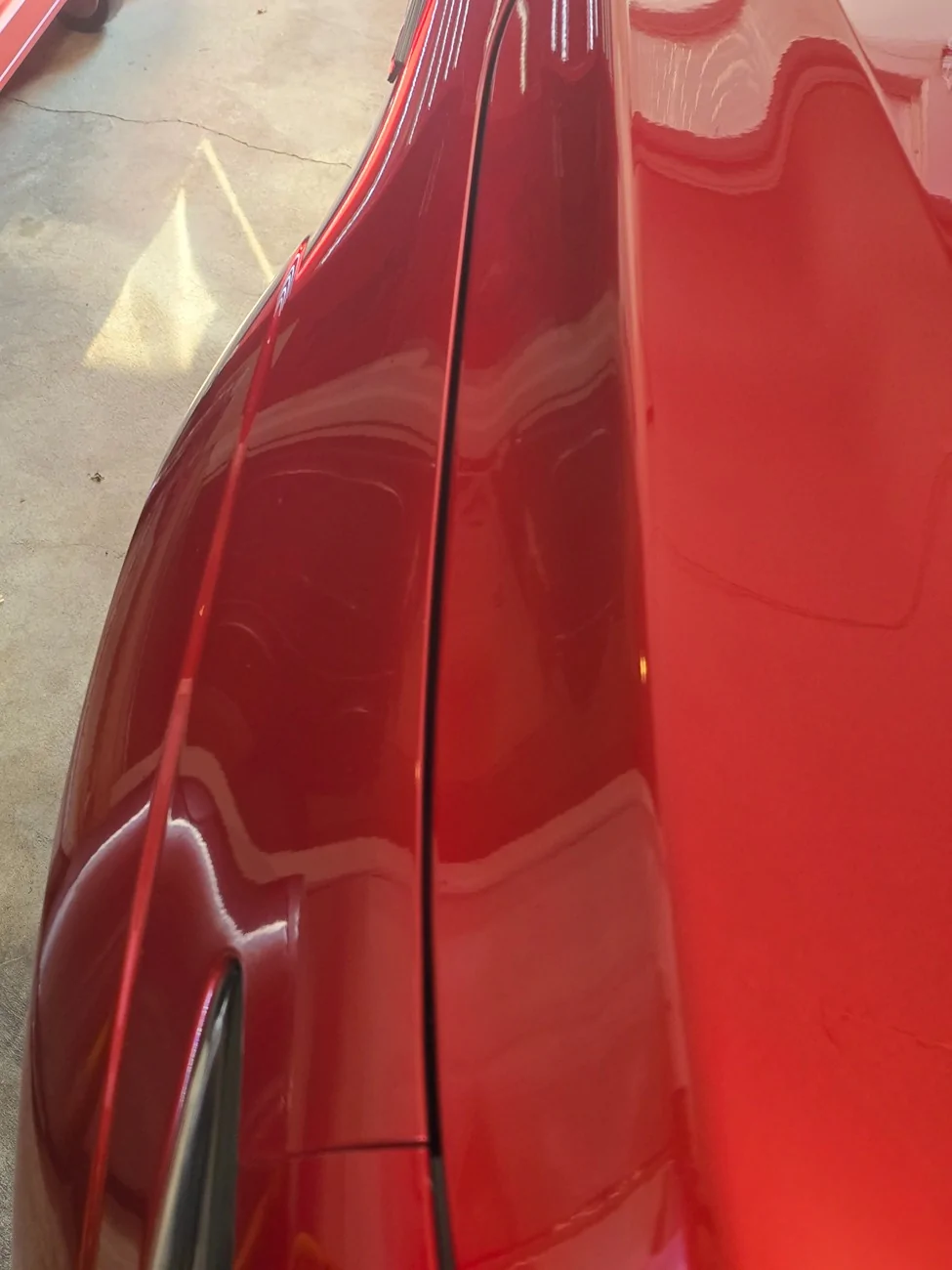

I did another thing. Couldn't stand the size of the gap anymore. I added this gasket to complete it around. I'm really not sure why acura left it off. The mounting tabs and slots for a gasket are literally there, they just didn't put it in. Sealing this helps aero, cooling, and no more ugly blue cap.
