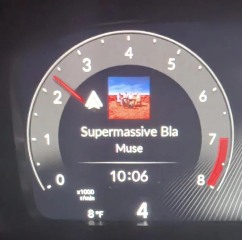

Mine lives outside. No issues sitting for 4 days in 10 degree weather. Started right up. Tomorrow it will be -5 so I'll let ya know if there is a change
Acura Integra What type of battery does the ITS have? AGM? 20250121-1
