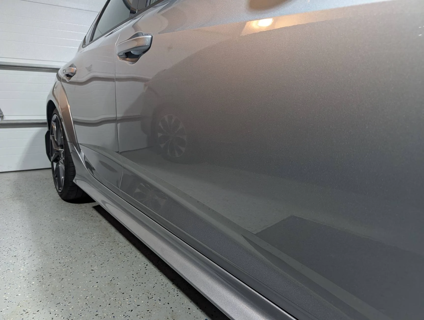

Sadly it's that time of year again.... ?
Oil changed and shined to a mirror polish.
Acura Integra Winter Storage 1000002995
Tomorrow I'll go top off the tank, add fuel stabilizer, plug in the tender and wrap it up it the car bag. Who knows, I might even read it a bed time story ?.
Those who are storing, what is your estimated back on the road date. For me it's April 1st, 2025
