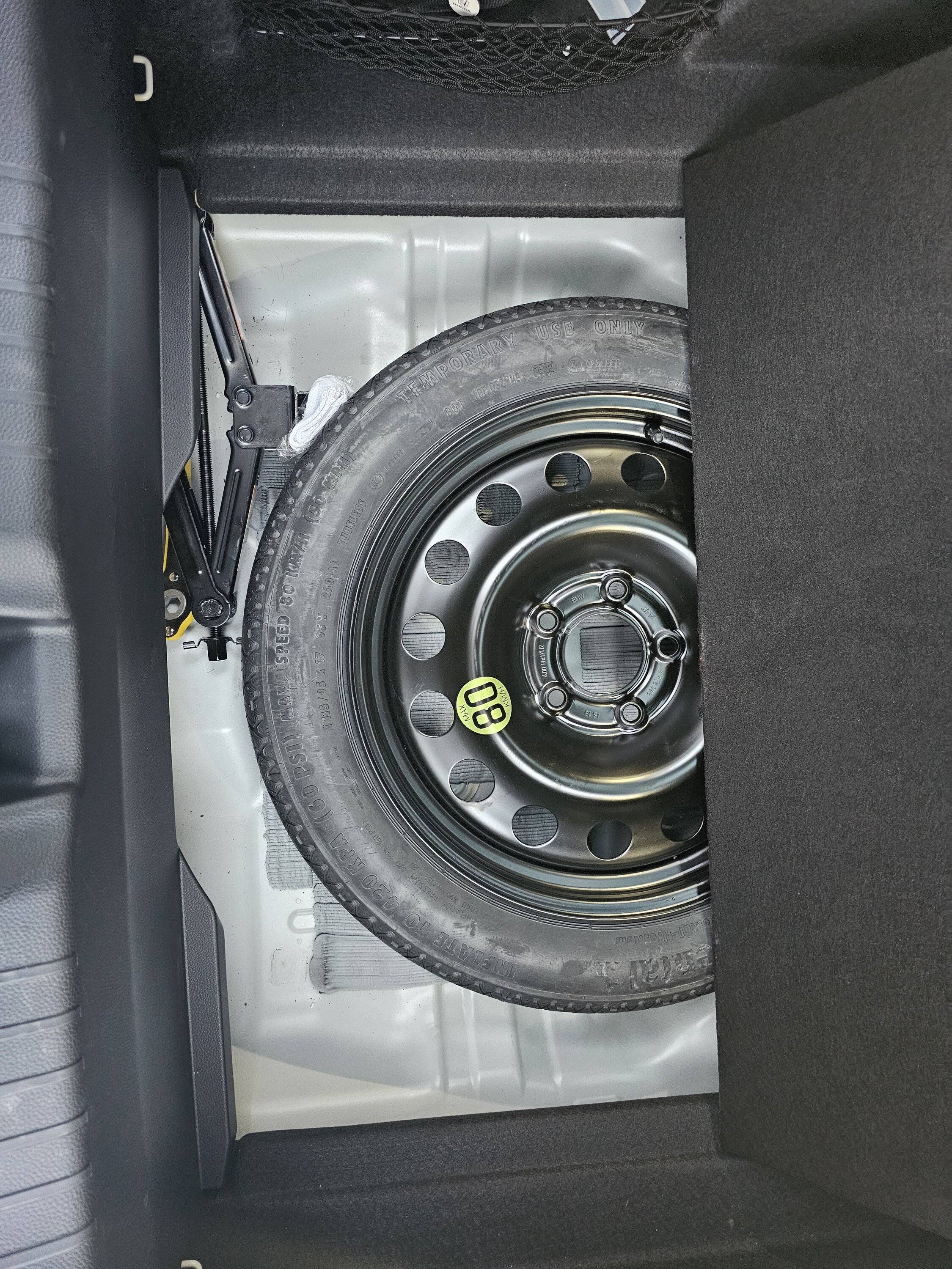

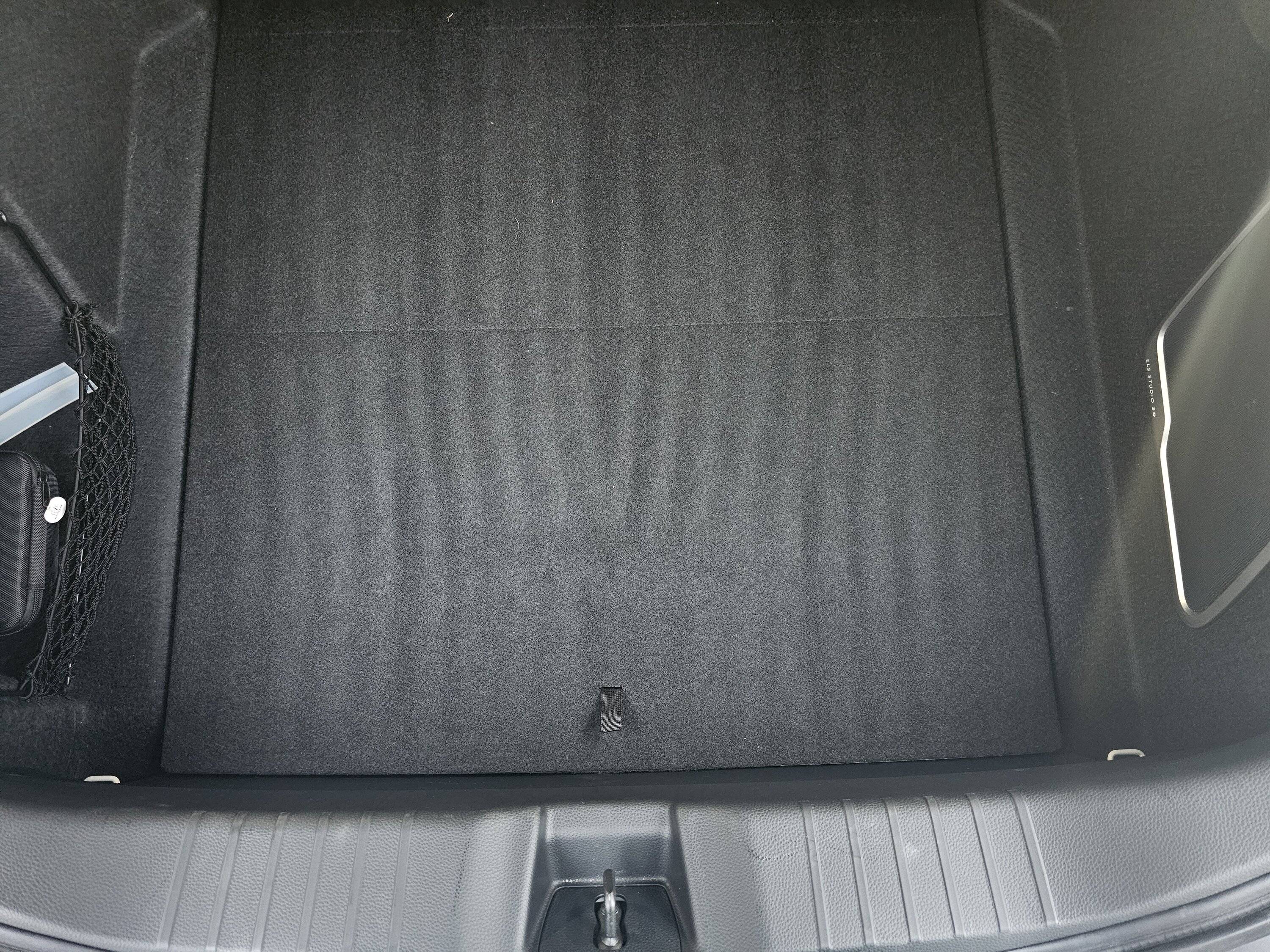

So I bought all the parts and had the tire mounted today. Below are my results:
Acura Integra A Spare Tire That Fits Under the Load Floor 20240104_171734
As you can see in the above image I used the jack to hold the tire in place. This seems to work well. The tire doesn't budge.

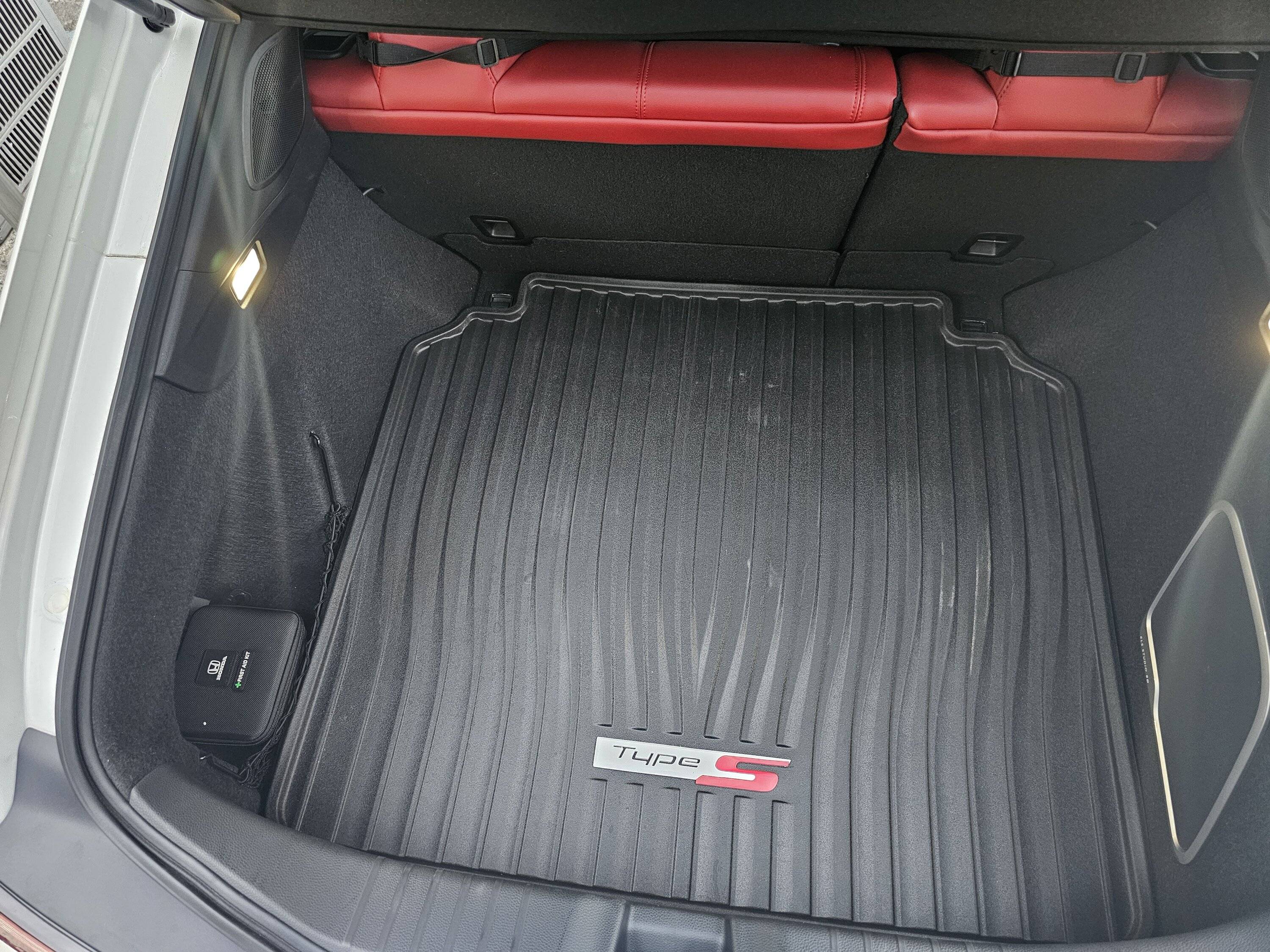

The cover panel doesn't sit perfectly* flush, but the gap is barely noticeable. In fact the all weather math is heavy enough to weight down. It's a non issue, really.
Acura Integra A Spare Tire That Fits Under the Load Floor 20240104_171859
Let me know if you guys need any additional shots or anything. Thanks again @kjechel

I'm glad this worked out for you, and clever use of the jack. Looks like you bought the jack I recommended, which has a special feature. The jack's screw has a double thread so as the jack raises, the end that you rotate stays in the same place, rather than moving towards the center of the jack as it raises. That makes it much easier to jack up with the ratchet, since it always stays outboard of the rocker panel. A few reviewers said the ratchet was weak and broke. If that happens, you can still use a 3/4" socket on your breaker bar to operate the jack if needed.
FYI, if you place the jack under the pinch weld just below the gap between the front fender and door, both wheels on that side of the car will be off the ground when you've lifted the car up only 4 inches. That makes swapping front <> rear wheels easy if needed.
