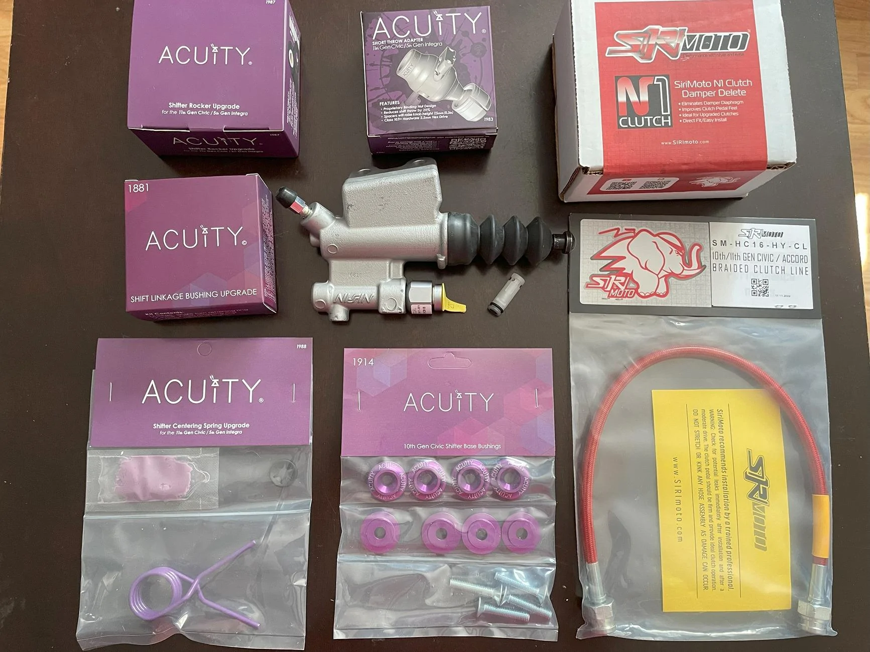

I got the stage 2 kit from unity performance it came in this week and the install is planned for tomorrow. It's $10 less from Unity than it was from acuities website.
Shout out to Humza @Unity Performance
Stage 2 Shift Kit | 22+ Civic, 23+ Integra – Unity Performance (unity-performance.com)
Since I have to remove the battery and intake to install the cable shifter bushings I am going to do the damper delete at the same time. I got the Siri Moto damper delete, Stainless steel clutch line and removed the delay valve from the slave cylinder.
Gonna video the install and will report back. I wanted to retain the stock boot and look, but all the short shifters I looked at required the stock shift boot delete. Dont want my daughter dropping something in there, ;)

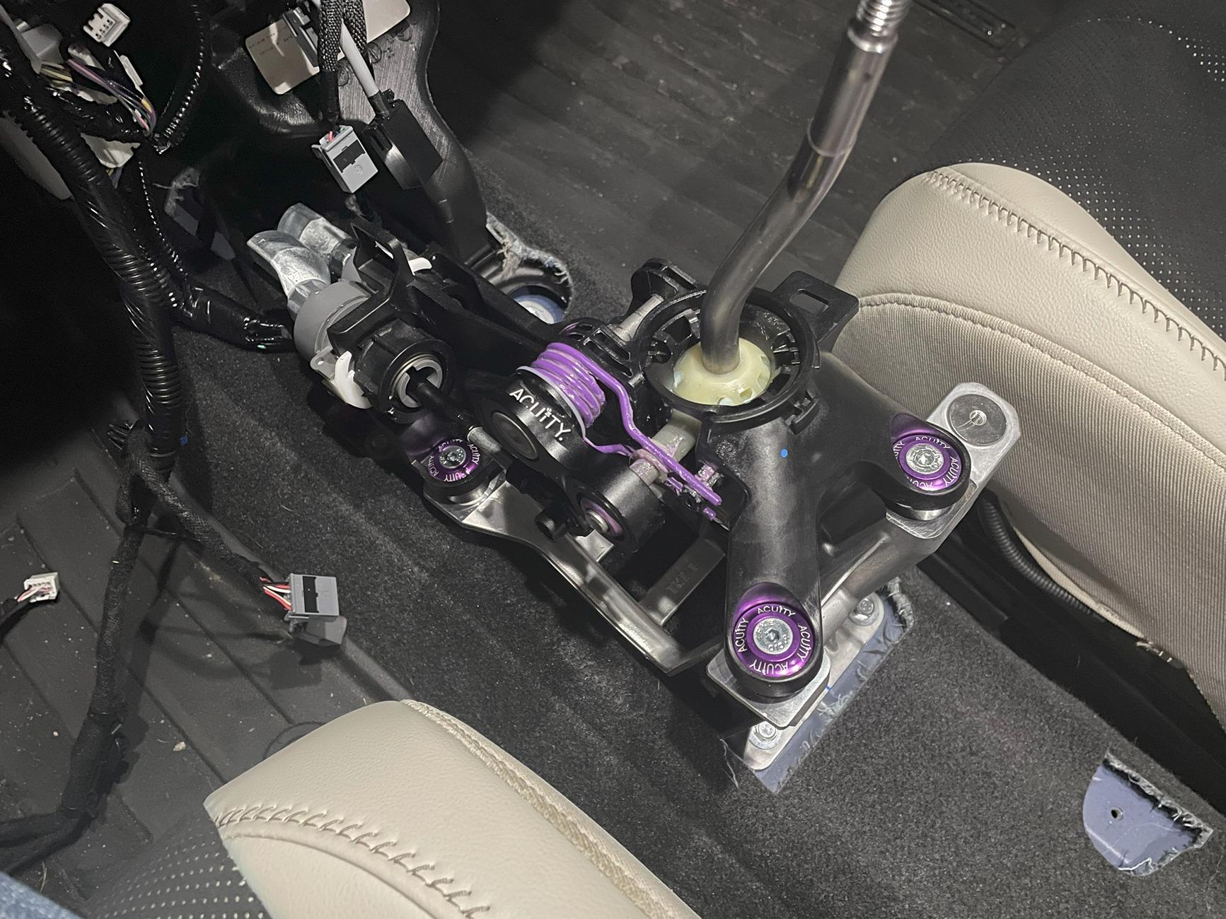

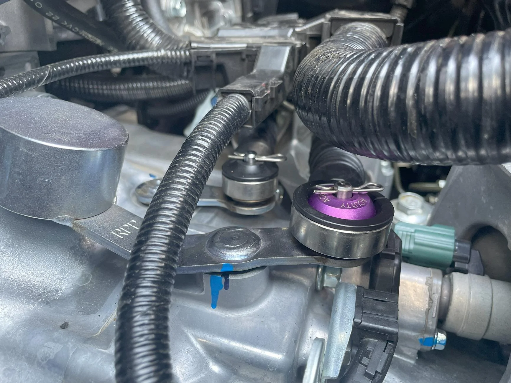

I installed the stage two kit this weekend. Install was relatively painless except for having to remove everything to get to shift linkage bushings in the engine bay. Installed the Siri Moto N1 Clutch damper and my slave cylinder with the delay valve removed. Could not get old flex line out to replace with steel braided clutch line. one of the nuts started stripping even with the flare wrench.
I am very pleased with the feel. it is very crisp, tight and precise. I didn't think the acuity kit would make as much difference as it feels. Wish I'd done this mod a while back.
The clutch damper and having the delay valve removed isn't as noticeable to me maybe because my civic hatch has a stage three clutch with almost instant engagement. So it's hard to compare the before and after but the friction point is a little more noticeable

Did the kit take out any shifter play? My stock set up has quite a bit of wiggle to the shifter when in gear, looking to get rid of that and have a more rigid set up.
Also, are you going to post an install vid?
Yes, I am very surprised it made that much of a noticeable difference in the feel.
And yes, I will post the video later this week once I get time to edit it. Got a shot of the play before and after. (only thing video wont show is how much stiffer it is and how much more force is required for it to move the same amount.)
STIFF, TIGHT, PRECISE.. IMO.... good mod..
