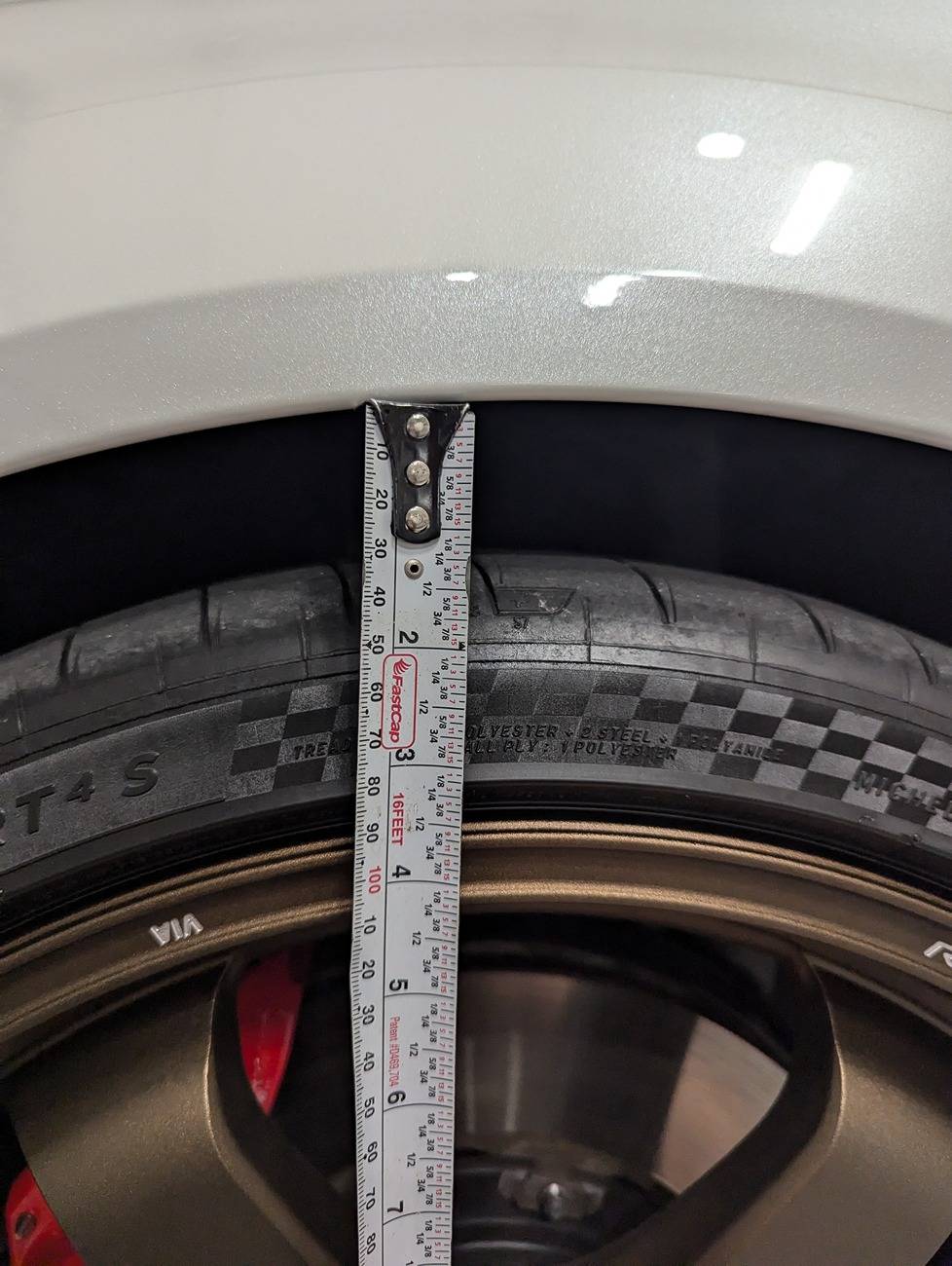

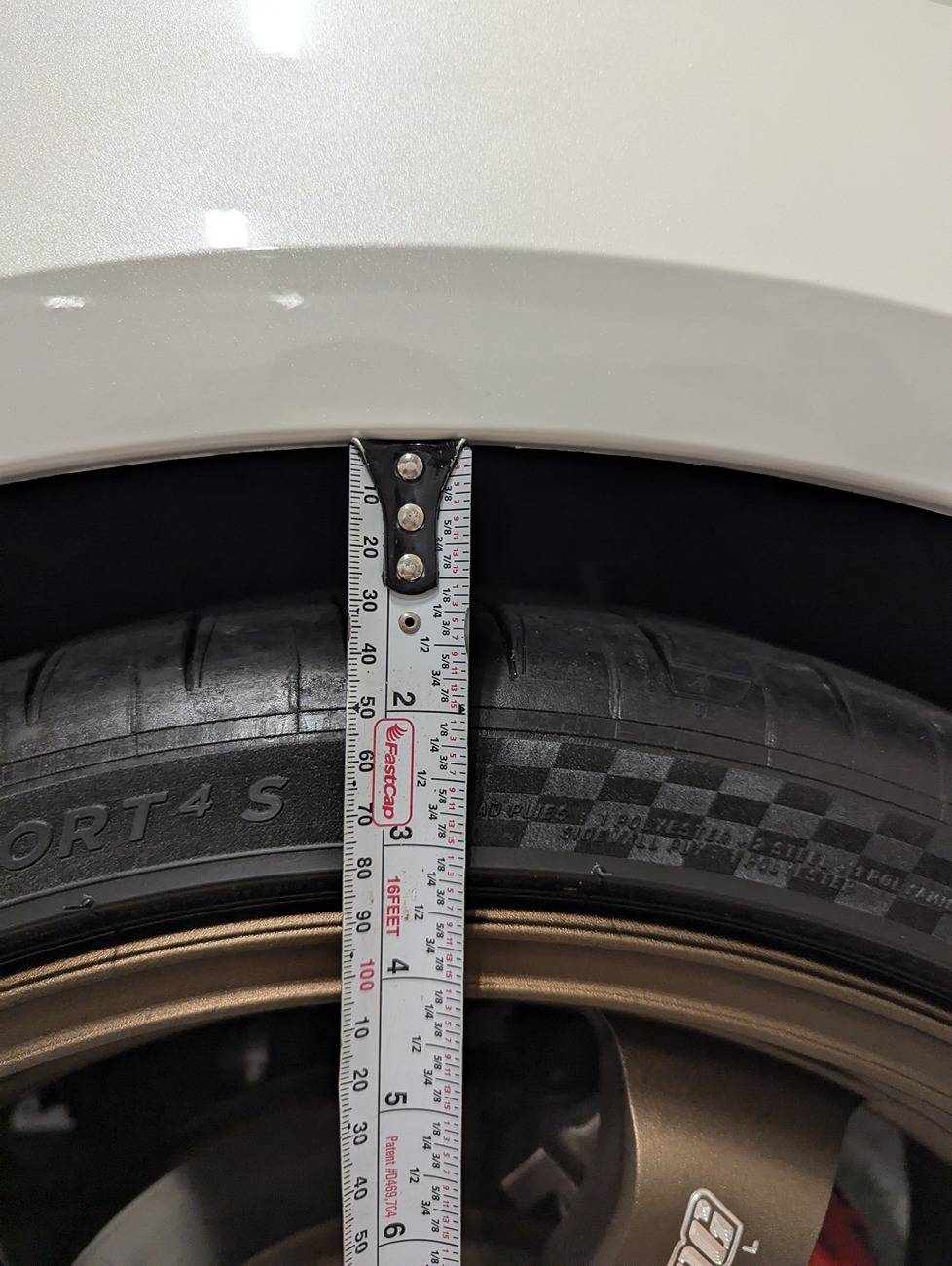

Along this thread lines, has anyone ran H&R springs in TEs 19x9.5 with +36 offset ?
+36 turns out pretty aggressive so I am concerned that under cornering / braking it could rub. It'll either be perfect.... or rub a little.

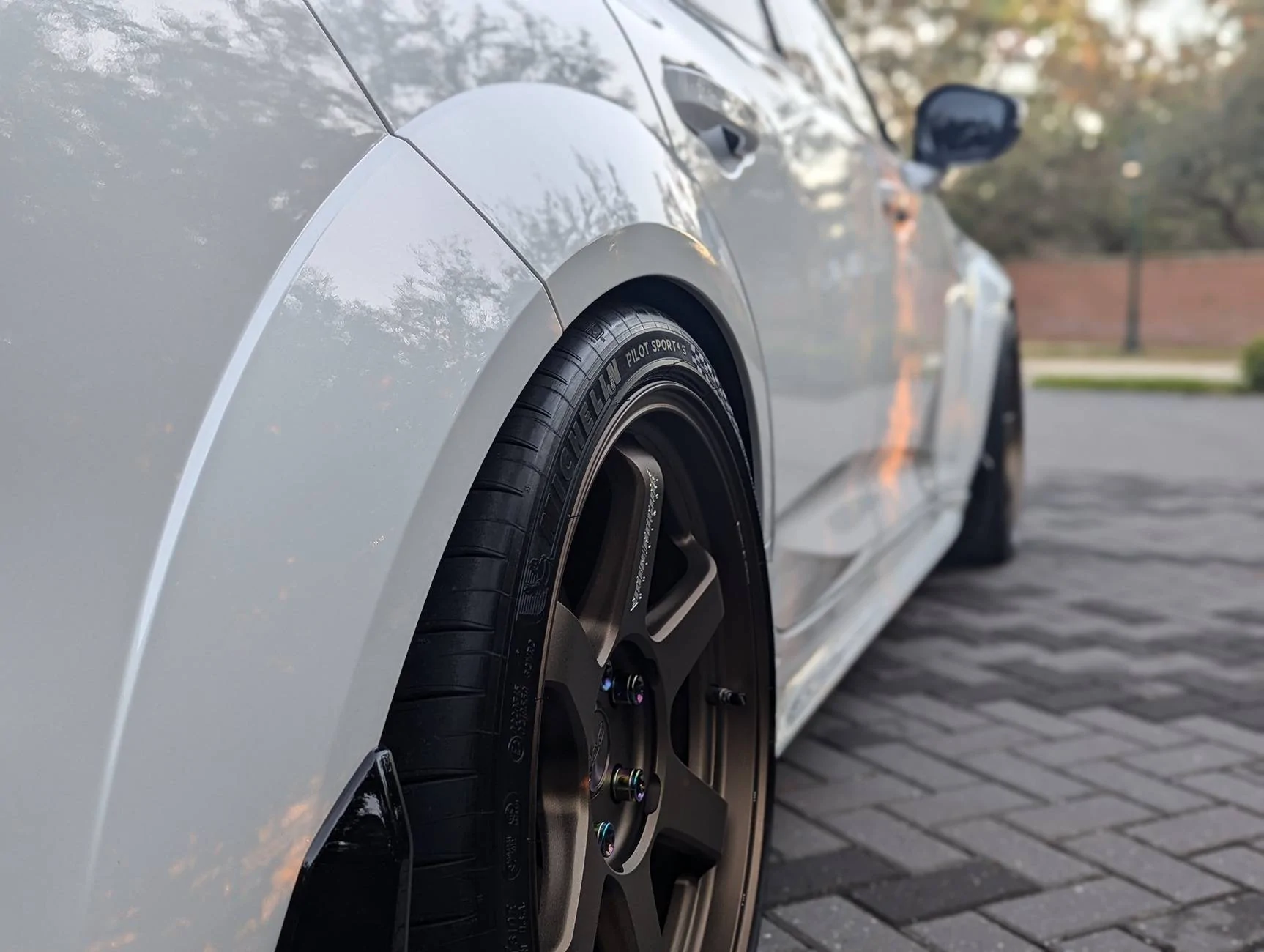

Hey stinger, I'm running 19 x 9.5 +36 offset , stock PS4s tires. Pokes about 5mm ??
