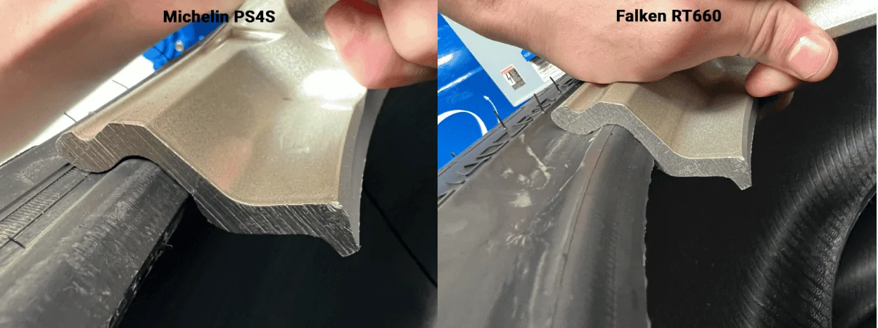

Made inquiry to Apex and the reply basically echoed what was posted here already.
They did send theses pics which helps illustrate how the PS4S bead is narrower than some other brands.
From this it's understandable that the knurling may effect bead seating.

copied from a bmw forum....smmfh......pic is misleading pressure is being applied on the Falken tire...Are they even the same rim type?..I figured more eyes may spot other issues

I agree that the picture is misleading. Pressure is not being applied in the same way.
However, experience is definitely showing that there is an issue of some sort.
