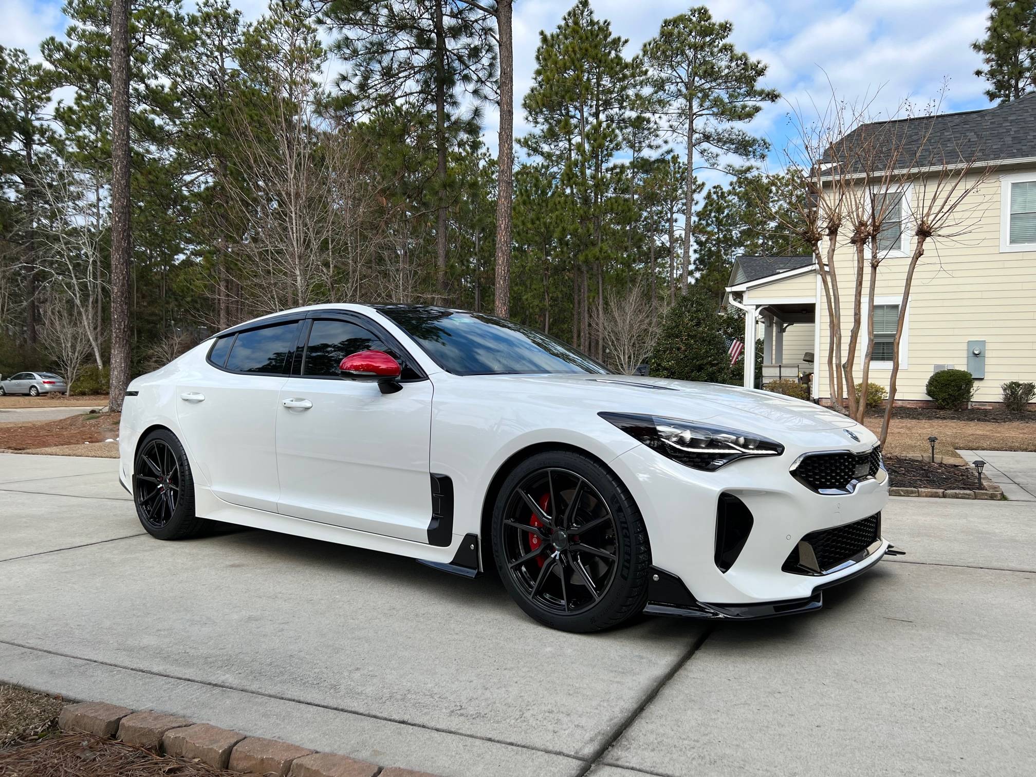

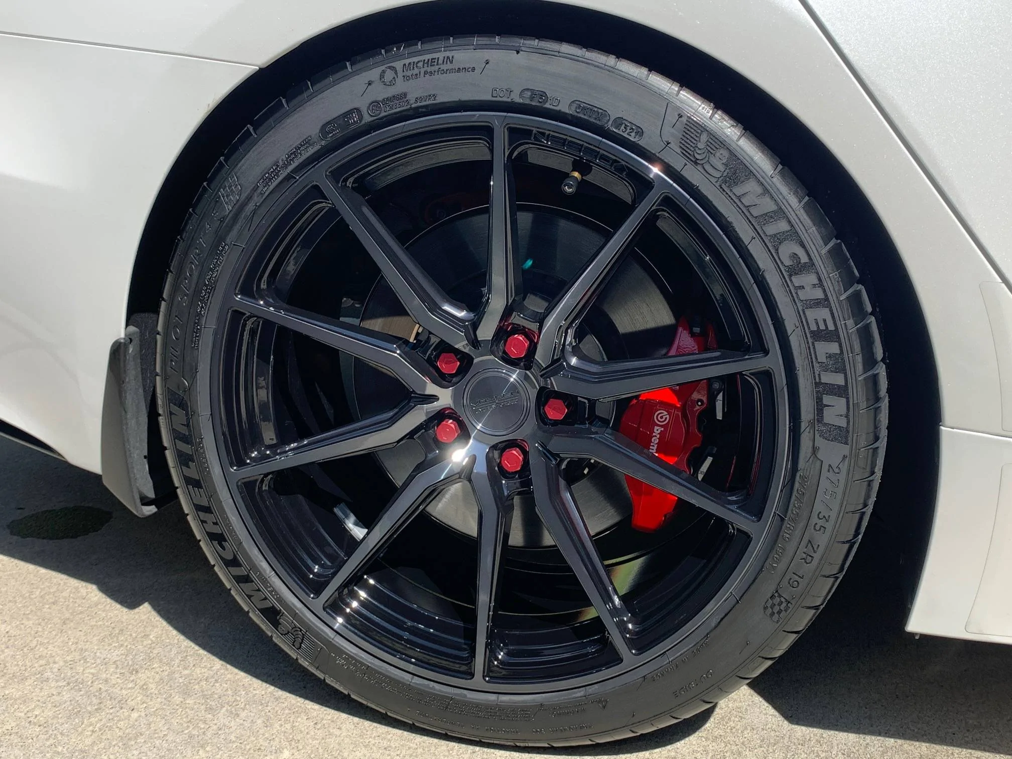

@optronix, I know the video you're talking about. I think his issue was 90% low tire pressure. I also think that he may have de-beaded the tire after a potentially catastrophic air loss. 265x30 is such a skinny sidewall. Also, the tire is slightly stretched on a 9.5 inch wide rim. I think the 275 x 30 tire on the Apex rims will be fine. 3mm more sidewall, plus less stretch with the 275 width. I think the tires will be able to give a bit more in cornering. The Continentals were tight as hell when they put them on. took over 100 psi to get them to seat. I will say I won't be trying to hold my tire pressure at 36 on the track. I'll let it go to 39 or 40 in the front just to be safe. with my driving style I think it will be fine.
The only downside to the 19's and a 275 set-up is there aren't a lot of non-michelin tire options.
If I wasn't lowered, I would happily run 275 x 35 tires. No room for that now.
Upside to 18's is 265 x 35 or even 275 x 35 is fine.
When I had my Stinger I was running 275 x 35 on 9.5 inch vossens and it was just the right amount of sidewall.

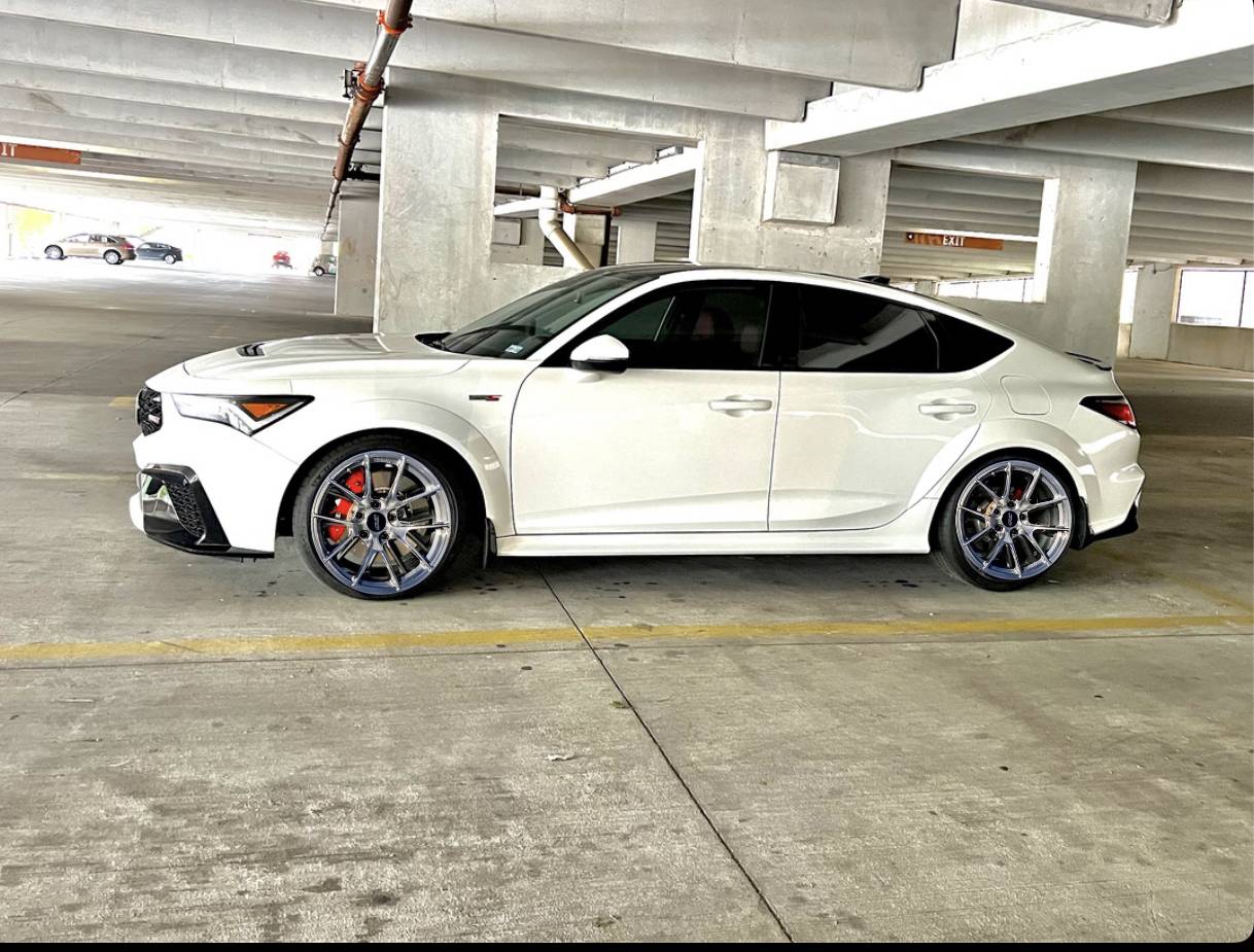

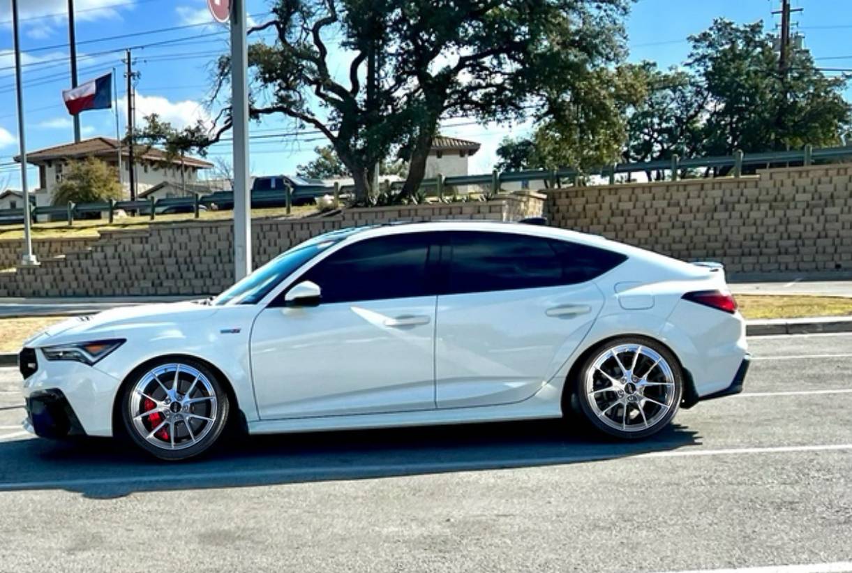

I’m really thinking I want to go brush clear with black hardware. But maybe I’m crazy.. I’ve been doing black wheels now since like 2011 and feel like it’s time to make a change.. you know like 2pac used to say. I did a little photoshop.. could it be to blingy?

silver wheels are classic. not too much bling IMO. I get wanting to move away from black rims. If I had a white, red, blue or black car, I would get the bronze color Apex offers.

Just to comment on the looks, I think brushed clear would look great on white like it does on your photoshop for sure. And it would be set apart from what we’ve seen so far.

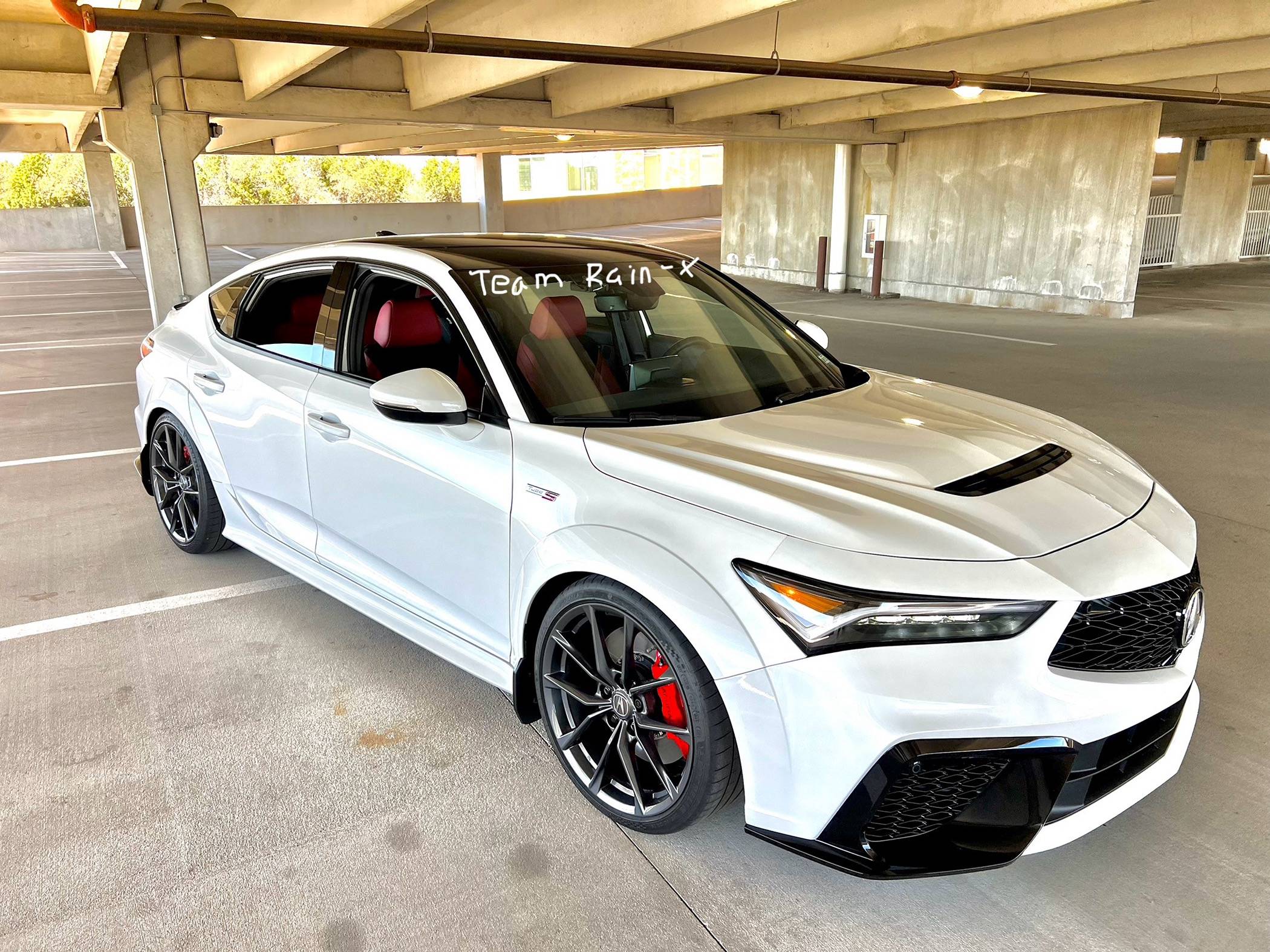

Thanks. Yea I figure I go brush clear and I can keep the stock color badges. Yea idea is to run those Continental tires in the 275-30. Saw that look and like the bigger side wall look. I figure I’ll keeps the stock wheels all set up save for road trips since I’m sure brush clear gonna need some cleaning every 53 miles.
Or I keep it stock since car already looks pretty good on stock wheels…. Maybe I just need to add my Team Rain-X banner cross the wind screen like back in highschool. Lol bunch of dorks 🤪

Dude, that handwritten banner is cracking me up. 😆 it’s awesome. That should be your profile pic. Lol

lol ya i had a blue banner like that on my blue Si back in the day. Lol. I sent it to my buddy from college and he laughed said you need to do it again! I said my wife will give me so much shit. 😝🤪
