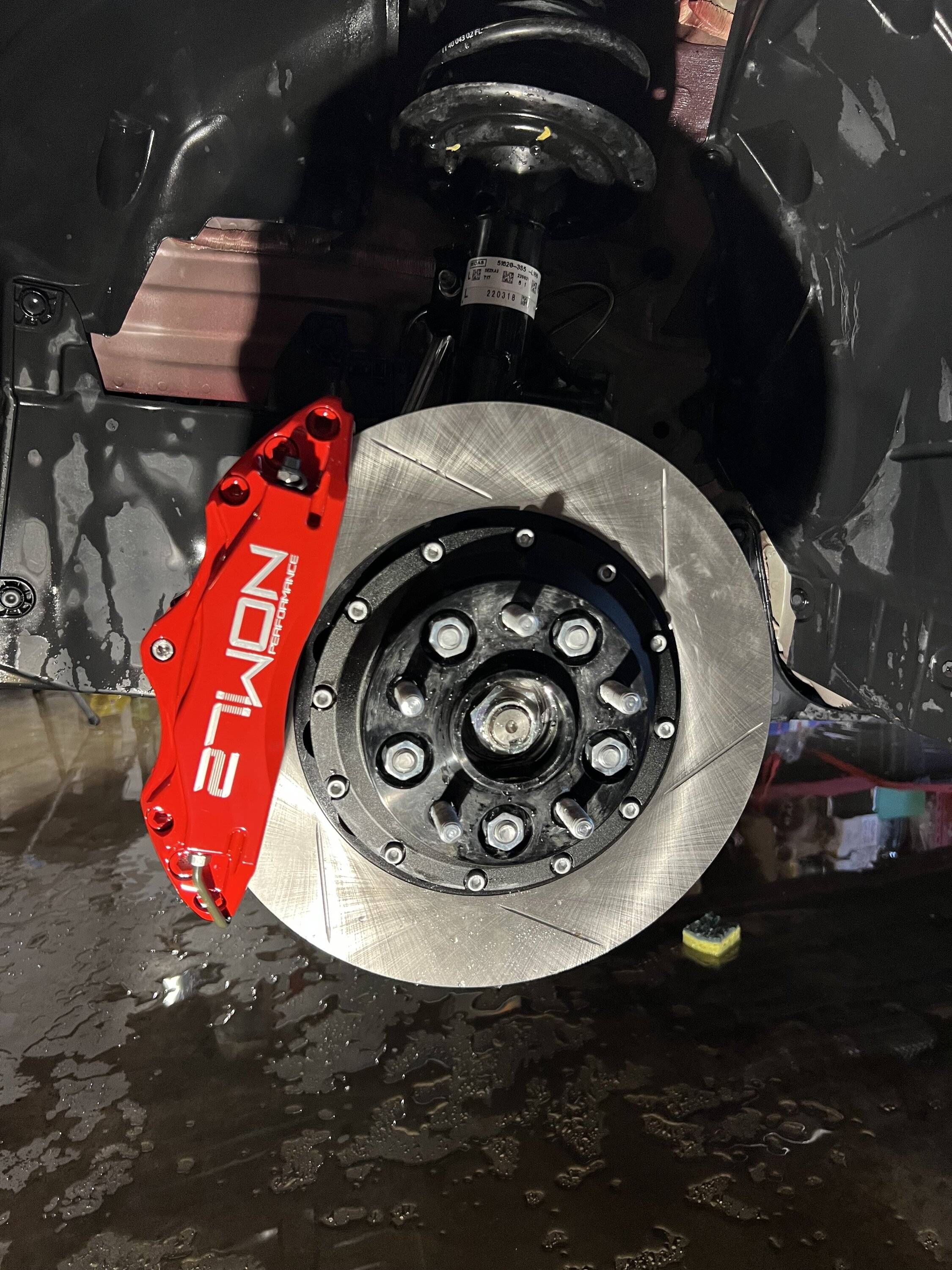

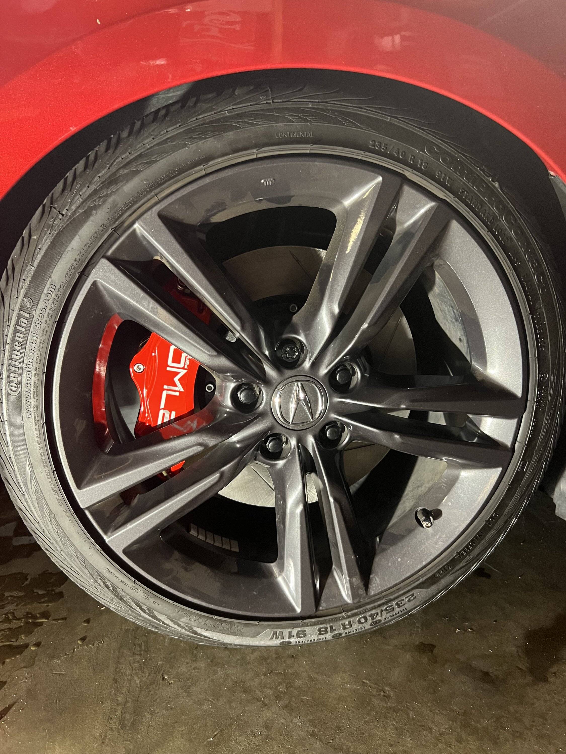

Just an update , I am running the 27won BBK with 20Mm spacers and everything fit perfect. I’m only posting this if future people that may want to rock a bbk with oem wheels.

looks so good, did you need spacers for the new breaks? is that what you meant when you said you’re worried about it clearing the stock wheels? looking to do something like this for mine just unsure
Yes you’ll need the spacers, I have 20mm spacers in the front, with out it the bbk will not clear.
okay thanks for that, i was thinking about getting different rims and tires in the spring will the spacer size have to be different depending on the rim?
