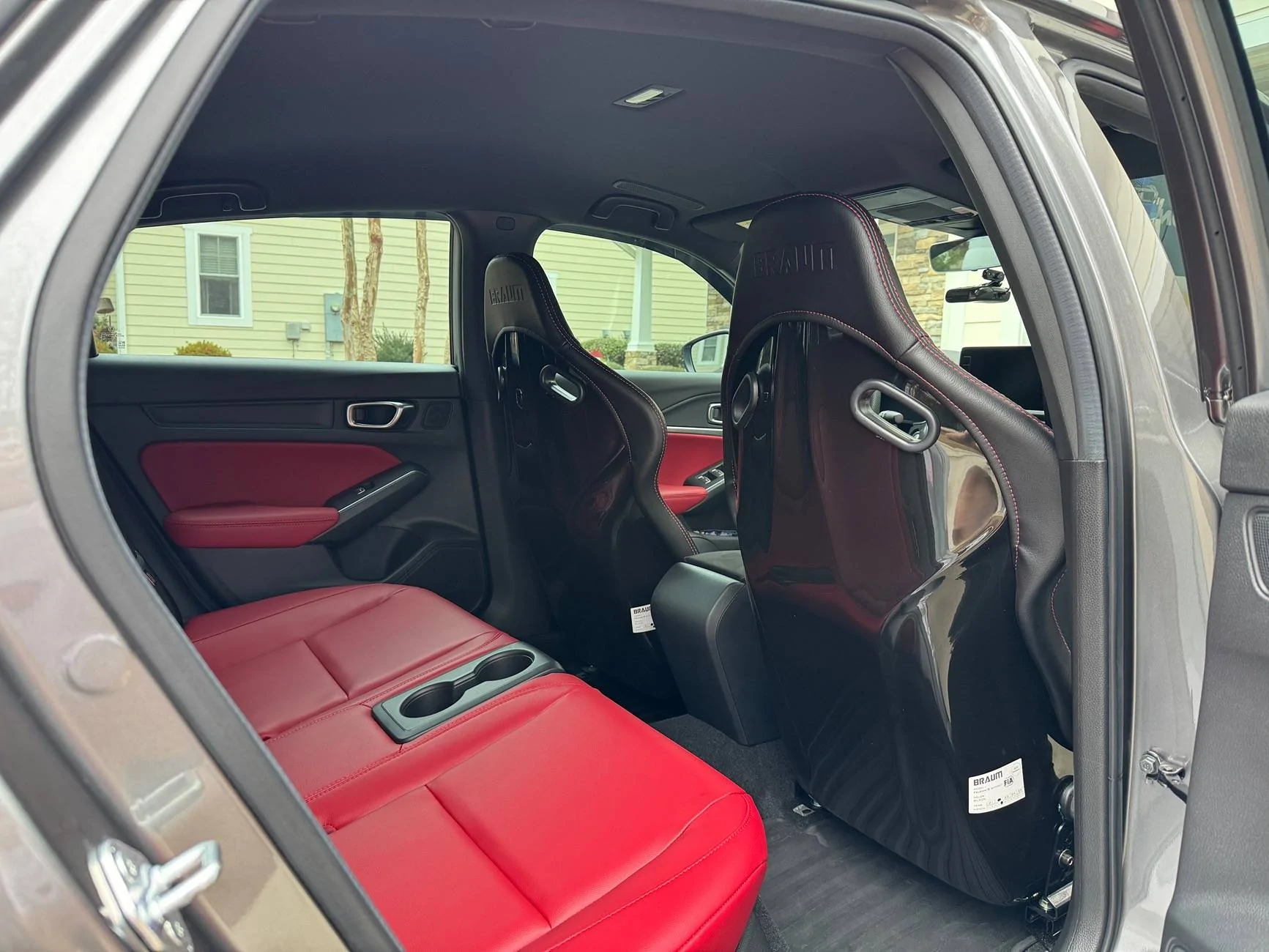

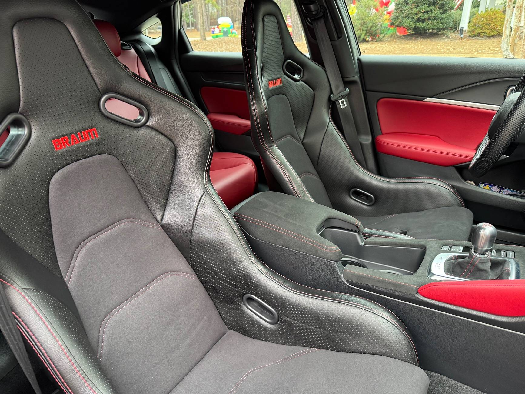

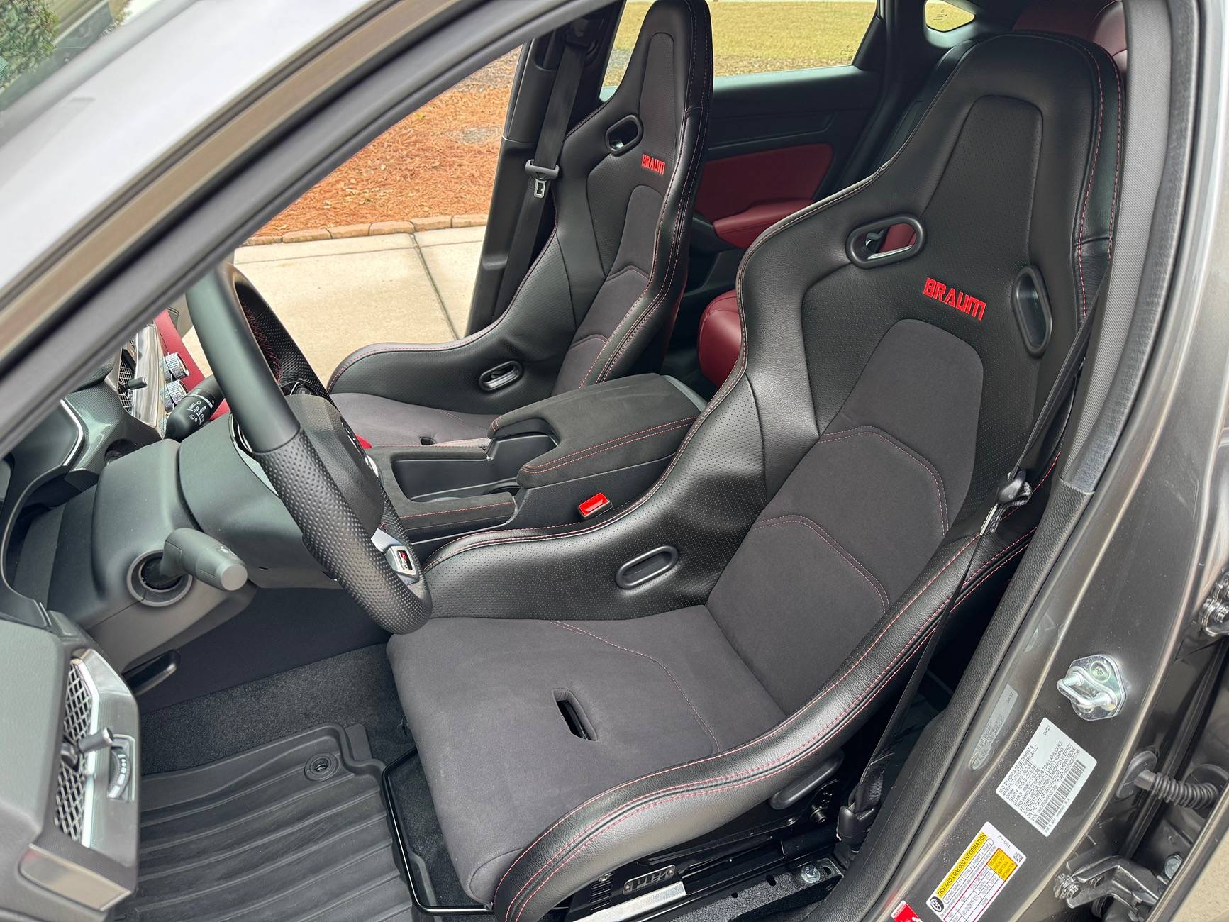

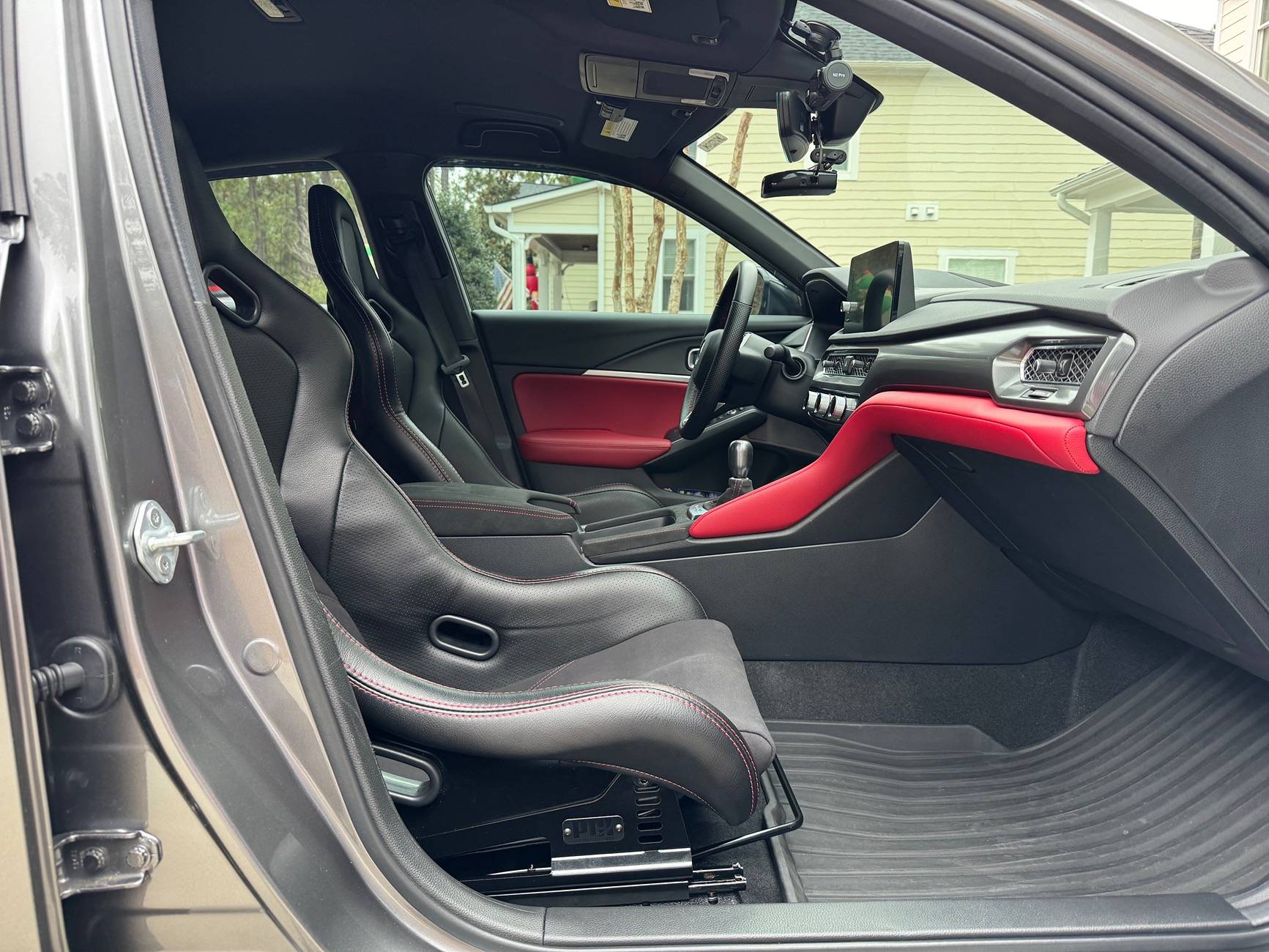

Finished up the passenger side as well. Here’s a few more pics. The two ohm resistor I put in the driver side did not do the trick as far as turning off the airbag light. And I cut the connector off L O L. I did save enough wire to reattach it when I eventually go back to stock.
I’m gonna do some more research on the situation and hopefully figure that piece out. I am using the stock three point seat belts, so the seatbelt situation is fine.
Acura Integra Braum Falcon S IMG_3931
Acura Integra Braum Falcon S IMG_3937
Acura Integra Braum Falcon S IMG_3936
Acura Integra Braum Falcon S IMG_3929
Acura Integra Braum Falcon S IMG_3930
