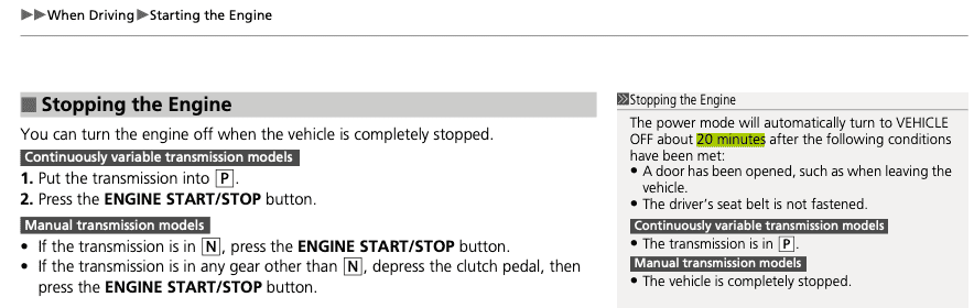

Happened to me after leaving people in the car to look at some furniture in a store.
This is the only reference I found in the manual.
Acura Integra Car Shuts Itself Off After Extended Period Of Idling Approx 30mins Screenshot 2023-11-16 at 1.18.00 PM
