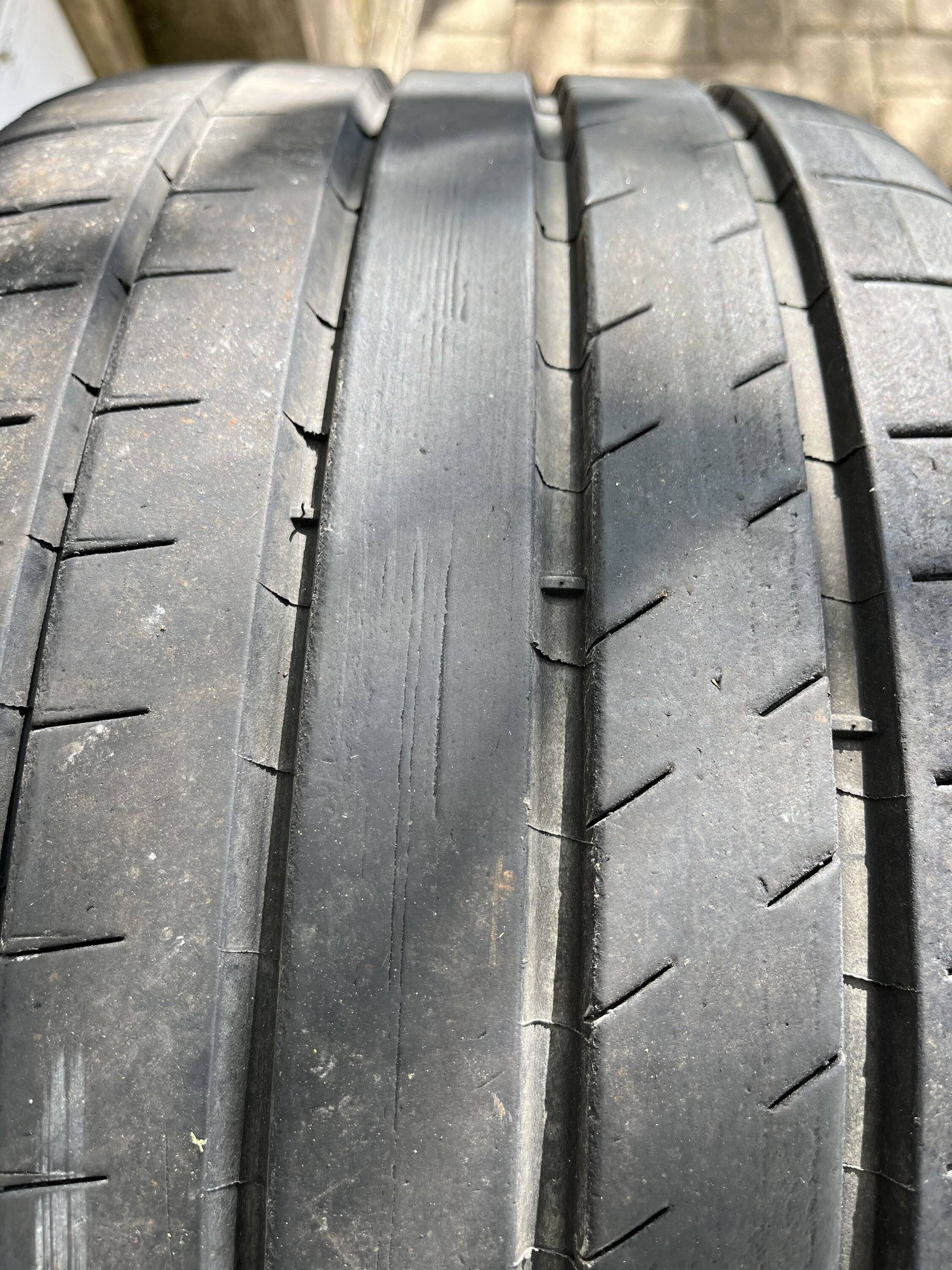

Didn’t want to start a new thread, so gonna post this here. I was finally inspecting my PS4S while I was cleaning the garage last weekend. I tracked these once at road America, as I have with other PS4s in the past. But I’ve never seen a wear pattern like this. Any thoughts? Guess this proves near 0 scrub?
Acura Integra Changing from OEM Tires on Type S IMG_4441

Over inflation??? Looks like only the dead center was affected. Can't think of another issue that would have done this because it's such a square tire

agreed, over inflation. I had a bit of a time keeping air pressures under control at the track last week. Between changing temps throughout the day and picking up between 5 and 7 lbs of pressure during a session it ws tough. One session finished with the fronts at 39 and 40 lbs. (gained 7-8 lbs on driver front in one 30 minute session)
maybe your temps got high while on the track?

That could be it, though I made sure to try to keep pressures under control. But like you said, trickier than expected especially on a high speed course. Would you have any concern using these in the future? Think they’re safe since it’s not like the chords are showing

I would definitely keep using those tires in the future. Lots of life left in them!
