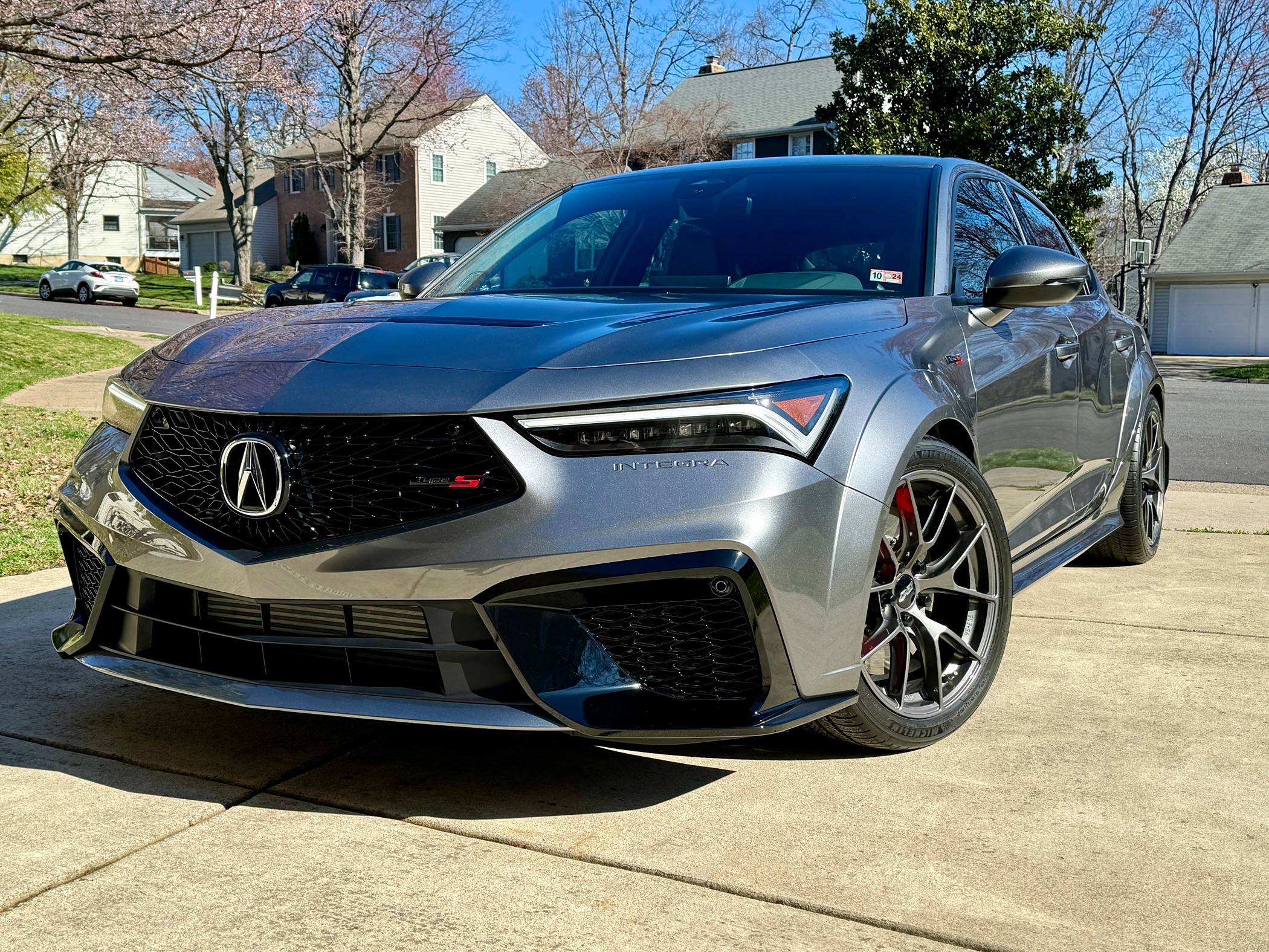

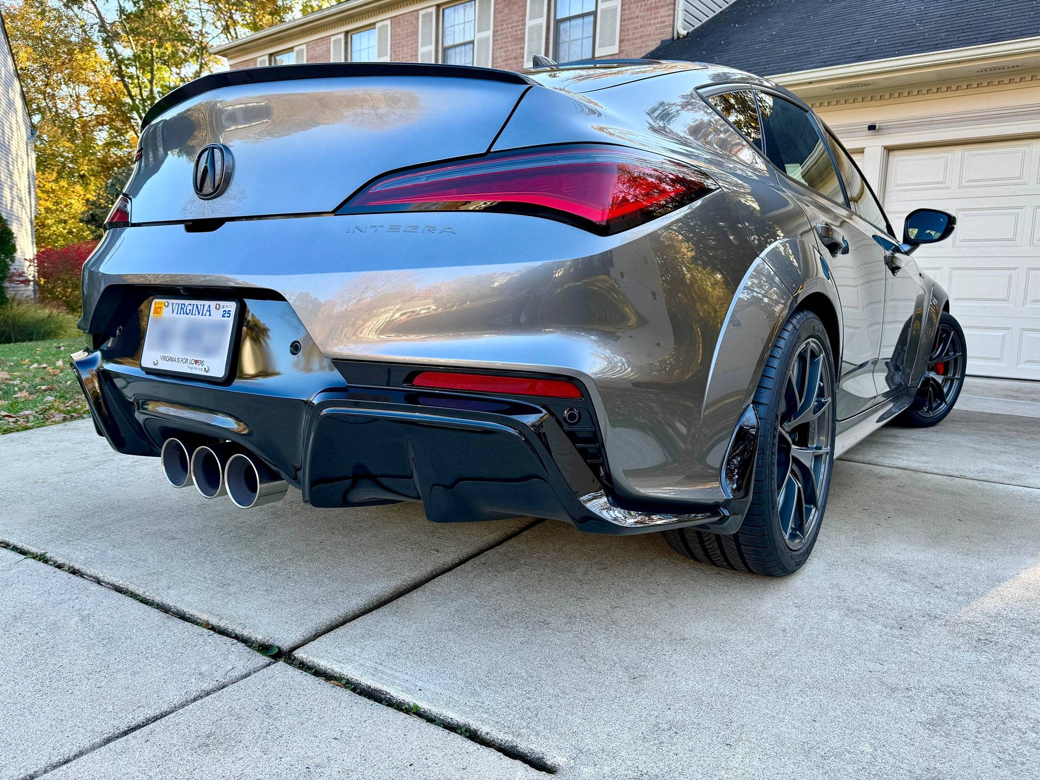

I've been running Apex VS-5RS with Michelin Pilot Sport All Season 4 265/35-ZR18 since October 2023 without issue. No loss in pressure or anything odd to report. Handling isn't quite as crisp but the gains of confidently driving the car in seasonal weather is a tradeoff I'll take all day, every day. No regrets whatsoever.
The VS-5RS are a direct fit wheel so no need to mess with spacers or adapters. Just be aware that you also need to get a set of conical seat lug nuts which is typical for aftermarket wheels.
I purchased a set of OEM TPMS 42753-T6N-E03 rather than transfer them from the OEM wheels. The ITS will automatically learn new OEM TPMS so no need to reprogram anything.
If you prefer an Acura center cap then order four 44732-TGV-A01 which fit the Apex wheels.
Personally, I think this car looks better with the 18" wheels, a more squared tire and the wider offset. This is how the setup looks on my stock ITS...

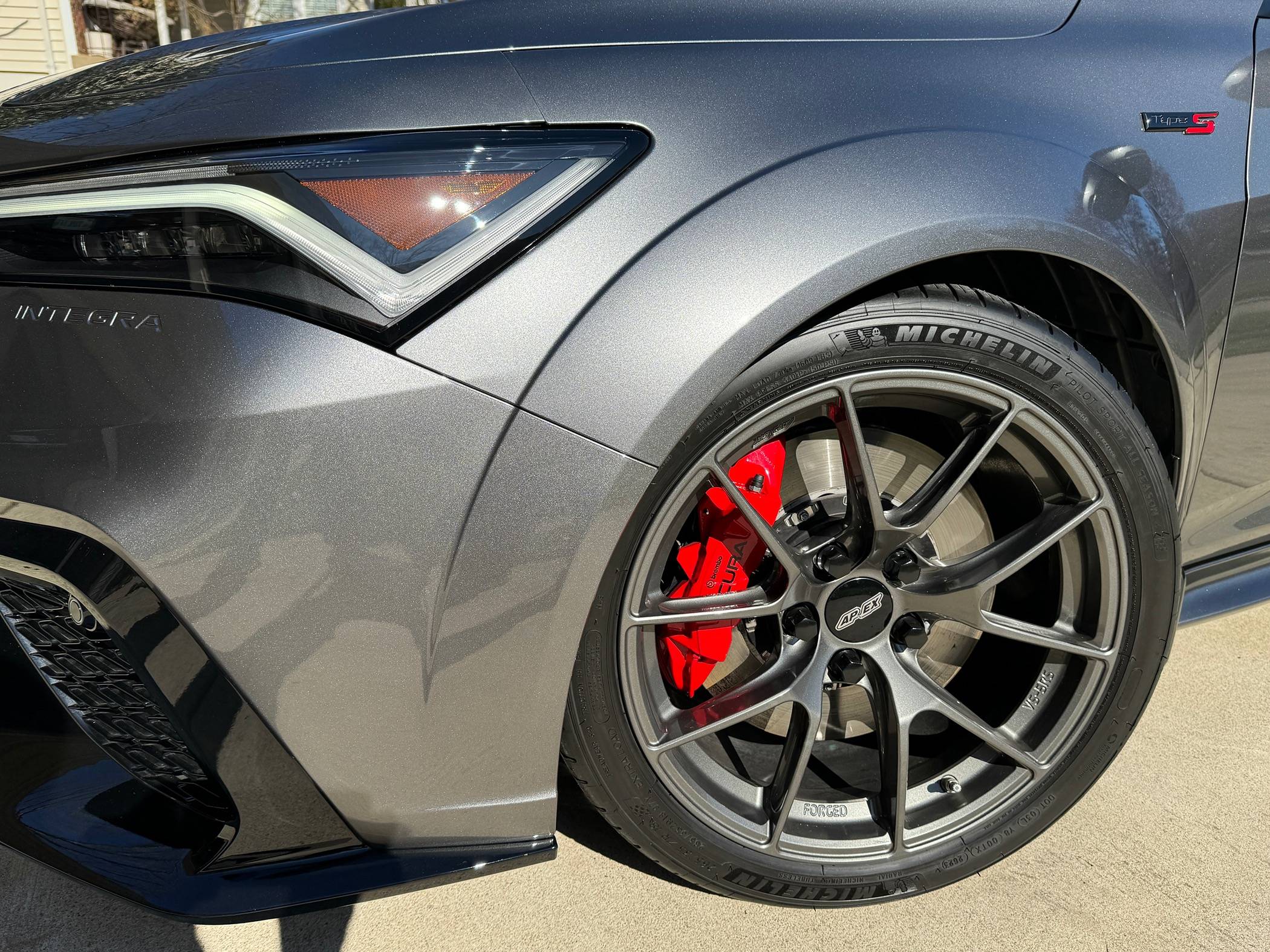

I just picked up my car yesterday afternoon from having 19" x 9.5 +45 Apex VS-5RS installed. I am running OEM diameter and stayed with the OEM Michelin PS4S but the offset did change a few things; I wouldn't call it imperceptible but not significant enough to be a deterrent. Switching to all seasons is a dramatic change but as others have noted, depending on your use case probably a better fit for folks who may not engage in motorsports-ish activities and would prefer a year-round tire without having to swap. Eventually when these PS4S are cooked (they're getting there fast...) I'll put a set of more capable tires that will change things yet again and probably won't even think about the OEM setup.
