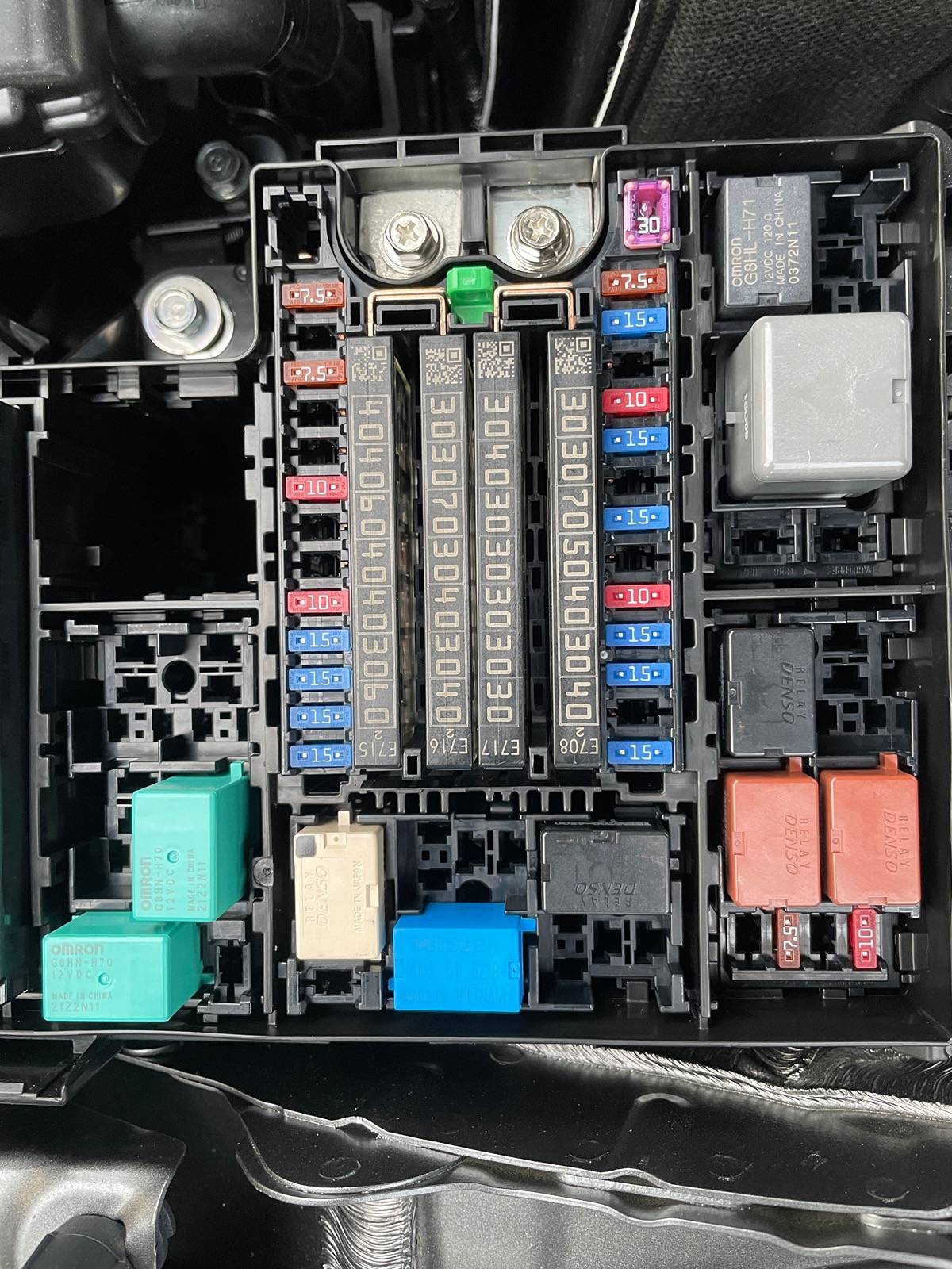

So....7 months later.....the cause has been found. I can only assume this happened during assembly, but the reason why I've never heard them on my car is because two fuses were in the wrong places. They JUST figured it out after numerous attempts to find out why. Wow!! It was causing the computer to not communicate with the exhaust components which caused the valve to not open correctly and no pops and bangs. I can't believe it was something so simple.
I'm really excited to get back to the dealership and hear (for the FIRST TIME) what my car is actually supposed to sound like. He also said it was causing the car to not be giving full power so that should be fun too.
Wow. I still can't believe it.
Were you getting any check engine light with the fuses improperly placed?
Can you advise the specific fuses?
I’ve not gotten the pops and burbles on the car like the one I test drove. But, otherwise everything appears normal.
I had no CEL. That alone was causing the service department give me a lot of push back basically calling me insane. He showed me which two but Ive honestly forgotten. But if you pull the cover under the hood and go down the fuses one by one, then If your problem is the same one it's my problem. It'll be two of them that are in the wrong spots and you'll see it
