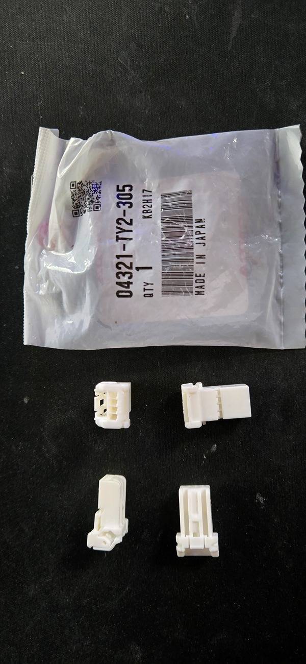

I managed to do the same thing and figured out that the Honda part # for this connector is 04321-TY2-305. It comes in packs of 5 so I have 4 extra for anyone who may need one.
Acura Integra Door led connector 1000014186
602
375
Just following up here.
Thank you so much for sending the connector over!! I finally got it installed today, super easy with the pins not totally destroyed. It's all back together and working well now!
I also replaced the vapor barrier with a new one and added butyl aluminum material inside the door. Huge improvements with just a bit of work.
