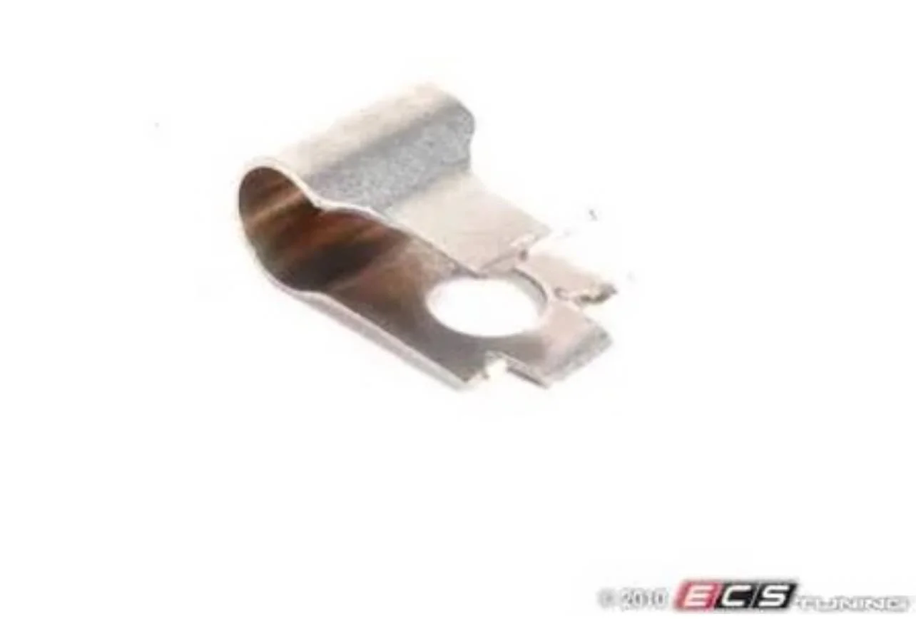

I’ve owned many turbocharged cars and I’ve only had one other vehicle have the wastegate rattle. That was my 2016 Cadillac ATS-V.
I know other manufacturers who have had the wastegate rattle (BMW, VW) offered a clip that applies pressure to end of the wastegate arm where the cotter pin is located. My new Type-S also has the rattle.
I’m going to pickup a VW wastegate clip and see if I can retrofit it to the Type-S.
