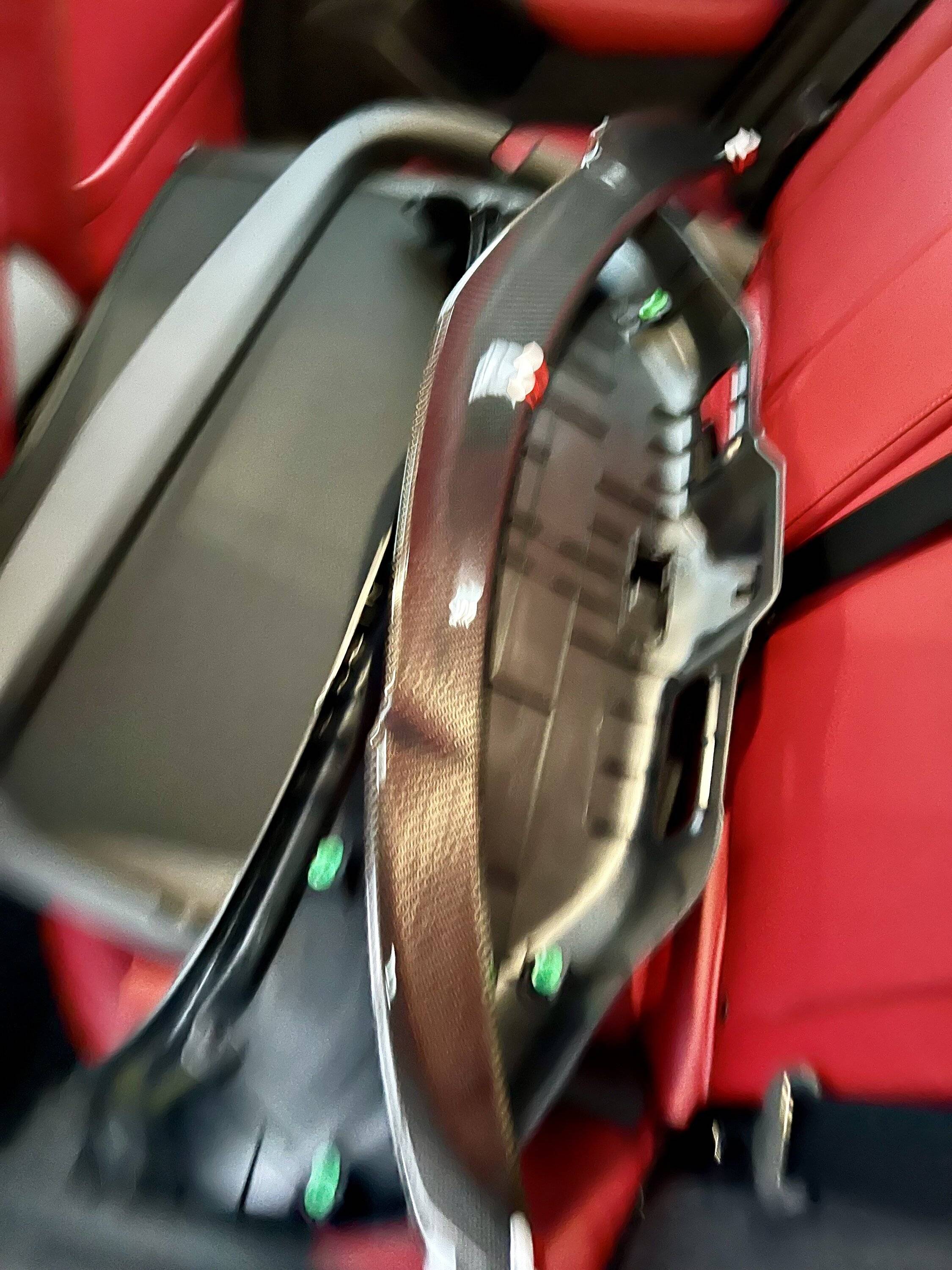

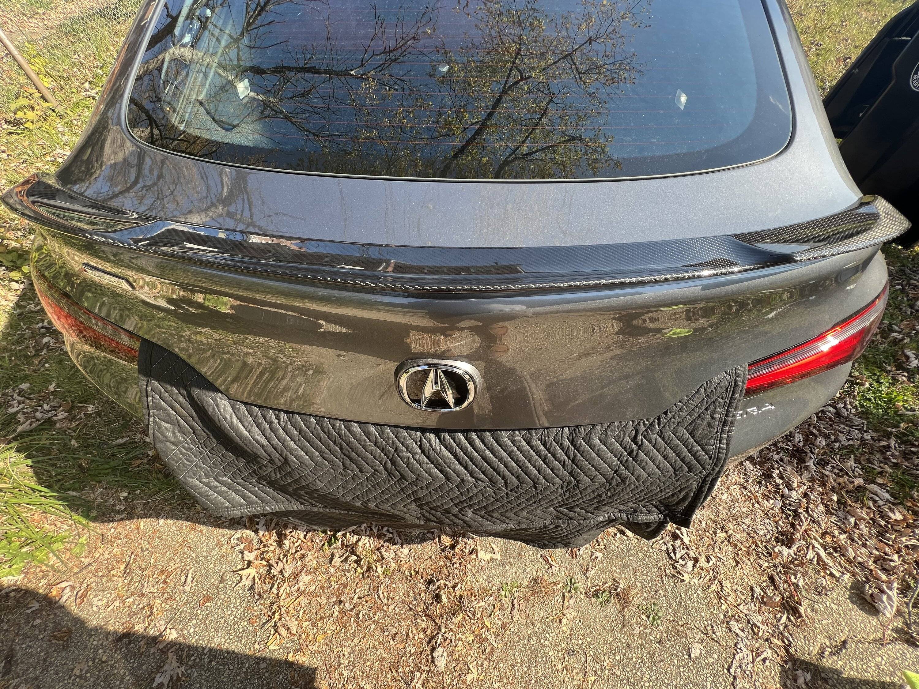

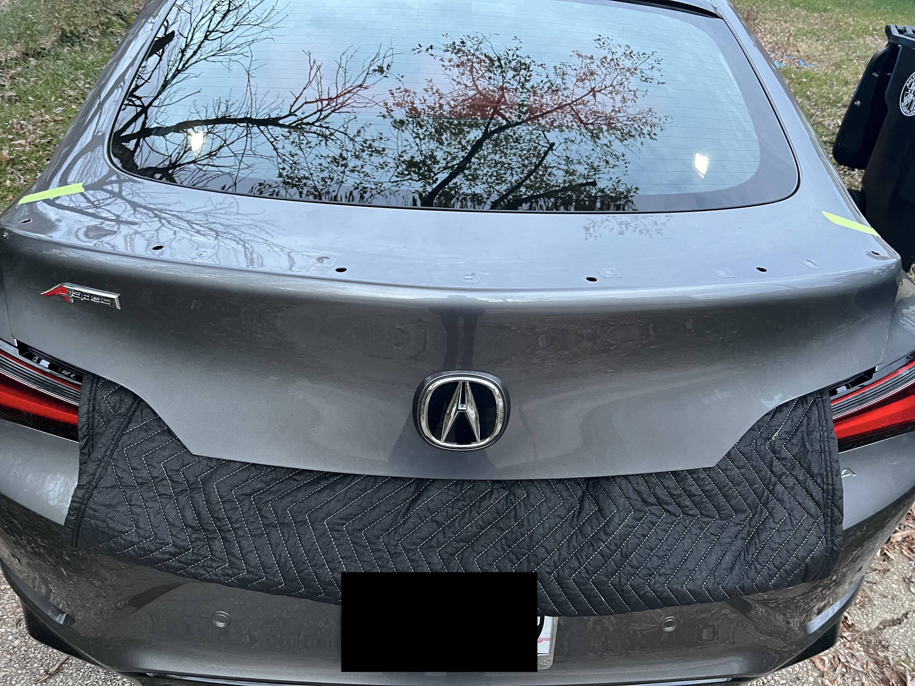

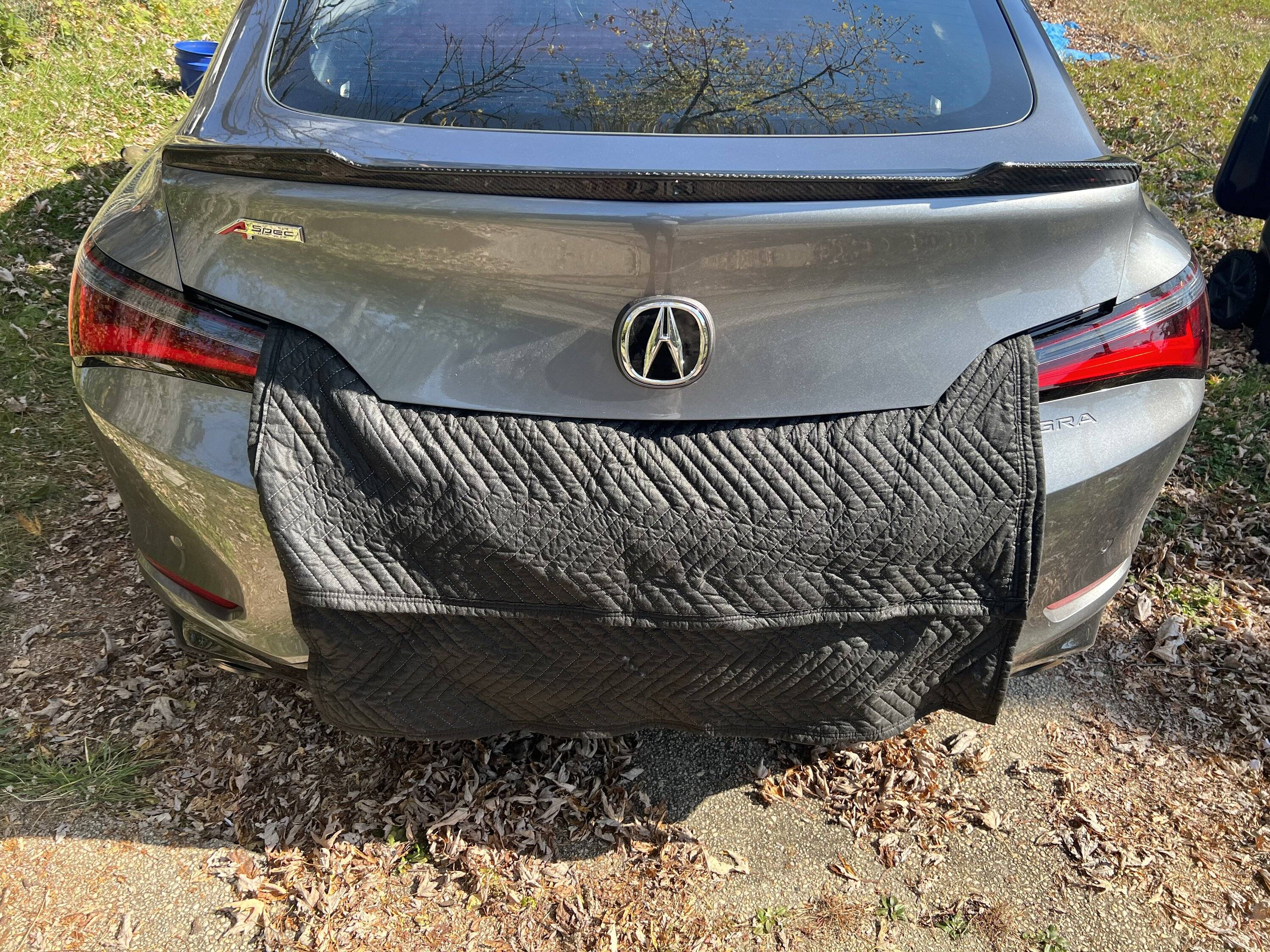

Ordered the carbon spoiler, the sideskirts, and the rear diffuser through the dealer to be installed. After a week only 2 of the 3 arrived. I was told that the spoiler was backordered. I looked at it as a sign that I shouldn't pay their insane part/labor charge. Ordered the spoiler from myacuraparts.com and had it overnighted. Studied the instructions and the ahc garage install videos for several days. FYI for the 2024 models. The instructions say that you need a 10mm socket, but it was actually an 8mm deep socket that was needed. Also, thanks to forum member koatic who pointed me in the right direction for the drill bit. The whole job took about an hour, mostly because I was double and triple checking.

Did mine yesterday as well, very easy and definitely not worth paying the dealer that kind of money. It takes only 2 screws and a trim pry tool to take apart everything except the spoiler itself. The spoiler itself is fastened with two small nuts, both of which I dropped into the tail gate but was able to easily retrieve out the by removing the grommets at the top end. I bought fishing line specifically to help cut the adhesive, really its only taped heavily on the first couple inches, was easy to get through with the fishing line, I imagine floss might have worked too.
The CF spoiler goes out without the nuts, just with the pre-attached double sided tape and some zip ties which are integral to the spoiler, this probably means it can't be removed and reinstalled again, also for me the zip ties didnt pull as tight as I would have liked but it looks nice. My car is blue, the spoiler goes nice with the gray wheels, I imagine on a gray car like yours it also looks really nice.
Anyone considering doing this, as long as you can get past putting a drill to your new car this is very doable by a DIYer.

Yeah hardest part was getting over the fear of drilling into a new car!
Looks good on the LCM. 👍
As far-as wear I still have to do the ceramic coating which I will get the spoiler. Hope that helps.
