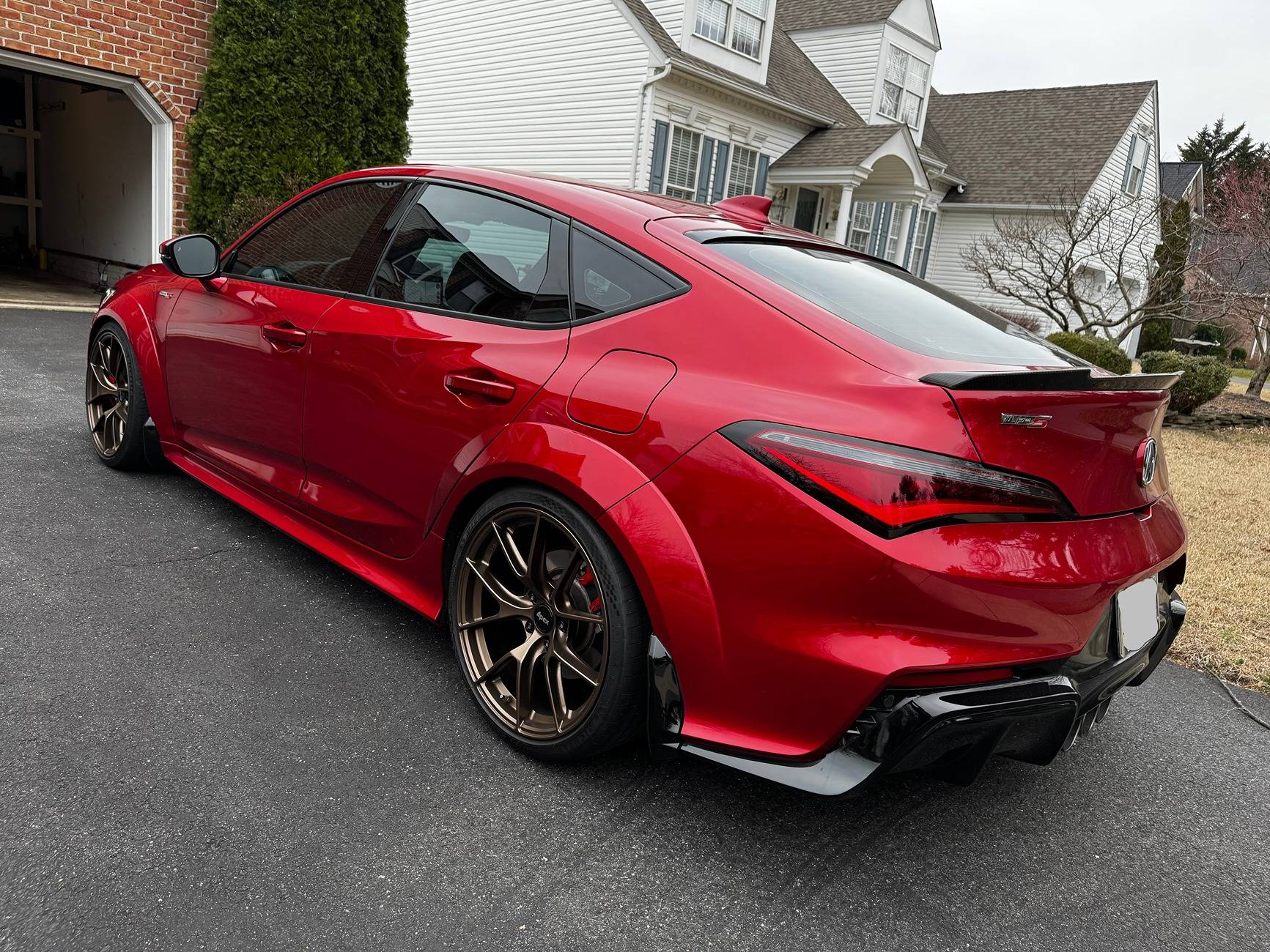

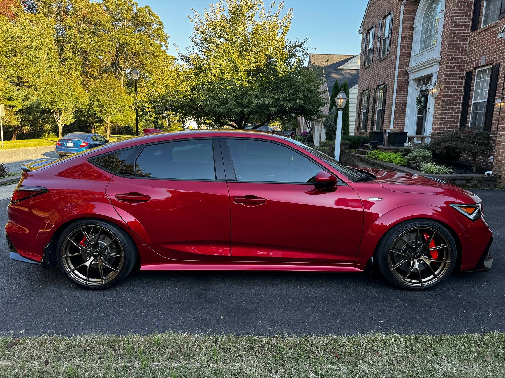

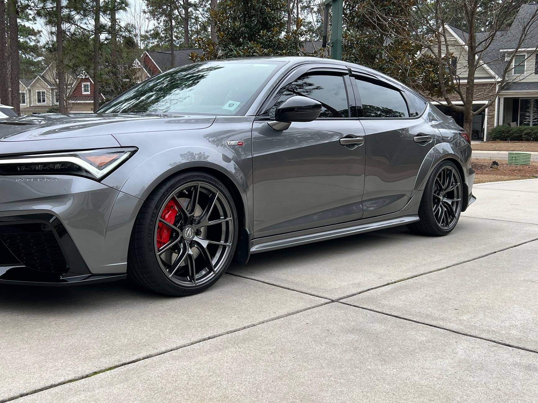

He was my inspiration for the Apex VS-5RS I have now. His are anthracite, mine are bronze:
Acura Integra Help deciding between springs or coil overs? 1743799332842-dn
Similar angles, OEM vs wheels/springs/camber adjustment

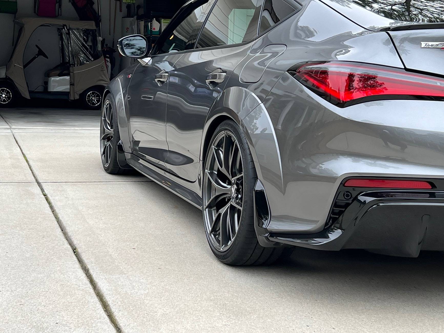

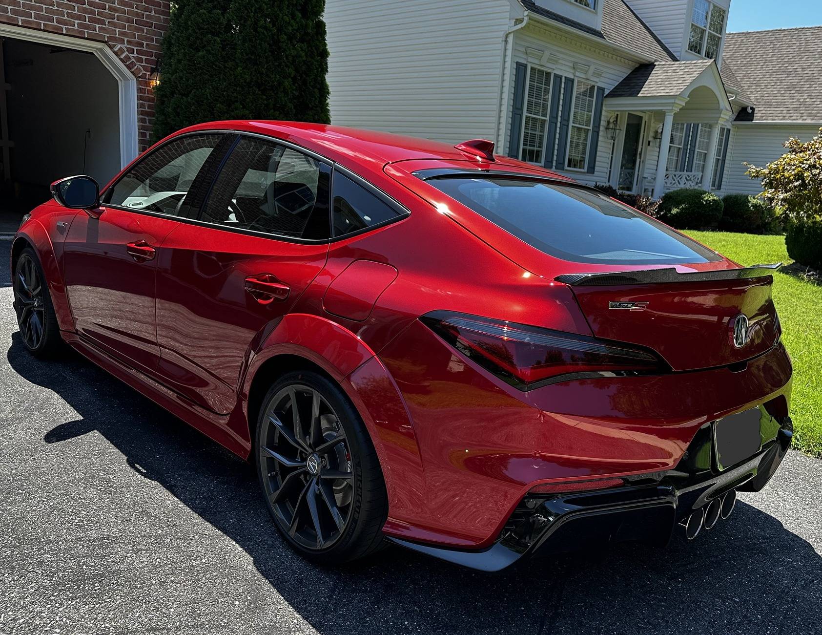

Optronix answered it! I would trade cars with him too. Love the red and bronze look he has going. I kind of think split spoke wheels just look right on this car. Same exact setup.

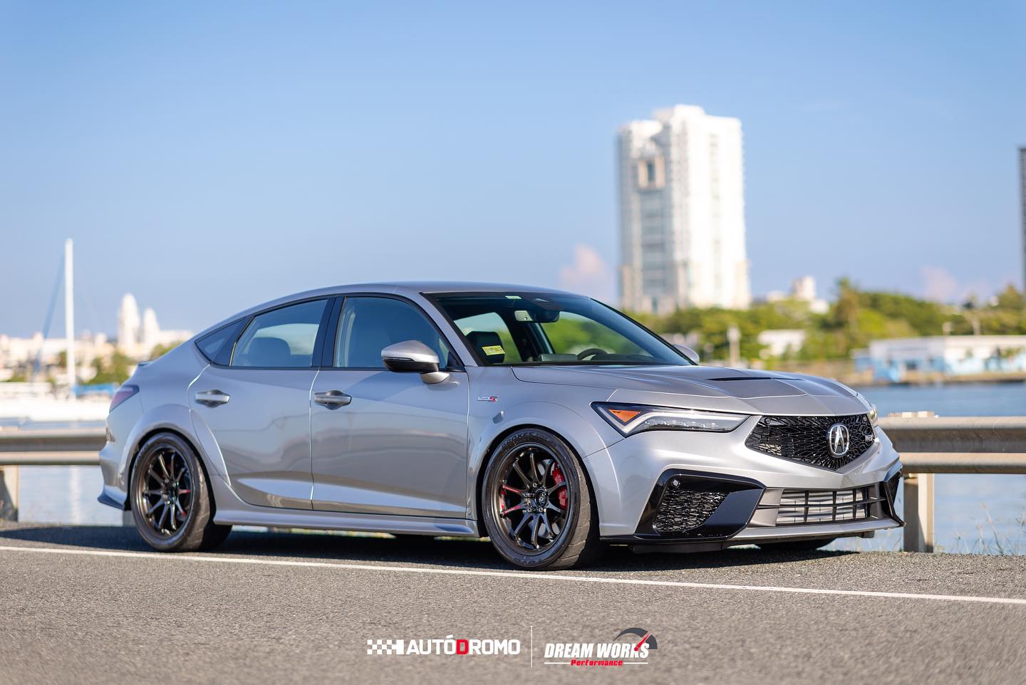

I also love the CE28. I've seen them on a few cars and they look fantastic as well, even in 18s.
