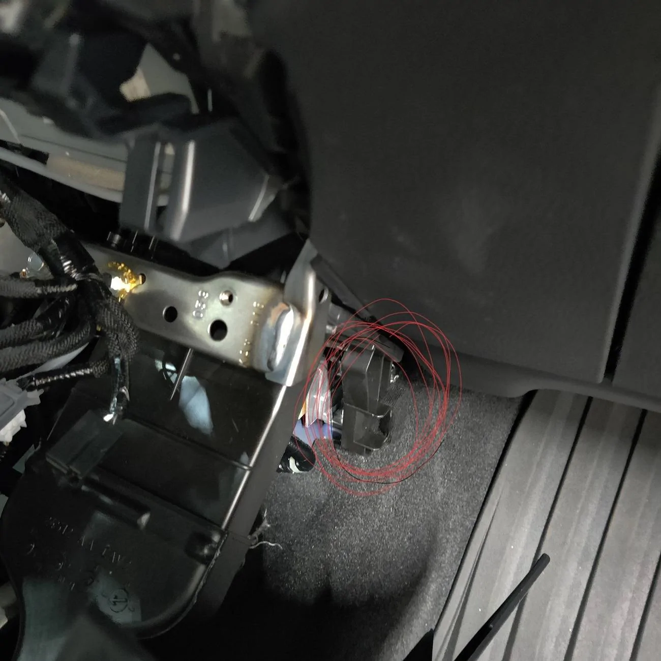

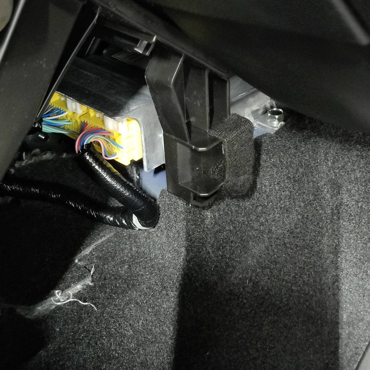

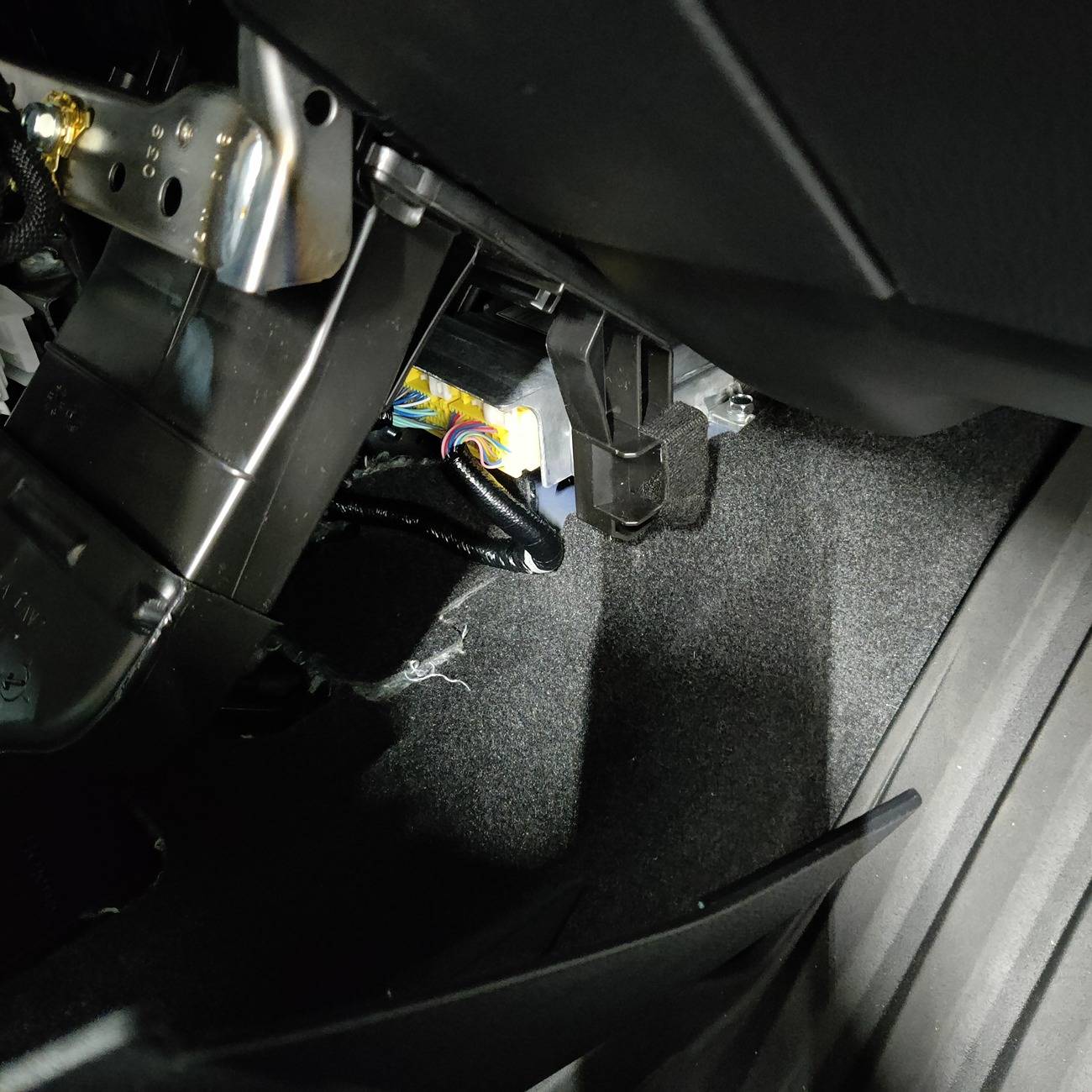

Wanted to check in with this thread because I had a similar rattle from the passenger's side at around 2200 rpm when the car resonates most. The rattle sounded kind of like a loose washer. Check the passenger's side kick panel towards the front. Tap the panel at various places to see if it has any play or if it's tight against the center console.
Mine was a little loose so I took apart the kick panel (see hybrid racing short shifter install instructions) and added some felt tape around the bracket that the kick panel hooks onto. No more noise and the panel is tight against the center console now!
