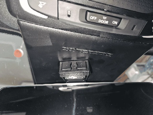

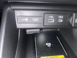

Here is how I am doing it in my ITS. I used double sided tape to attach the small remote on the top edge of where the phone charger is. It is somewhat discreet but still very accessible. I programmed my garage door to be the first and largest button so it's easy to push to open and close. Hope this is helpful.
I did the exact same thing! Great minds think alike!

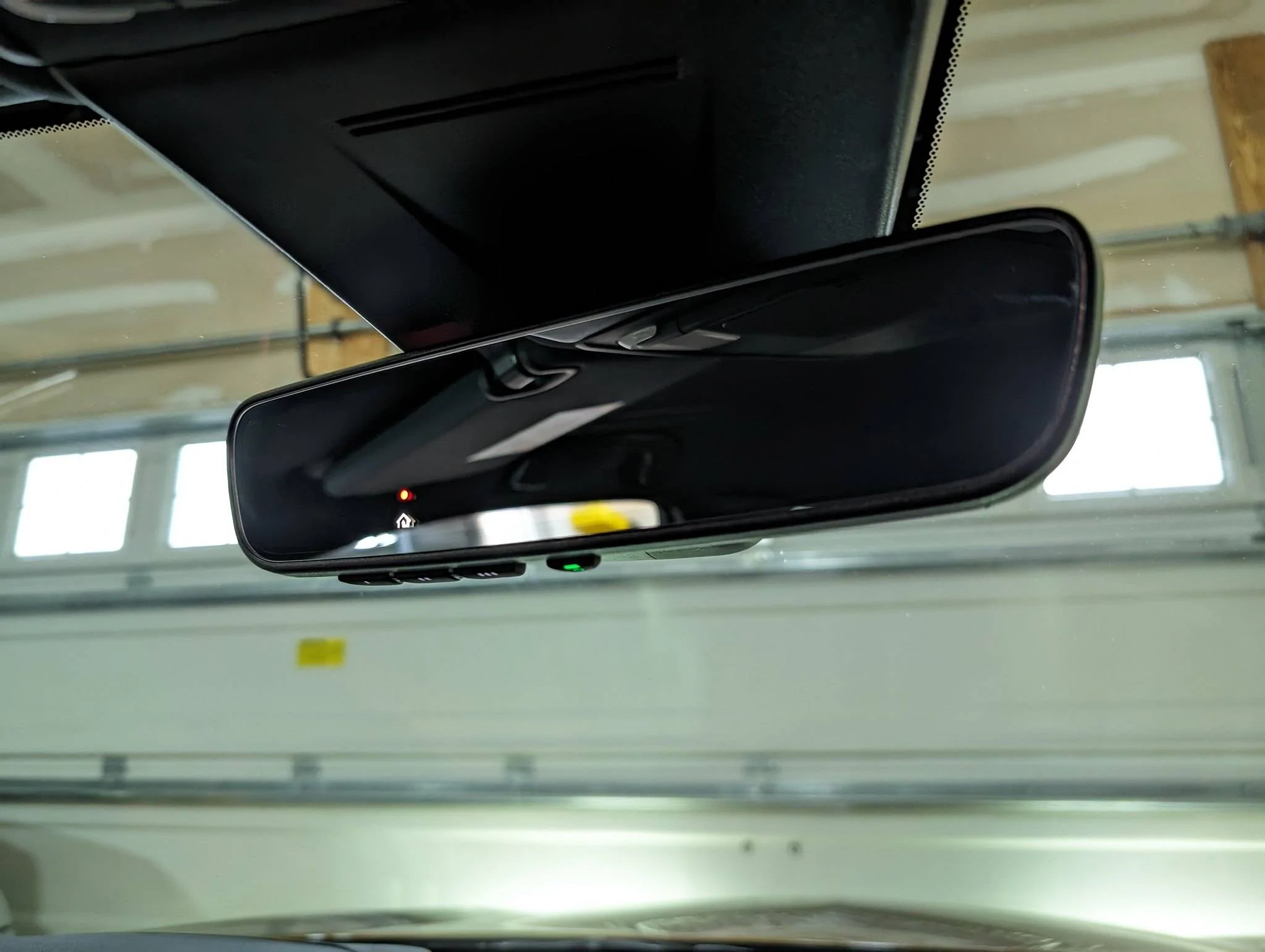

Just installed the Accord mirror with the harness. Overall wasn't bad, but I've done this for multiple cars so I'm familiar. I would rate it 4.5/10 for difficulty. Was a bit harder for me since I have the FitcamX installed and the cables got in the way. Definitely worth. One small difference is that the Accord mirror sits higher than the OE mirror, so the bottom of the base is a lot more visible now.
Any issues with the mirror location? I'm about 90% sure I want to go this route.
jchall30
Oct 13, 2022
126
89
KY
I’ve done this as well and have no location issues with the Accord mirror. The base does show just a bit more but for me it’s hardly noticeable and now I don’t even pay attention to it.

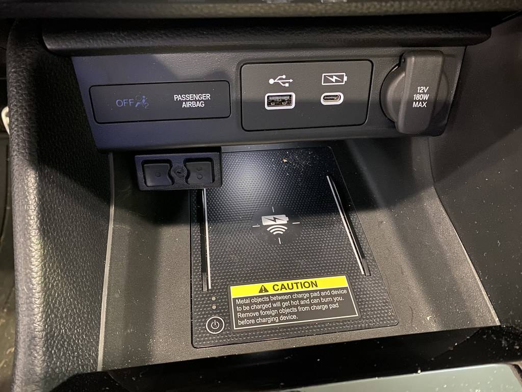

Found a solution with the overpriced Homelink button "cartridge" that is 100% reversible if I change my mind or battery needs changing. Unit is snug up against the back wall of the charging area so pushing the buttons doesn't move it. It is attached with 3M Dual Lock. Doesn't interfere with phone charging at all. Looks better than a stupid garage door remote clipped to the visor:

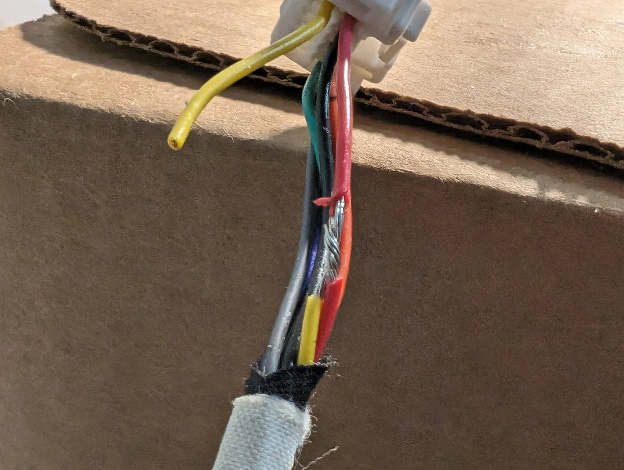

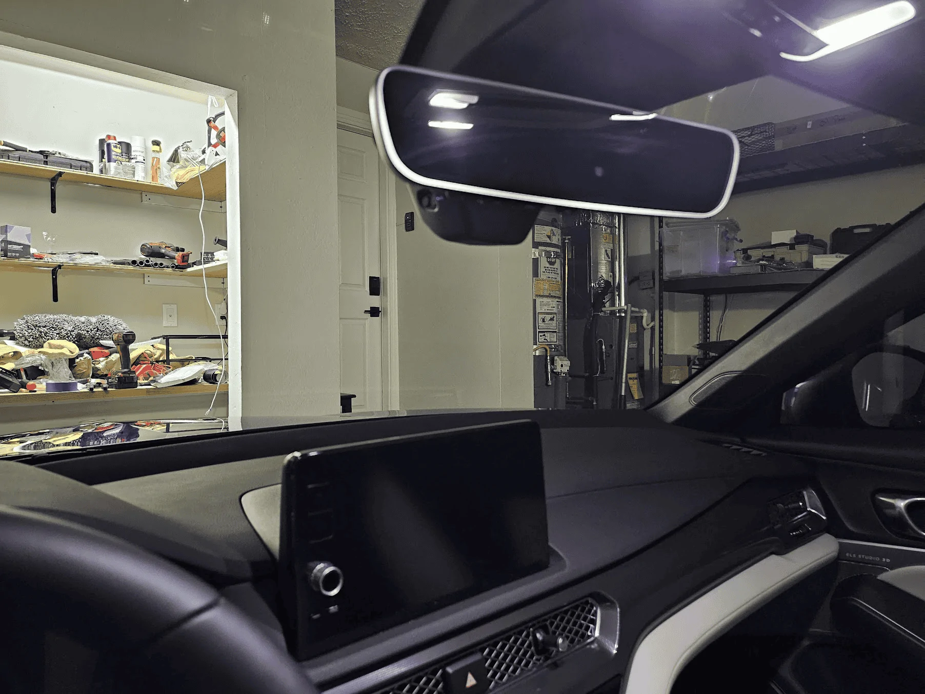

I located a crashed 2023 Civic Touring at LKQ and got that Mirror with Homelink for $125 in excellent like new condition. As previously noted in this thread, this is Honda part# : 76400-T20-A11 and uses the exact same plug and the same stem length/angle as the Integra's.
I didn't care for frameless and I didn't want the Accord version [part# 08V03-3A0-100] as it sits further out and higher up revealing part of the plastic trim behind it. I will say, that if buying new, for whatever reason the Civics HomeLink mirror is a heck of lot more expensive that the Accords.
To be honest, the frameless has more of a silver non-reflective trim which is the same thickness as the Civics black frame. I mean it isn't as thick as older Gentex mirrors [which my Nissan truck has, now that's a thick frame!]. So to my eyes the difference between the Integra Frameless and Civics Framed mirror is not that noticeable since decennially speaking the mirror is the same.
I didn't have any pin jumper wires, but was comfortable in cutting, splicing, and soldering.
I removed the tape until it reached the white section and then cut the yellow homelink wire (this wire is missing from the actual Integra's harness). Using a razer blade, I carefully stripped away the red wire insulator (red is for the dimmer) to reveal the bare wire. I stripped the mirrors end of the yellow and soldered it to the red wire. Wrapped electrical tape around that, then wrapped some insulator electrical tape i had laying around so that it looks as if the stock harness was never touched.
Powers when Acc mode, turns off when the car is off (just how I want it in the event I need to park the car outside overnight)

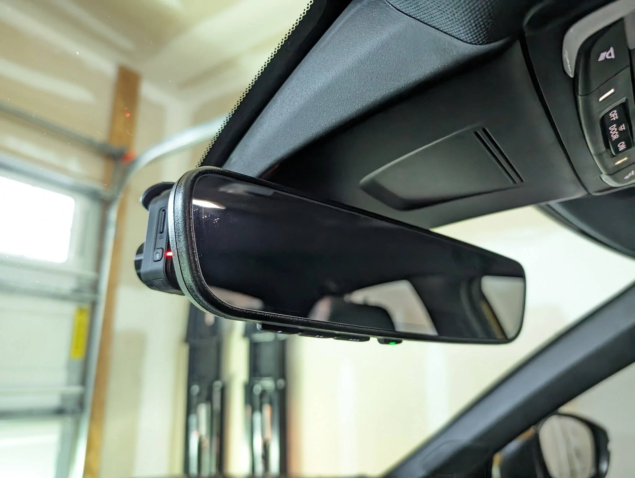

[FYI in the last picture I have the Garmin Mini 2 dashcam which hides nicely behind the mirror. I do NOT have this wired to the mirror, I ran new fused wiring for that to the fuse box]
