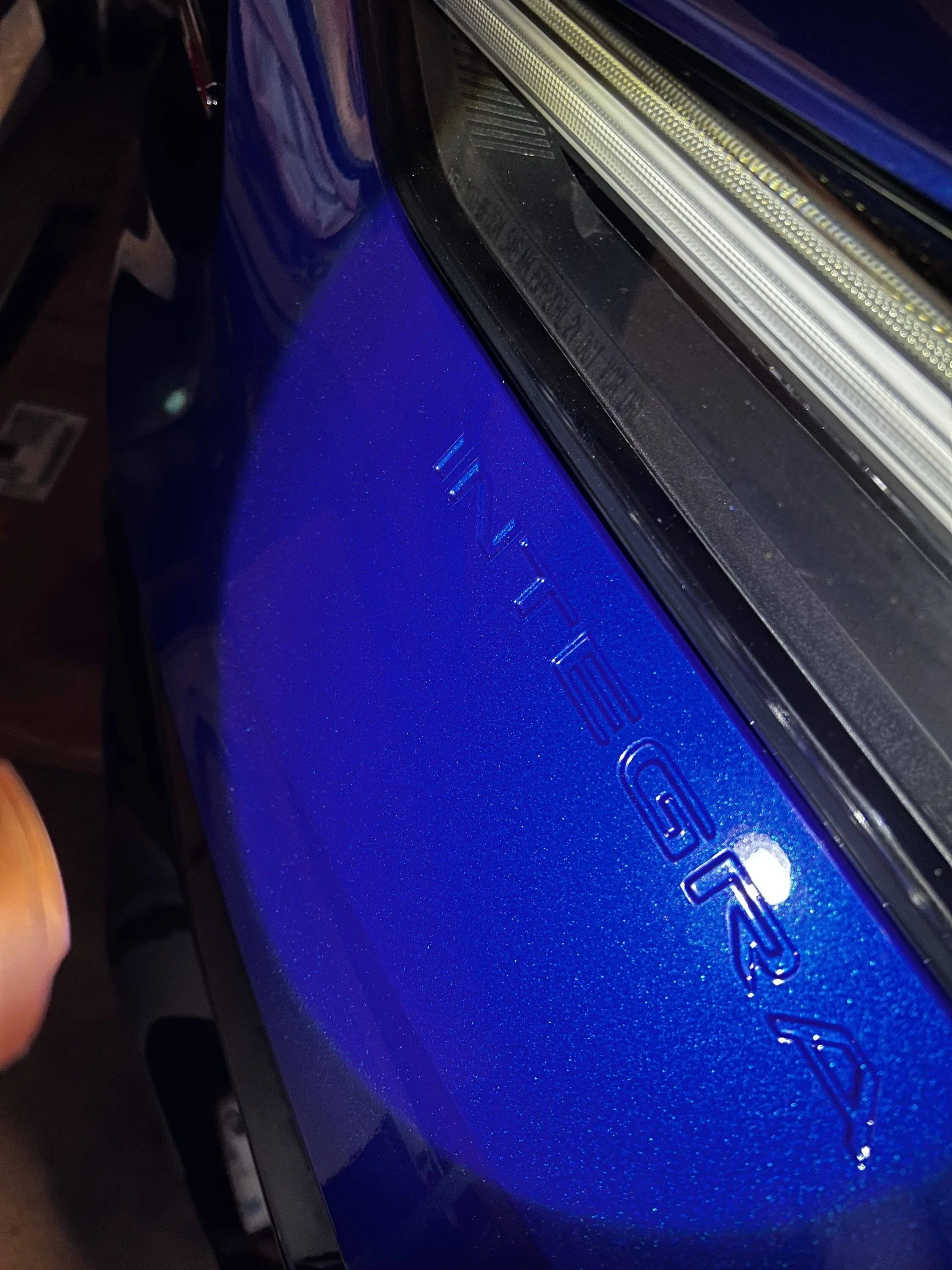

So I mentioned in another thread that I got a full front PPF done. The cost was $2K and was in line with what other shops in my area were charging when shopping around ($1.8K - $2.5K in LA area). I had the option of either XPEL Ultimate Plus or STEK Dynoshield and went with STEK based on the shop owner's recommendation when comparing gloss and orange peel. I believe he did also mention that XPEL however is somewhat easier for his team to work with.
Hood and fender were fully wrapped with tucked edges and they even removed the hood vent to tuck the PPF under it. I want to say there is a template available as they were able to lazer cut the Integra stamping and not do an ugly box around the logo. Where the bumper meets the hood was tucked, the bumper to fender line and most other bumper to trim lines were edge cut. I would say the most visible cut is on the piano black air duct trim where it was done in 2 pieces: one for the flat bottom portion and one for the top and side with the two meeting at the edge where the trim starts to angle upwards. I'll probably take a pic of this later to better explain.
Here is a pic of the cut around the Integra stamping, and it really isn't noticeable until you get up really close.

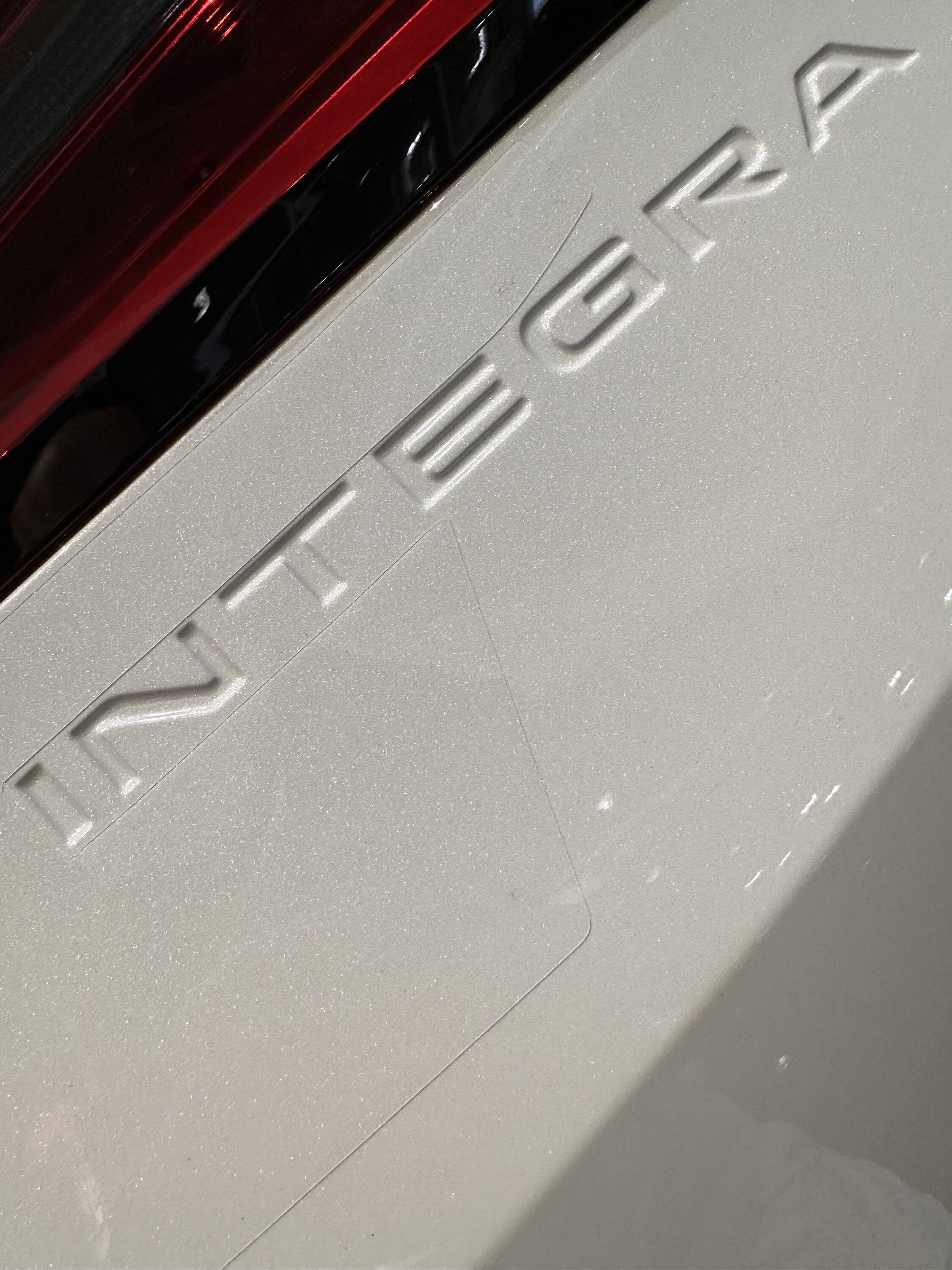

Just thought about this one, with the embedded "Integra" under the headlight on the front bumper, I imagine attempting to PPF the front is going to be a fun challenge either requiring to not protect that area, or have individual cutouts for each letter.
Tiny thing, but I regretted not protecting my Golf R when I had it, and wont make the mistake again.
Acura Integra How to PPF the front? 450553A2-1100-40C5-BD7B-4E406CFA147D
They just cut around it

If your installer doesn't have the templates, I'd highly recommend either waiting or finding a new installer. The template very closely contours the letters, is barely visible, and looks much cleaner compared to just cutting out a rectangle.
