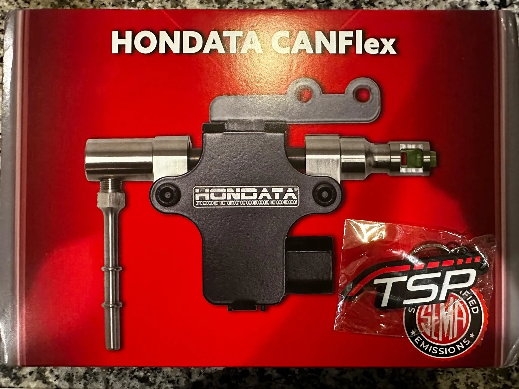

In my opinion the 4th and 5th mod would be high pressure fuel pump and a canflex unit. You can run ethanol at higher levels and make a ton more power.
