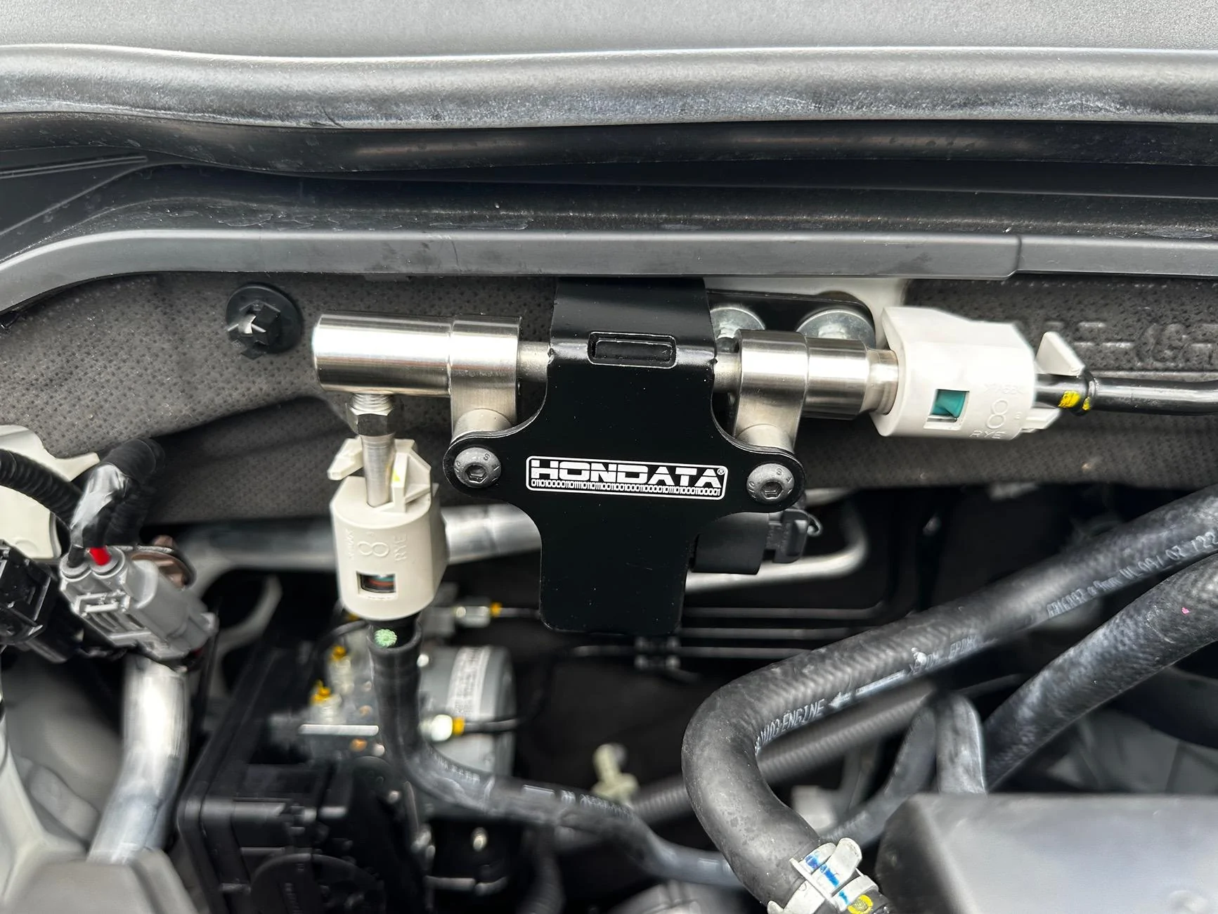

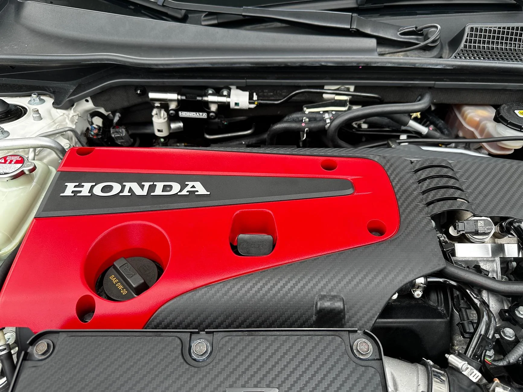

It is installed and working flawlessly so far. It will be time consuming to tune since I have to adjust all the tables since the base settings are for a Hondata OTS tune.
Good to see you are getting started with the CANFlex already. Mine arrives later today and can't wait to install it with the rest of my fuel system goodies.
It has been raining non stop here in my area so have not been able to test anything yet. And still have to clear the tank to start with e10 93oct. But hopefully it will move along quick.
