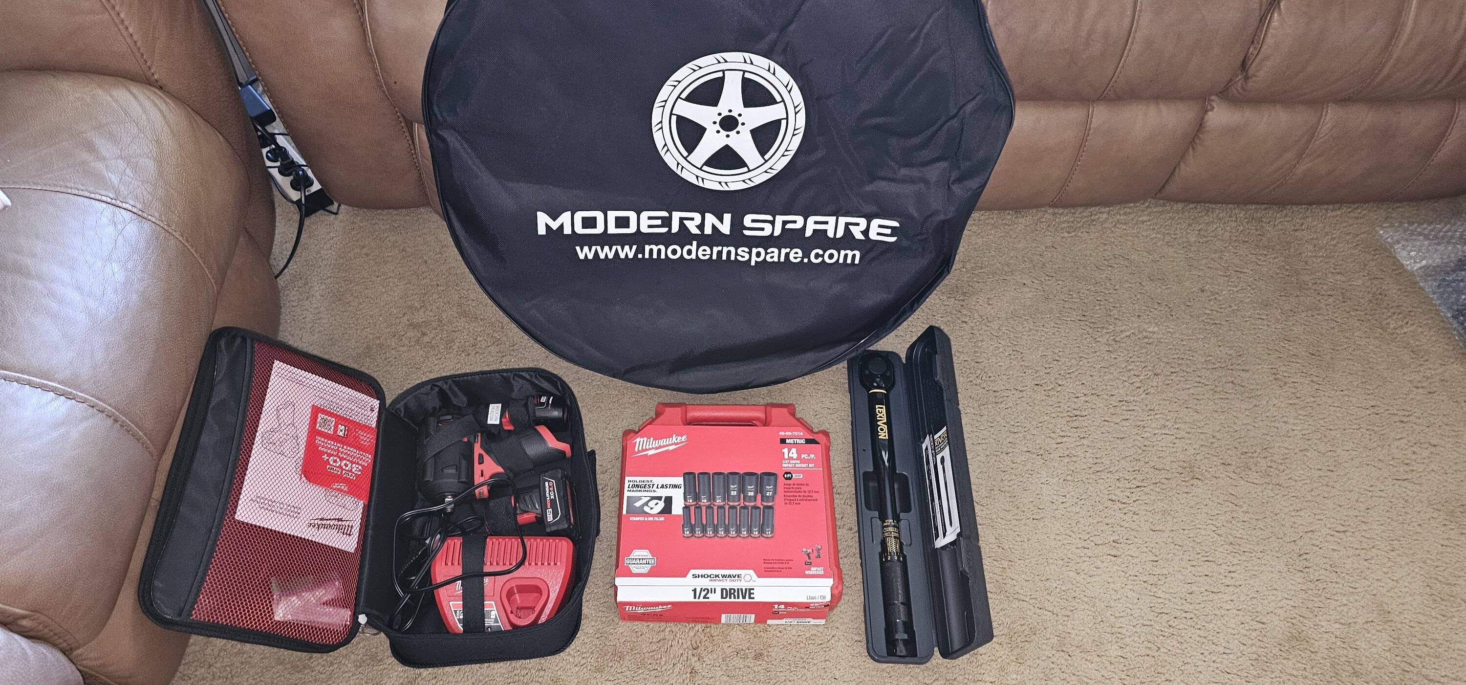

finally got everything i need for my wheel shenanigans. i didn't want to keep my full m18 + packout sockets in the trunk in case they get stolen, so they'll remain at home while i got the m12 with a small metric socket set and a cheaper torque wrench to actually keep in the trunk with the spare for roadside emergenices. wheel kit is complete!
Acura Integra Looking at getting a nice impact/torque wrench for lug nuts 20231108_090807
yes that is the silicon condom you can buy for the milwaukee drills lmao. yes i'm neurotic, and crazy, and an idiot.
i have seen that now. what about the lock lugs? i think the documentation that comes with them says 80 ft/lbs - is that also an error, or is that correct for those?
Howā€™s the quality on that Lexivon Torque Wrench? Would you buy again?
i actually haven't used it yet, only the precision instruments one. i got it mainly as a backup, or if i need to throw one in the back of the car
Iā€™ve been looking at those but Iā€™m hesitant about non expensive wrenches, scared the calibration will be off and Iā€™ll shear bolts
623
398
The calibration will almost never be far off enough to shear the bolt. You can certainly over torque it and stretch the bolt, but for a typical bolt that's going to be 25% more than the rating.
You're actually far more likely to be off due to using an extension that isn't designed for the torque load or has so much play the angle is off. The click style wrenches can easily read 10-15% under with a 6 inch extension that's not being supported properly.
