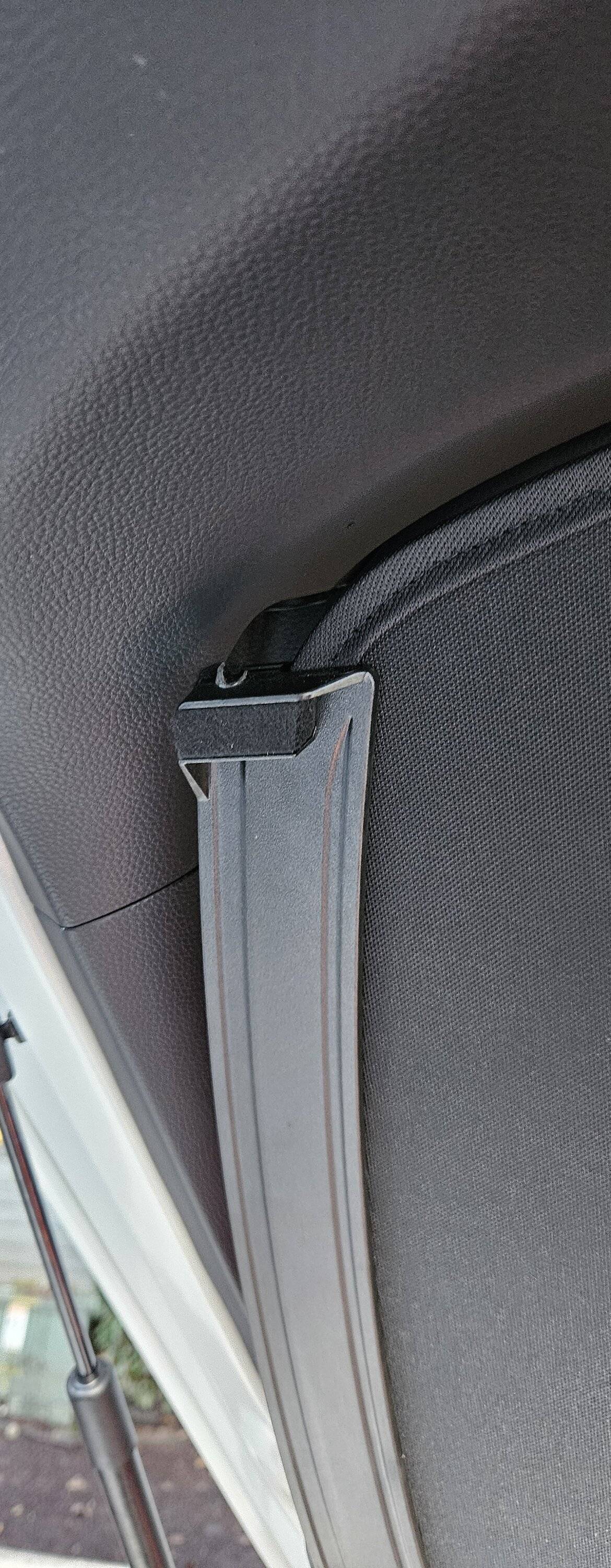

Integra Aspec w/Tech CVT
Acura Integra Rear cargo shade 1000034431
Here is the example of you want to be careful when plugging it in. I found mine broken and warranty does not cover as it is unsure how it was broken. I had my car tinted so they think it was that. Either way be careful as it is not covered under warranty

Anyone got instructions on removal? Getting tint soon.
wdrx02
wdrx02
Batman
Nov 27, 2018
145
Remove the top two clips. Then pull out the two bottom grommets do not bend them as they can easily break by force. Unclip the top two with your hands from the the hanger.
