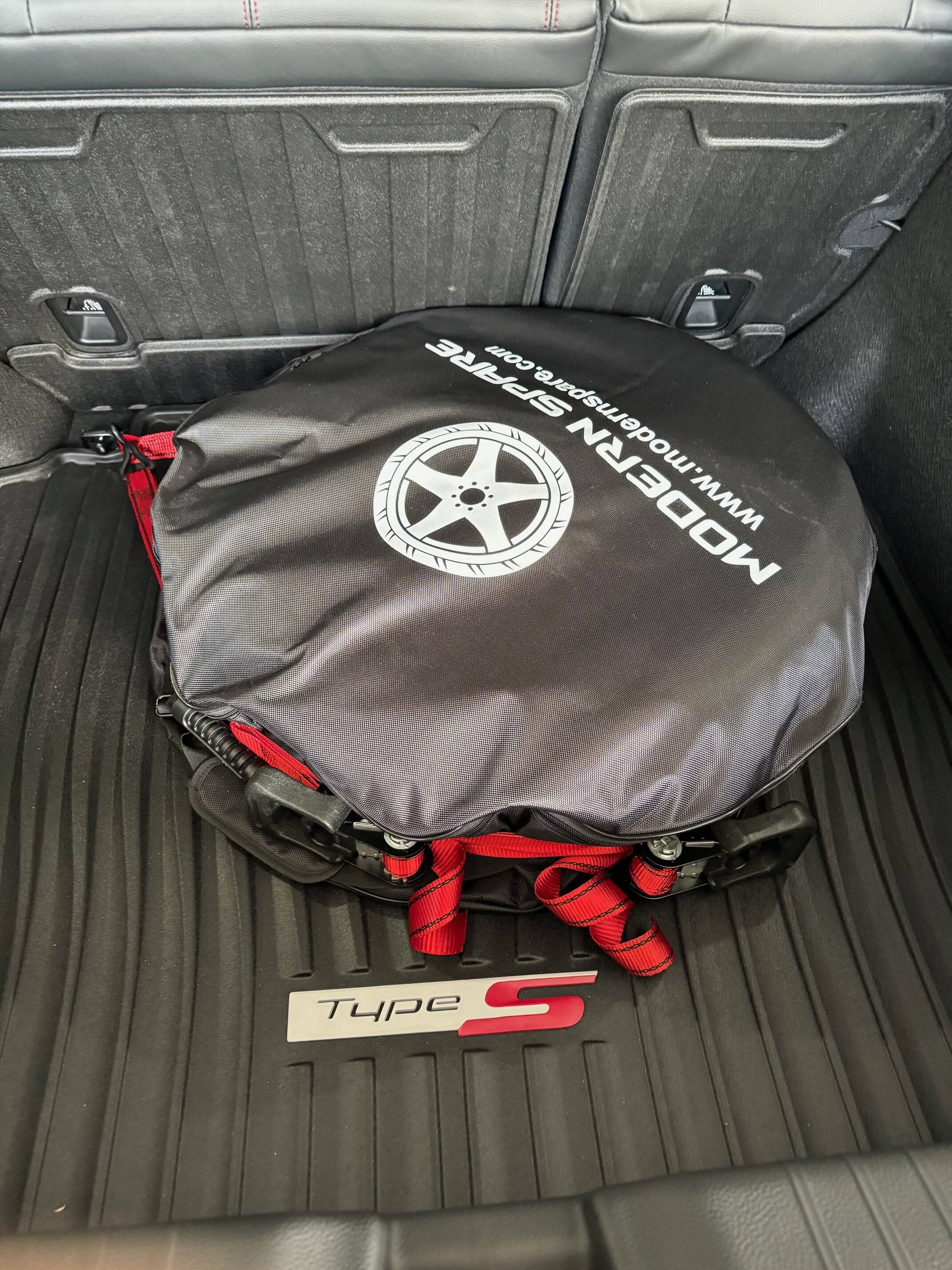

I am not a commissioned salesperson for Modern Spare but could not wait on Acura any longer. Hopefully there will be an OEM solution someday?

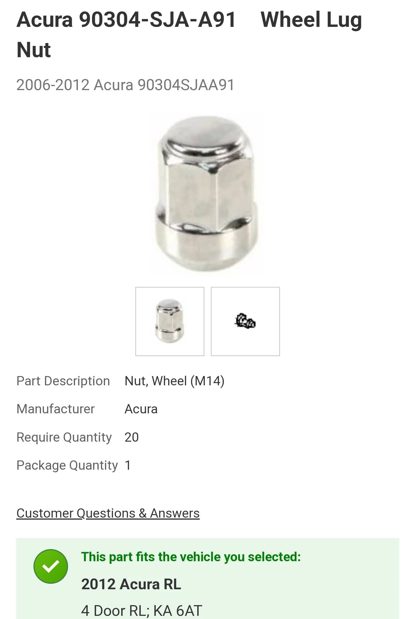

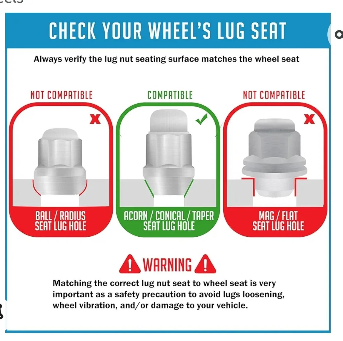

Hey @Frenzal sorry to bother you again bud. I remember you mentioned the OEM lug nuts wouldn't work, but to go with the stock RL lug nuts.
When I do an Amazon search for RL lug nuts I get back a bunch of generic results. Do you know what type of lug nut shape/spec I need to look for?
For example, this description is from one of the results:
Acura Integra Spare Tire Kit SmartSelect_20240113_085622_Amazon Shoppin
Edit: I think I found the part number
Part No.: 90304-SJA-A91
Acura Integra Spare Tire Kit Screenshot_20240113_103351_Chrome
Thanks again my man
Thanks again my man
The one on the right in the above picture. I posted pictures of the lugs themselves (see post #55).
Bought the 5 lugs from NAPA (canadian auto parts store) asking for Acura RL lug nuts. They were exactly what fits the RL spare tire and the thread is OK for the ITS studs (M14x1.5). I keep them with the spare in the trunk.
Perfect. I updated my previous post with the part number. I'll leave it up for anyone that's planning to go this route.
