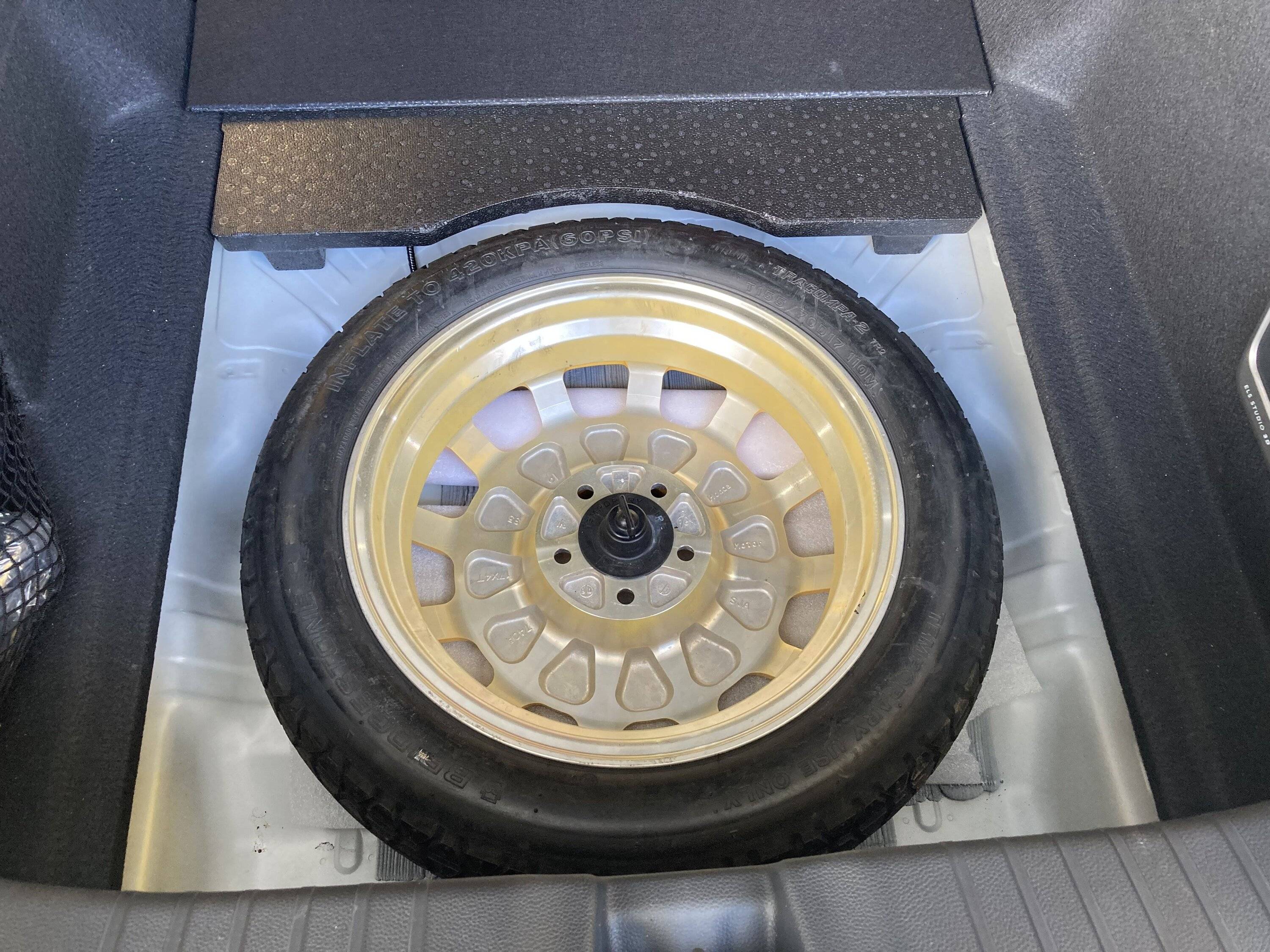

Here is the final result. Quite happy with it. Left is to put something under the tray so corners don't pry when something is in the trunk.
…When the tray is down, it doesn't sit flush anymore. It is raised maybe 1-2" near the tailgate…
Would deflating the spare reduce the remaining (~1.5 in?) floor board gap by perhaps a half inch or maybe even a full inch? ?
I typically carry a tire inflator in my vehicles anyway.
I have the spare tire kit, that I bought for my FK8, and the spare sits about the same.
I am going to try and deflate first. to see of it makes a difference. If not, maybe some foam strips on either side before putting the trunk tray back in.
No ideal, but I prefer a proper spare.
