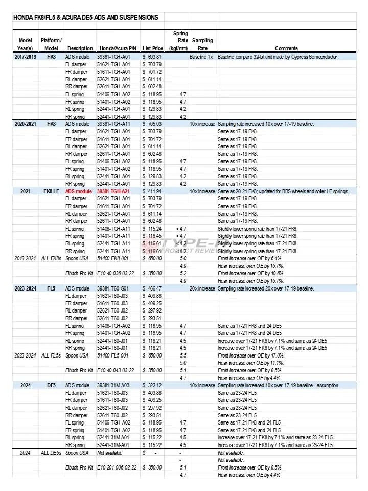

Here's info from Honda Product Type R
245
120
I've found with springs and coils that often the rates aren't published by the manufacturer and resellers just make assumptions or use posted numbers that are incorrect. Happened even with bilstein coils from what I've seen. Ohlins is typically accurate though.
If you have dimensions for the spring though, it's pretty easy to calculate. Thickness of coil, number of coils, diameter of the spring, and free length are typically all you need.

There are a few threads on here that do a decent job at showing visual examples of the various springs out there. I'll do a quick rundown off the top of my head of what I recall the general consensus to be for various springs I was considering; hopefully compete with something an AI would spit out.
Spoon Sports- was my first choice, but availability may be limited. Expensive at ~$650 vs most other options falling in the ~$350 range, but owners have raved about the ride quality and on-track performance. Spring rates according to the resources in this thread suggest are substantially higher than the OEM and Eibachs, but are progressive rate so ride quality is not severely impacted. Introduces a "reverse rake" where the rear appears lower than the front, but apparently this has been revised in later versions according to at least one forum member on CivicXI. The same forum member fabricated a shim that can correct the rake issue if you have the earlier versions.
Eibach Pro-Kit- extremely popular option, and what I ultimately went with. Availability and price are good. Ride quality is excellent; best way I could describe it is OEM+. Not significantly harsher than stock, but noticeably more firm in a good way, no rubbing or crashing whatsoever. Aesthetics also excellent; car looks like it should have from the factory.
Eibach Sportlines- lower drop than the Pro-Kit. Haven't heard many reviews on ride quality or performance but they appear to be only slightly less popular than the Pro-Kit so I'm sure someone can chime in who has direct experience, I know they're out there.
Swift- to my eyes, they offer the best visual appearance, with a slightly lower drop than the Eibach Pro-Kit and Spoon, not quite as low as the Sportlines. Some forum members have complained about harsh ride quality.
H&R- probably the most conservative option with the least amount of drop and the most compliant ride quality. Instructions do not require cutting bump stops, whereas all other spring options (that I'm aware of) do.
Fortune auto offers an adjustable spring perch but I wasn't interested. The guys at ACH garage have an install video but that's about all I know about them.
I'm pretty sure there are RSR and Whiteline options but again, didn't investigate.
That's about all I got.

I think it’s a fair assessment that swapping springs only is not ideal for track performance. Many would argue that springs with factory dampers would actively hinder performance. Personally I don’t think I’d agree… and I think most folks agree that the extra camber you get with springs (in the rear at least) would net some performance benefit. But end of the day I’m not a mechanical engineer; as long as the car is not made unsafe, I’m fine with the better “feel” on the street, and the aesthetics, which is pretty much what I bought them for. What I won’t attempt to argue with is that I’d be looking at coilovers if I was dead set on improving track performance. There are obvious cost and ride quality implications to consider there though, which is why I figured I’d give springs a shot before ponying up $4k for coils…
TL;DR, springs are a fun OEM+ type mod, but I wouldn’t expect to see performance impacted severely positively or negatively.

So here's exactly the argument of how they affect performance; the McPherson strut suspension gains negative camber as it compresses until the outer ball joint is level to the inner joint/pivot point. At that point, additional compression begins to create positive camber gain.
When you lower the car (without changing the suspension pickup point on the subframe) you gain negative camber because you've compressed the suspension some along its natural path. The same negative gain you'd have if the car leaned in that direction when turning, by that same amount.
If you cut your bump stops, you've moved the range the lower control arm will travel, which means more positive camber gain than you'd have from factory. That also means at the absolute limit of travel the lowered and cut car will have more positive camber than the factory setup, which is not good for performance.
You can counter the drop by increasing the spring rate so the car leans less and hopefully limits the travel to before the control arm passes parallel, or at least limits it to factory range as much as possible. The grippier the tire you out on, the less chance you'll prevent that roll since more grip means much more lateral g to push the car over. This is why, typically, to make a lowered mcstrut car go fast, you MUST add a front antisway bar to reduce that roll even further, or you must increase the spring rate further. The problem starts to become too much spring or too much bar reduces overall grip because nothing is helping "press" the weight of the car down into the tire efficiently over rough/imperfect surfaces.
My recommendation is to keep as close to factory height as possible and increase spring rate based on the tire you want to run, while also increasing camber to meet the tire's specific requirements. That will lead to best performance per buck you'll get out of a stockish platform. Otherwise if you want to improve suspension performance AND aero performance by being lower, you'd have to change the suspension pickup points, add a lot of castor, add a lot more static camber (while also doing an anti roll bar), or change dynamics drastically at the rear end (since it behaves differently).
However, for most people's aesthetic, road friendly, and budget friendly goals, I realize the above isn't always feasible. So if you're going to lower your car for appearance but want to bring the performance back in line, your best option is to increase negative camber even further than stock can do (the strut pin pulled is a good start, but more is likely necessary if you go very low (like 25mm lower) and cut bump stops. Then make sure you're picking a dual rate spring or a custom rate spring with a helper and likely add an adjustable arb if you're going to have very grippy tires.
Hope that helps :). Pretty much all of this is covered in more detail in this article, https://nasaspeed.news/tech/suspens...-track-performance-for-strut-suspension-cars/
