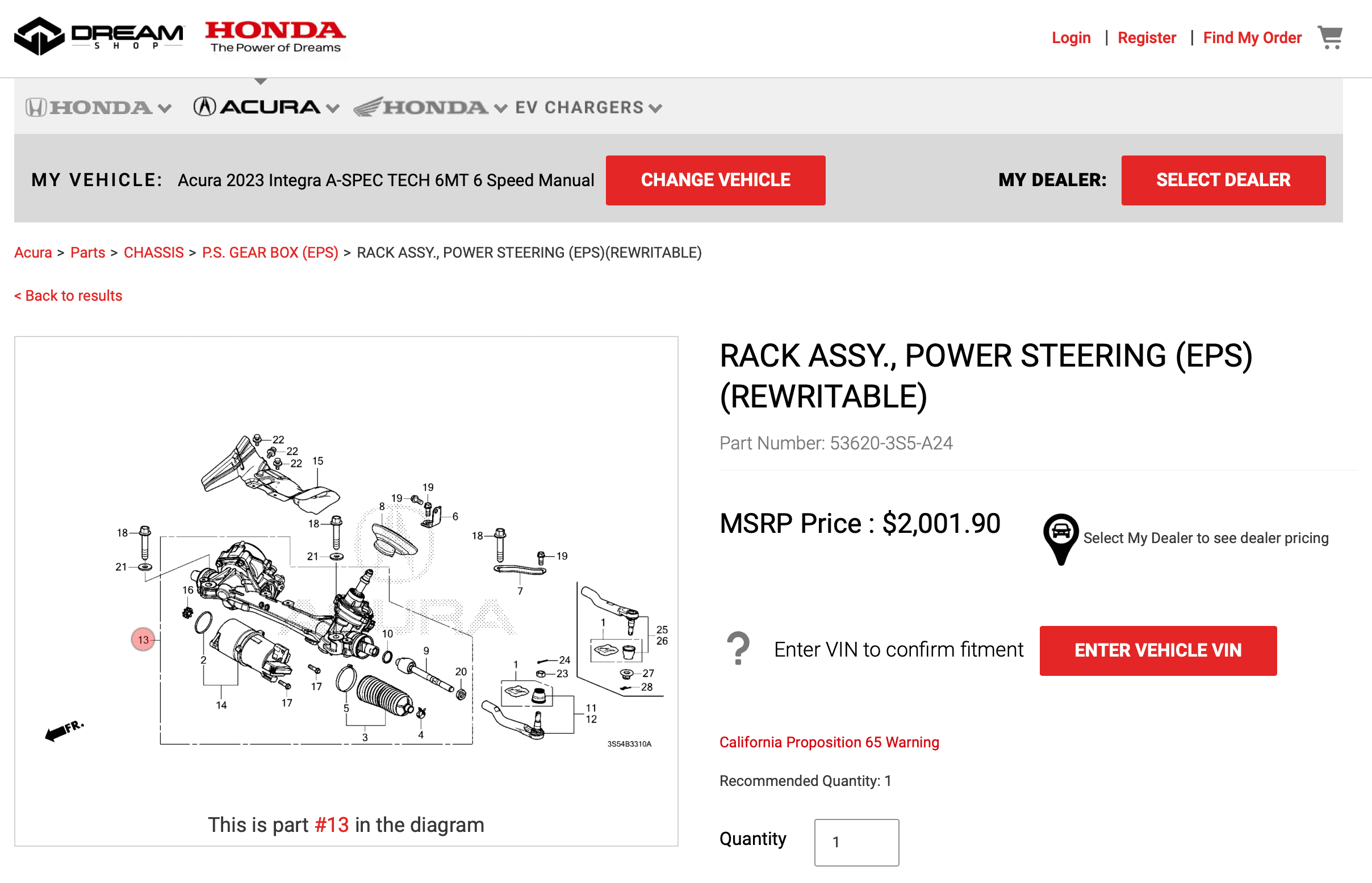

That's my understanding. I'm not a wrench, but I'm pretty sure when they say they're replacing the "steering rack" they mean the rack assembly. I don't have any detailed parts catalogs but dreamshop.honda.com lists a "13.RACK ASSY., POWER STEERING (EPS)(REWRITABLE)" for Integra and I assume that's the part the dealer is getting and also why they're not eager to eat the cost.
Acura Integra Sticky/Jerky Steering issue Screenshot 2023-10-24 at 10.06.22 AM

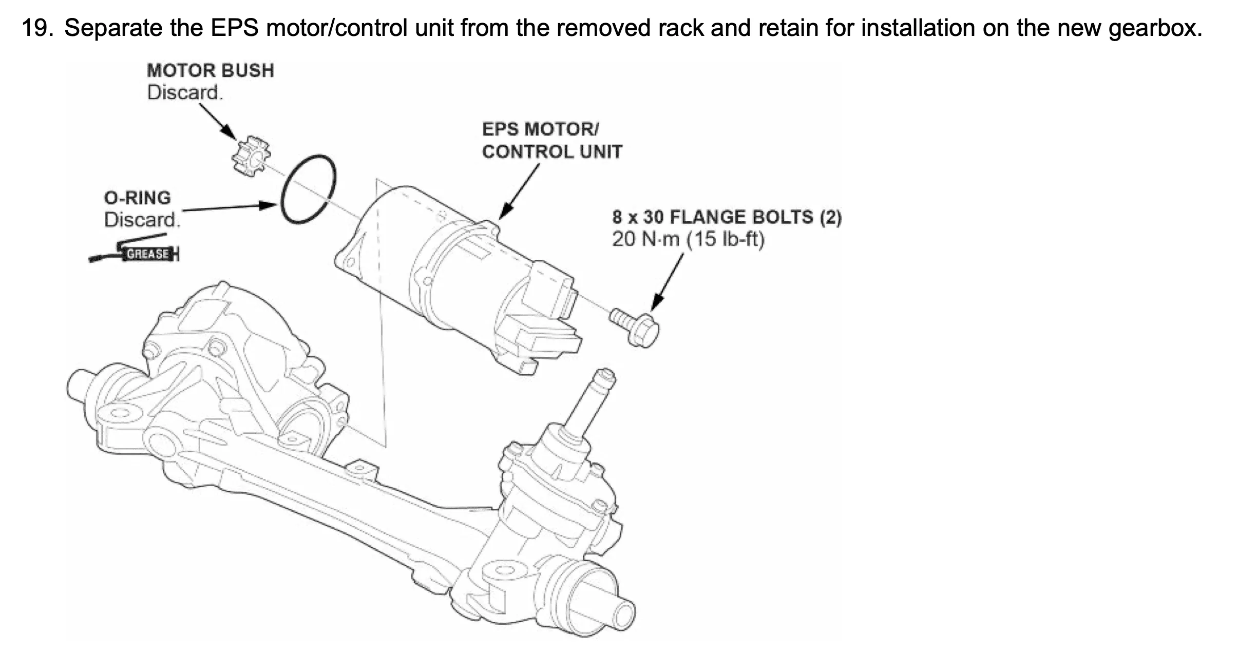

Reading the diagram, the $2000 RACK ASSY 53620-3S5-A24 would include the gearbox, motor (14), and other pieces inside the (13) outline. Dreamshop doesn't sell the Gearbox (53640-3S5-305) alone, they only sell this assembly that includes the motor. Below is a picture from the TSB showing the gearbox (lower) and reusing the motor.
Acura Integra Sticky/Jerky Steering issue Screenshot 2023-10-24 at 10.15.25 AM
Seems like they determined the gearbox is faulty and the motor is fine. So instead of replacing the entire rack, issue a TSB on how to replace the gearbox in the Civic for half the cost. Makes sense. Hopefully they do the same for Integra.
