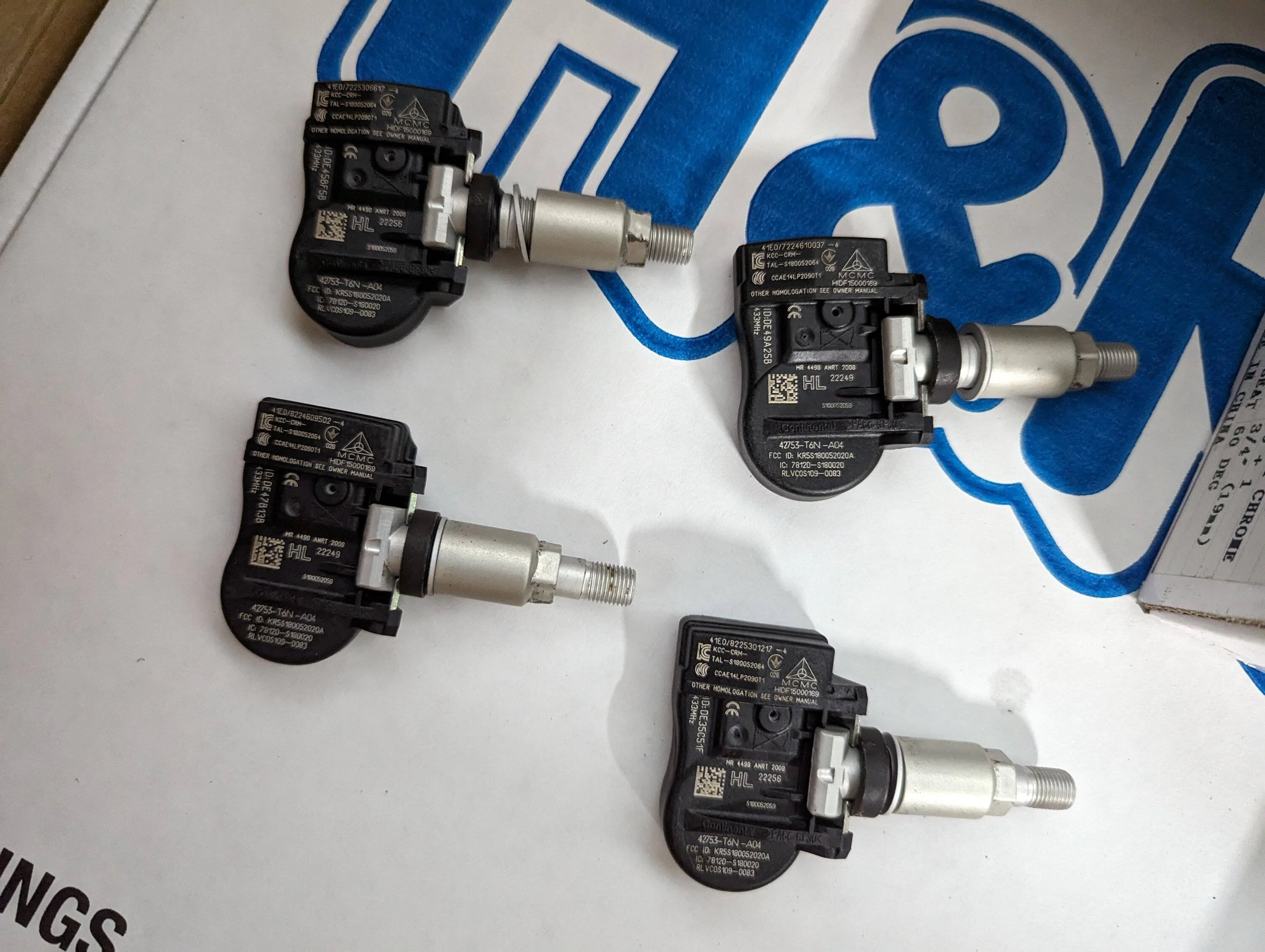

I literally just bought these today from acura parts dept.

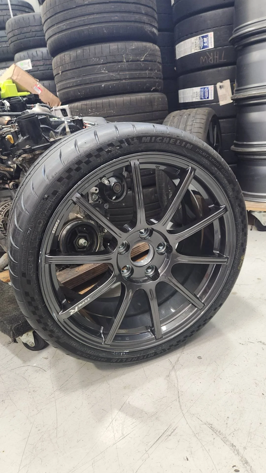

What color are they? I see a lot of diagrams when searching for the part, and found a few images with a light grey/silver color. Just wondering how they look with dark wheels.
they’re a light gray color, but if you get black tire valve caps it would blend in. Here they are installed on FL5 forged accessory wheels that I use as track wheels

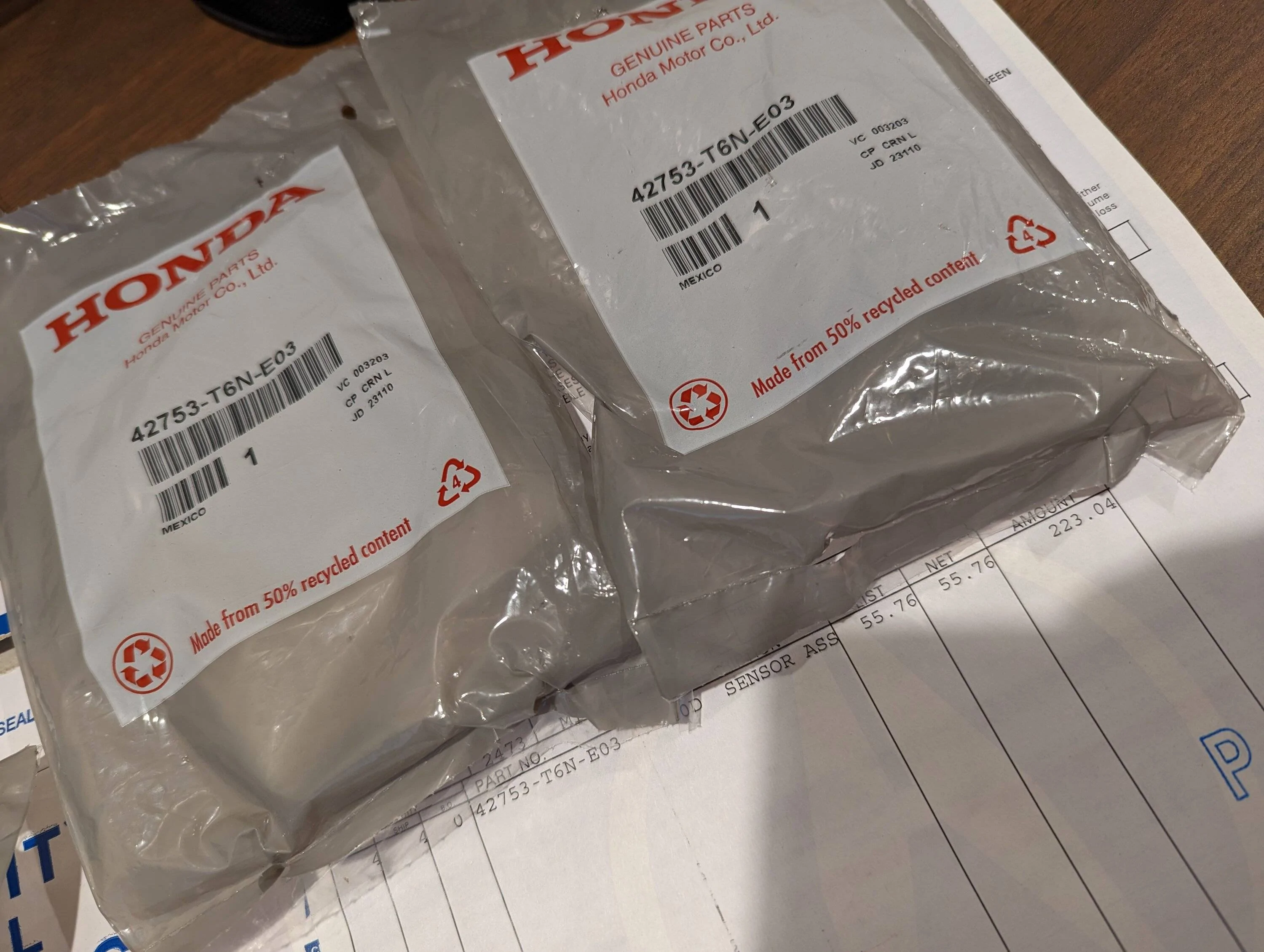

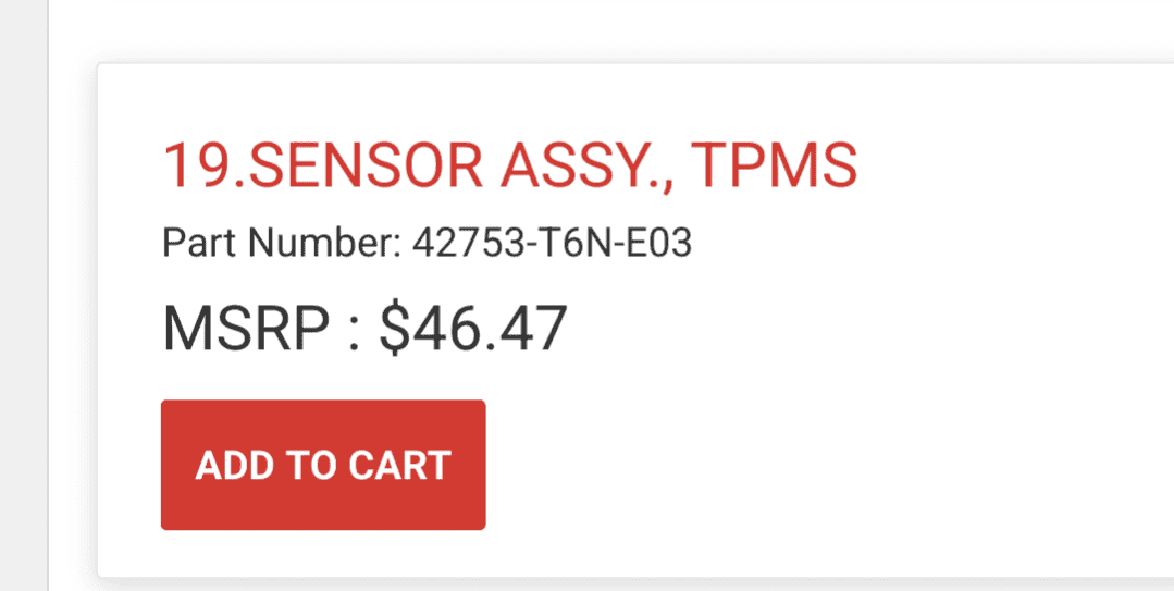

Thanks for the help! Since I knew the part number I got quotes from both my Acura dealership and a nearby Honda dealership. FYI - Honda was 30% cheaper.

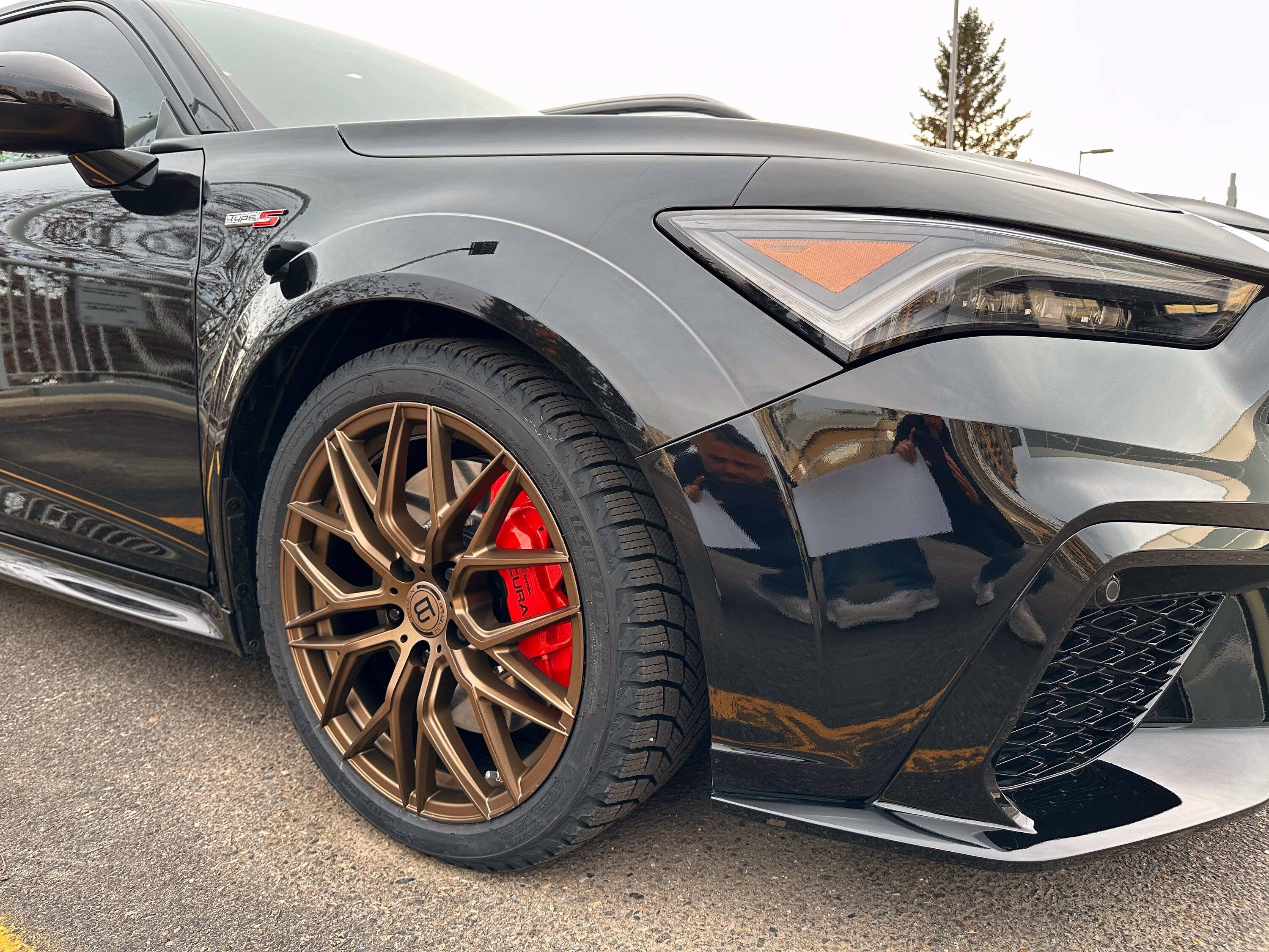

Since I have the shark grey OEMs for summer, decided to go bronze for winter.
Acura Integra TPMS info B446555B-A169-4F3A-9B86-FB4FC0774977
