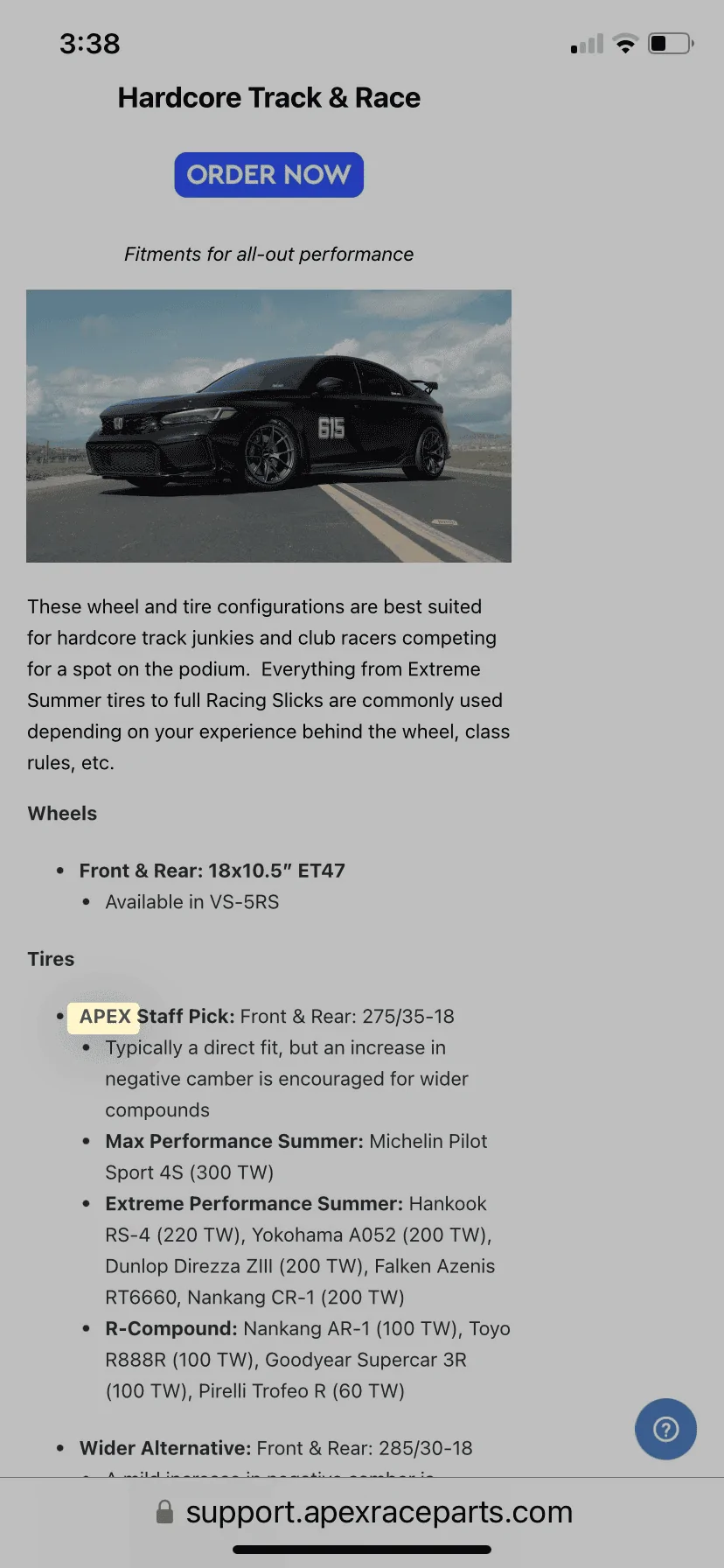

Aw shoot - Alexandre in the FB chat suggested around 275-35-18 @ ET 47, which these wheels are. I should've provided more specs.
So maybe 295, 30 thru 40 be a better fit.
Yeah unless you want to stretch them
Not sure how many have ran 295s.

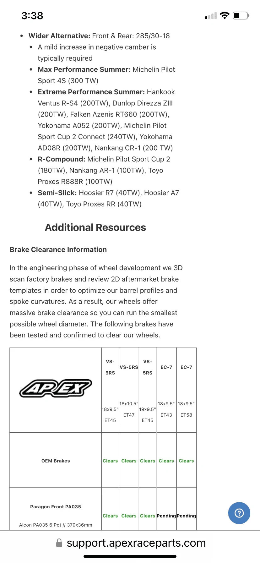

Well, now I feel extra dumb bc apparently Apex has a recommendation that I glossed over:
I saw that same article and forgot about it. So 275 or 285.

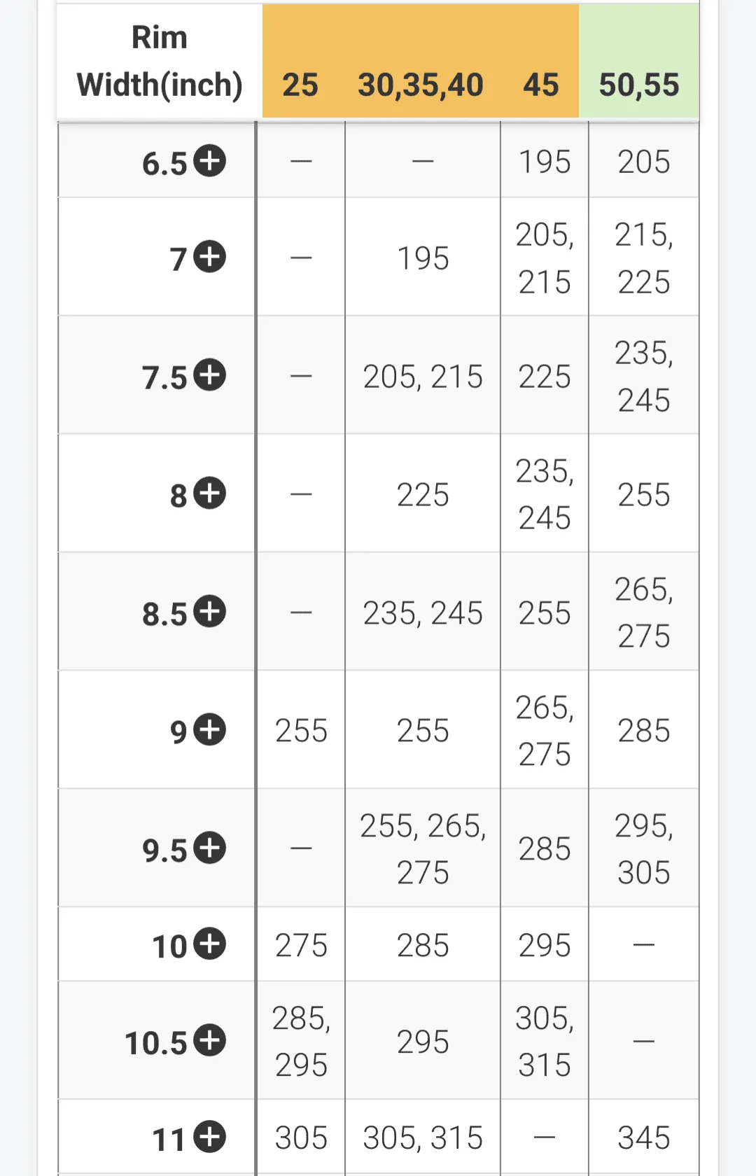

So am I crazy for thinking this suggests one could do a 275/40/19 setup using the OEM wheel? Assuming the suspension is OEM, this calculator suggests the wheel will ultimately sit 1.2" closer to the fender (it appears there's room) and the inner sidewall will be .2" closer to the frame (I assume there's room), though the speedometer will be off ~9%: https://tiresize.com/wheel-offset-calculator/
My reason for wondering: There seem to be better "Grand Touring All-Season" options in 265 and "Performance Winter/Snow" options (Blizzaks, even) in 275 for reasonable prices On TireRack, so something like this could allow me to use OEM wheels for winter while saving the OEM tires for a set of dedicated/aftermarket summer wheels TBD.
We get enough winter in central Ohio that I'll need to put away the OEM tires for a few months, I don't drive much (maybe 3,000 miles in winter?) and I can/will drive conservatively when I need to, and this is a secondary vehicle that can stay in during the roughest winter days... I can deal with the speedometer being off for a few months out of the year, but do you reckon they'll rub?
