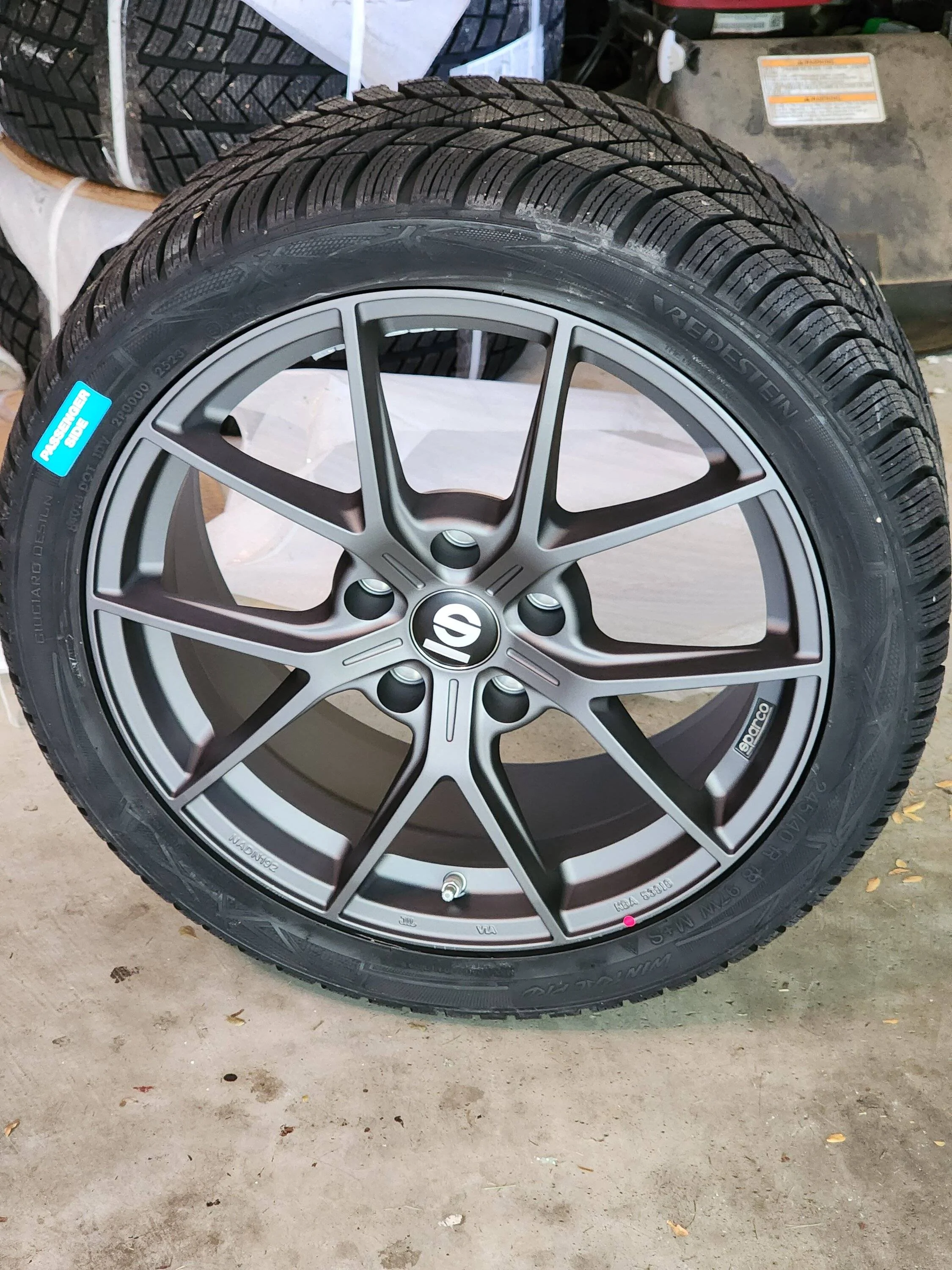

I also went with 18x8 +45 wheels (sparco podio) with 245/40/18 tires (vredestein wintrac pro) which i think should do well for winter.
