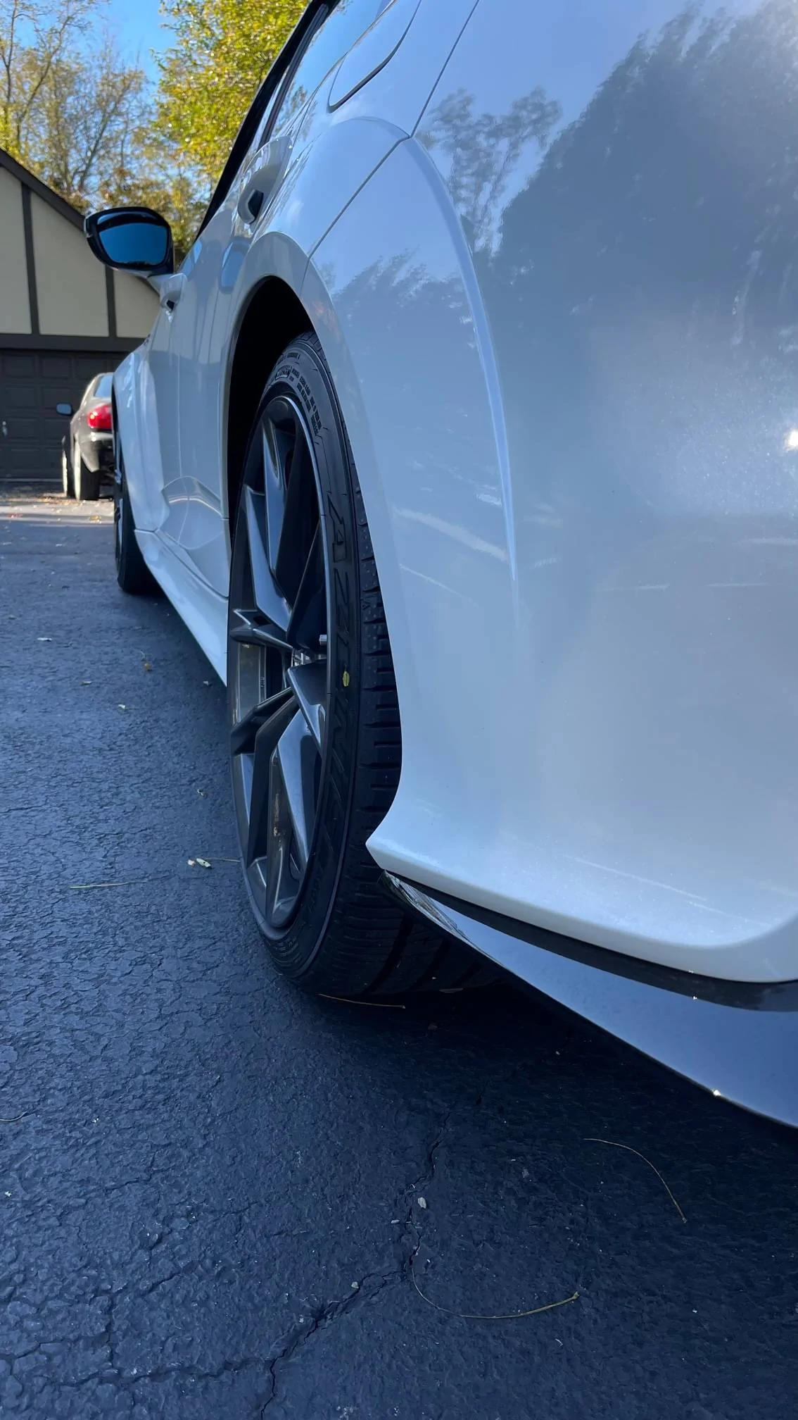

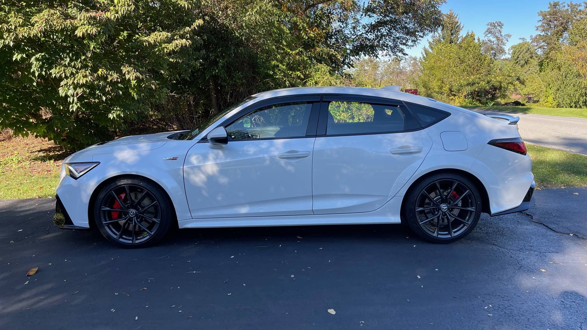

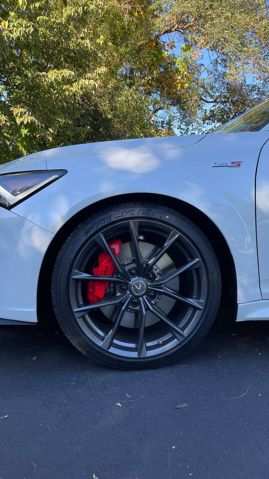

I bought 255/35/19 and will mount them next week as it’s been below 40 in the mornings and nights. I wanted to stay on the oem wheel and get aftermarket summer/track wheels. Also, tire rack had pirelli winters on close out for 160 so hard to pass on. Will ride a bit higher but that’s ok, want the extra sidewall.

As a reminder, here's what I picked up from TireRack:
  • Vredstein Wintrac Pro tires - size 235/40R18
  • Sparco Record wheels in gloss back - size 18x8", +45 offset
I got the same setup from TireRack for my FL5, but went with 245/40/R18--just couldn't beat the price.
Thank you for sharing pics, gives me a better idea of what mine should look like in the next month or so!
