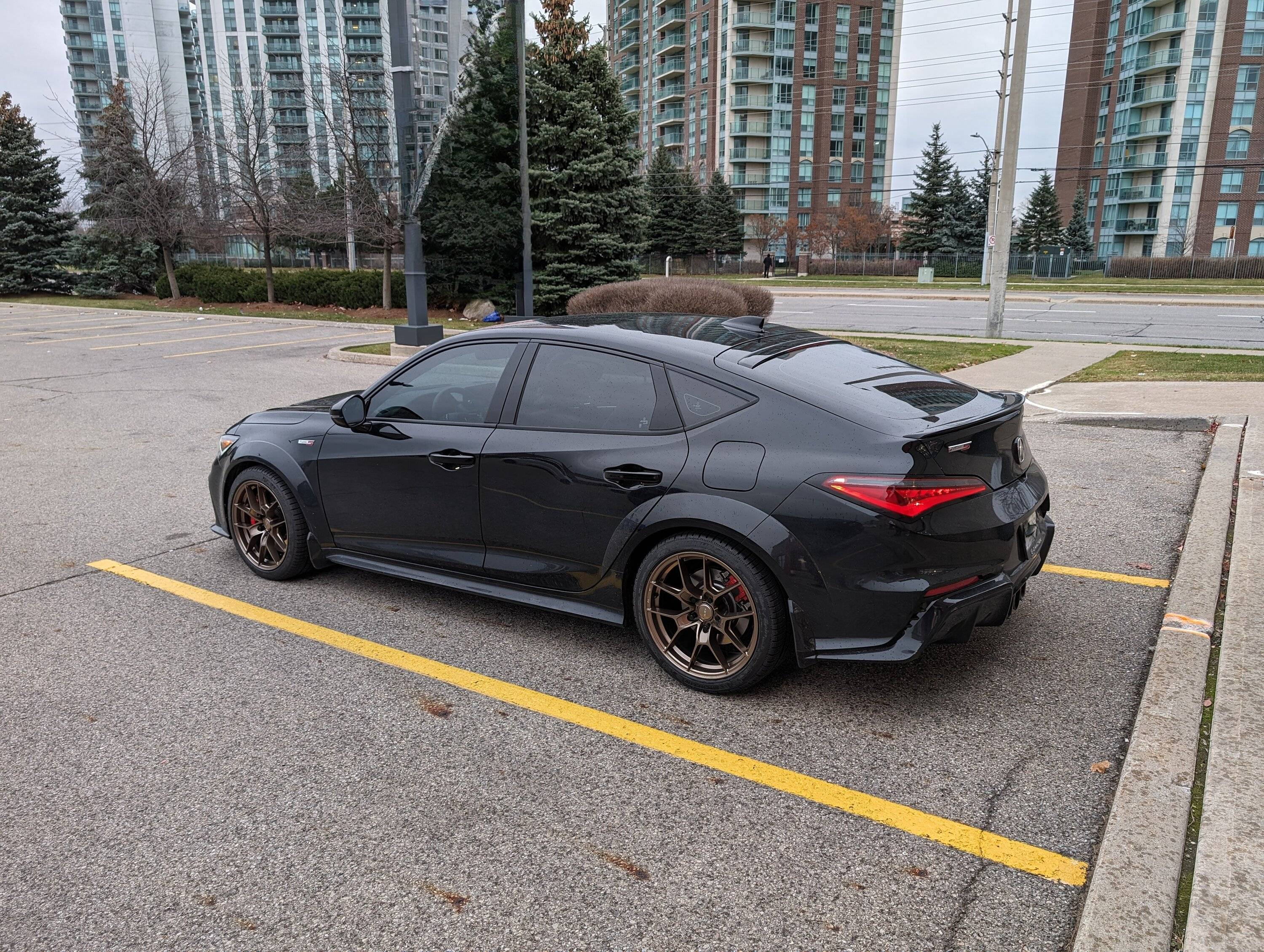

I got my winter setup recently. Haven't had a chance for a better photo. It's just go go go with kids.
T1 motorsports got a local wheel maker OPE made a custom +45 offset of their FF06 wheels in 18x9.5 and put on Michelin Pilot Alpin 4s, 265/35/R18.
I decided this route because I didn't feel like spending similar amount for 235 width and plan on driving mostly in dry and wet conditions. So thought I'd keep the tire width. It's also a way for me to feel what +45 offset feels like versus stock.
Biggest difference thus far from handling perspective is slower turn-in, which is likely a combination of taller sidewall and difference in tires. Have not noticed any torque steer within traction limits. Grips really well in wet, better than ps4s during rainy summer days.
There's a bit of worse stability but I found one tire a bit low on pressure in the back so thinking that might be the issue.
I do like to push the car to its limits whenever I can in corners and accelerating. So this is encouraging. Though I'm sure handling feel might be accentuated by summer tire treads.
