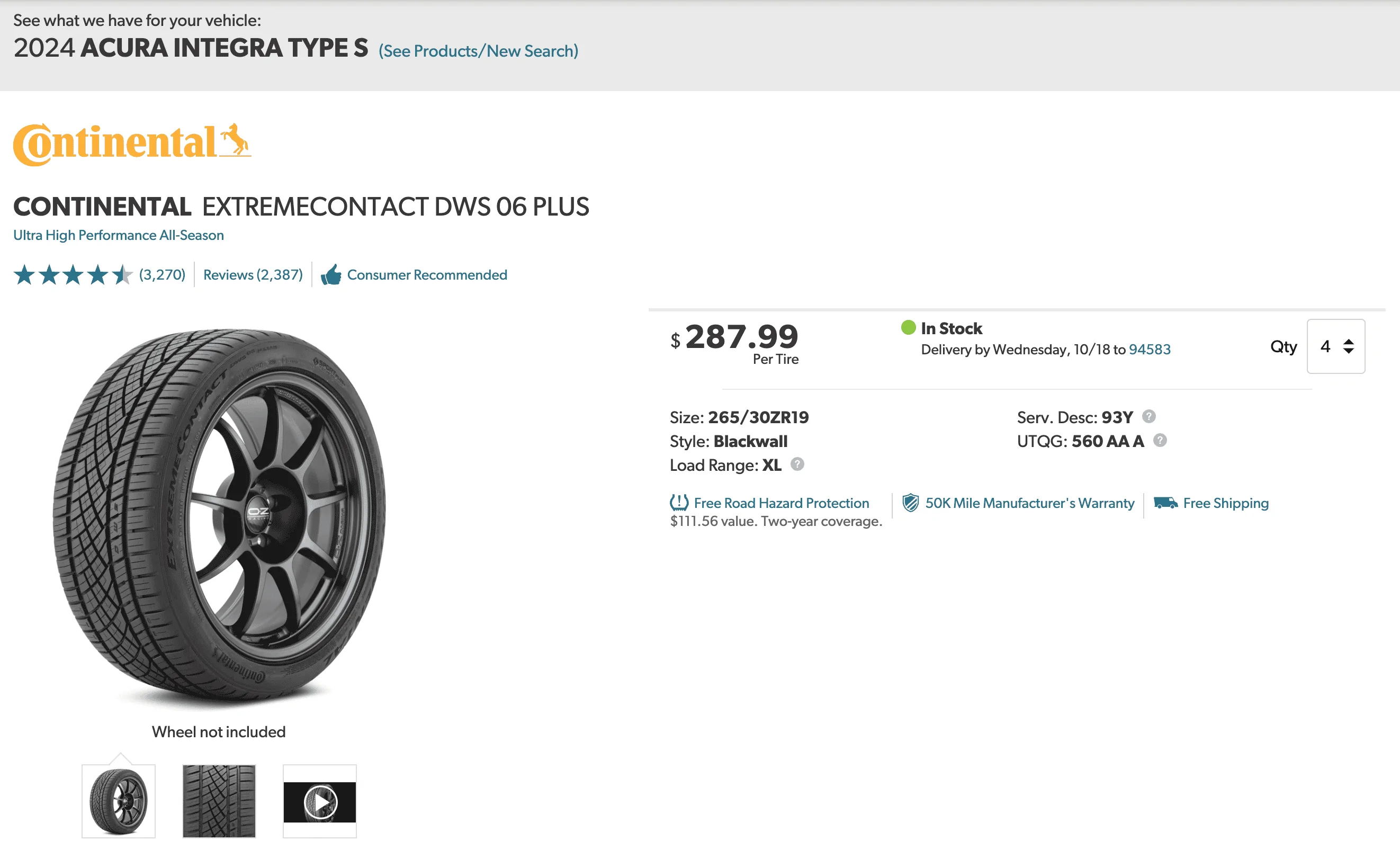

I actually didn't spend much on on researching. I used Tire Rack and the only all-season tires they show there are:
CONTINENTAL EXTREMECONTACT DWS 06 PLUS
I haven’t considered the 30 profile tires because New England winters (aka potholes) can be rough. I’m also hoping the 35 profile will give me a softer ride.

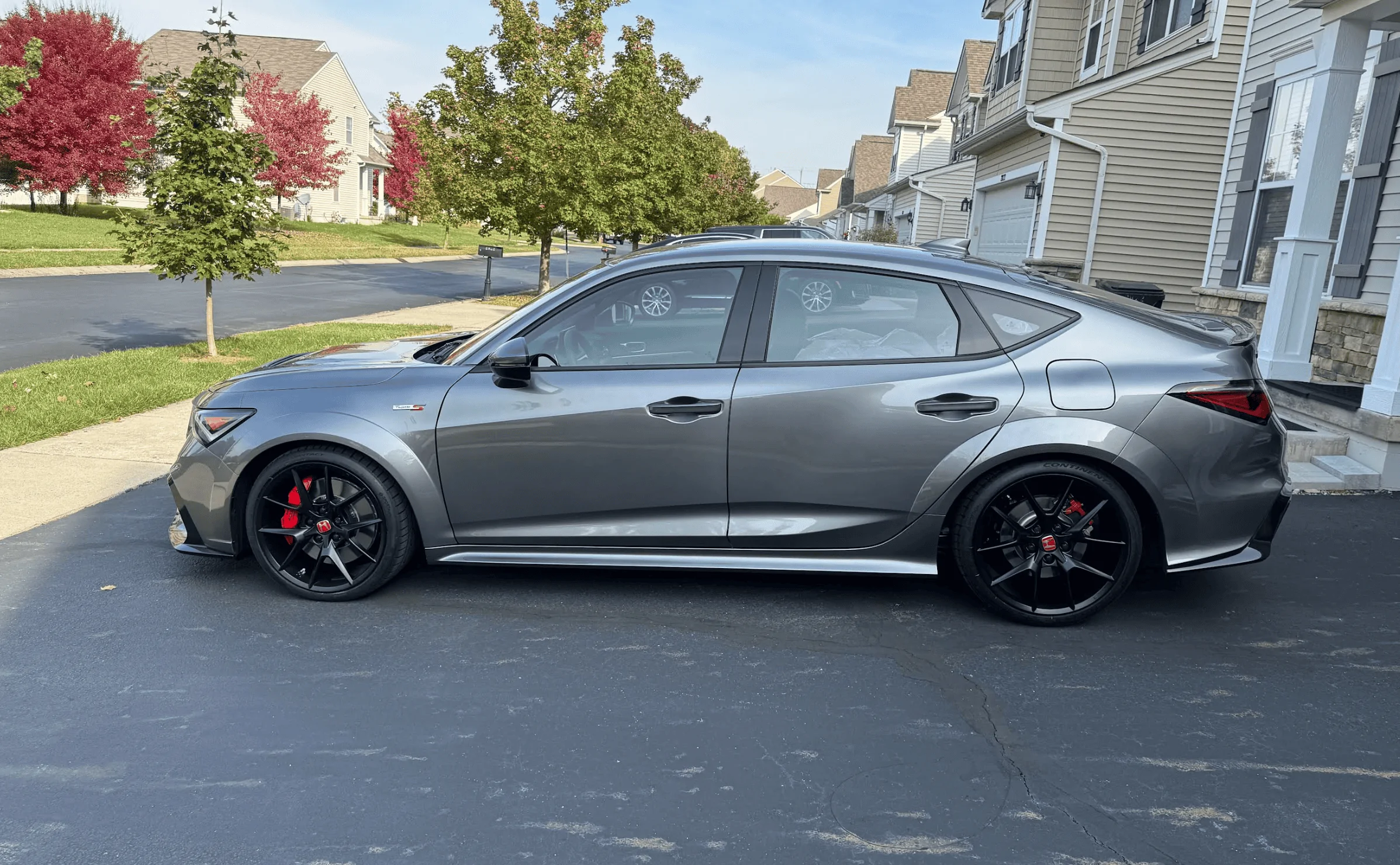

Got my winter wheels mounted n put on the car today. Really liked the way the FL5 wheels look so I went that route. For anyone thinking about that n still want to use tpms sensor. The tire shop didn’t want to replace the stock FL5 valve steam on the Ctr wheels with the tpms ones bc the tpms is straight n might hit the front calipers. The stock FL5 value stems are a 90 degree bend so it doesnt hit the caliper. I didn’t even think about that before buying the wheels. I was wondering if the different style valve stem was going to be an issue. They were able to use a band n install the TPMS inside the wheel. Can confirm that works n TPMS sensors reads fine.

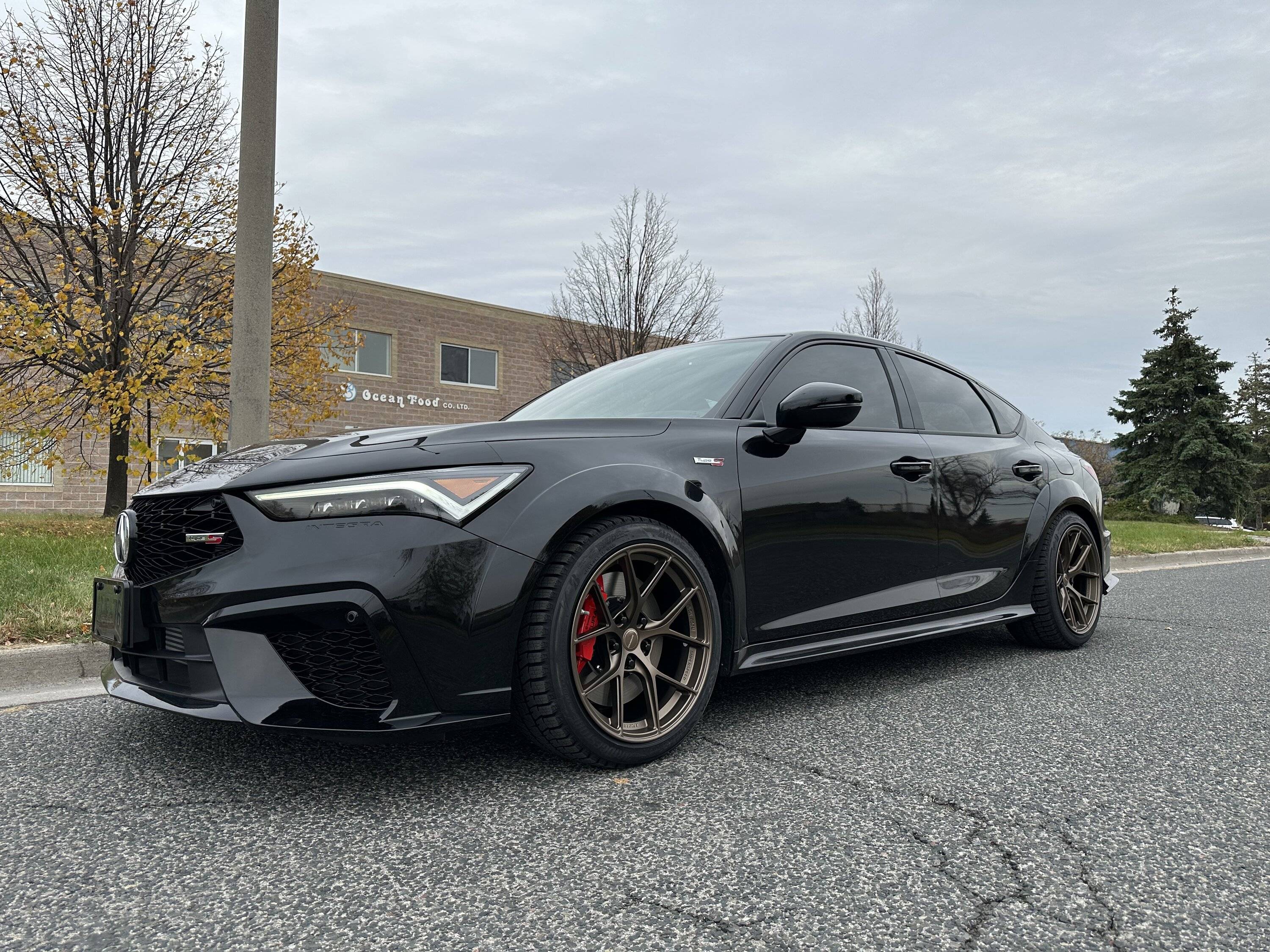

Got my winter setup put on today. It’s earlier than I would normally do the swap but I am trying to avoid the rush in November.
Set up numbers plz
