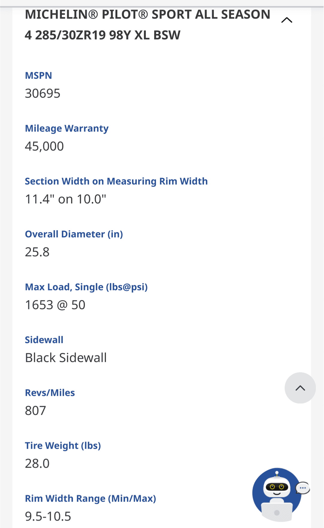

Seems to be a lot of talk about going Continental versus Michelin in the Ultra High Performance All Season Category. I noticed that in our typical sizes the Conti's are actually about 3 lbs. lighter than the Michelin's. That is quite a bit, about 22 lbs. per versus 25 lbs.

Because cont's dont have a sidewall and use less rubber/not as round as the mich ...j/k....
ITS is already a featherweight few extra pounds aint gonna hurt much...jmho....either one would be a decent all season tire...I'm leaning towards the mich
Continentals are the only ones that offer OEM sizes. All else being equal, I'd choose Michelin- but I've had DWS06+ on an S4 and thought they were great.
