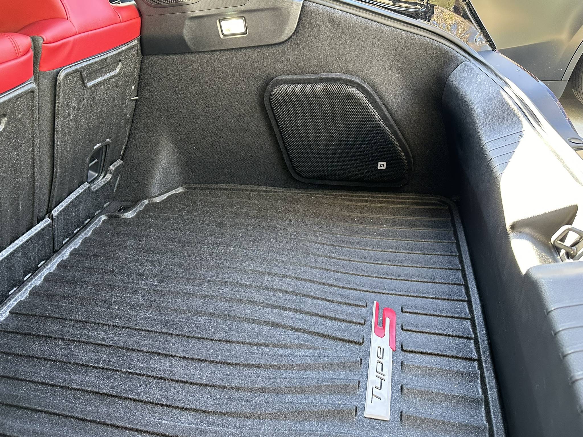

I have been unhappy with the bump in the ELS system and wanted to upgrade the woofer to get a little more umph but did not want to modify the stock box. I wanted some performance upgrade with very little work. So, when Palindrome Labs announced they were working on a kit, I jumped on the pre-order, and it arrived today. I just completed the Stage 1 upgrade of the stock ELS woofer to an AudioControl SPK-8S2 with the Palindrome Labs Subwoofer and Grille Kit. Here is a sound snippet before and after. I honestly feel it sounds a lot better and am happy with the outcome.
Was it worth it? For me, to be able to upgrade with very little modification. Not having to cut into and modify the stock subwoofer box and not having to take up any trunk space for a new box is a win for me. only modification that needed to be done was to replace the stock grille.
(https://balladesports.com/.../de4-de5-integra-type-s...).
This was at Volume 13 only.
It it best to run a single voice coil sub with the stock amp? Most have duel voice coils.
I think I might go this route but want to get a sub that will hit the Hardest on the stock amp. Does anyone have any speculation of what 8 inch sub would be the best possible for that factory setup in regards to the most bass?

To run off stock AMP, you need to make sure it’s a 2ohm woofer. It doesn’t hit as much as I wish it would, my wife’s model Y still sounds so much better. I am eventually going to upgrade everything and including the door speakers. I’m just glad I didn’t have to cut up the OE box

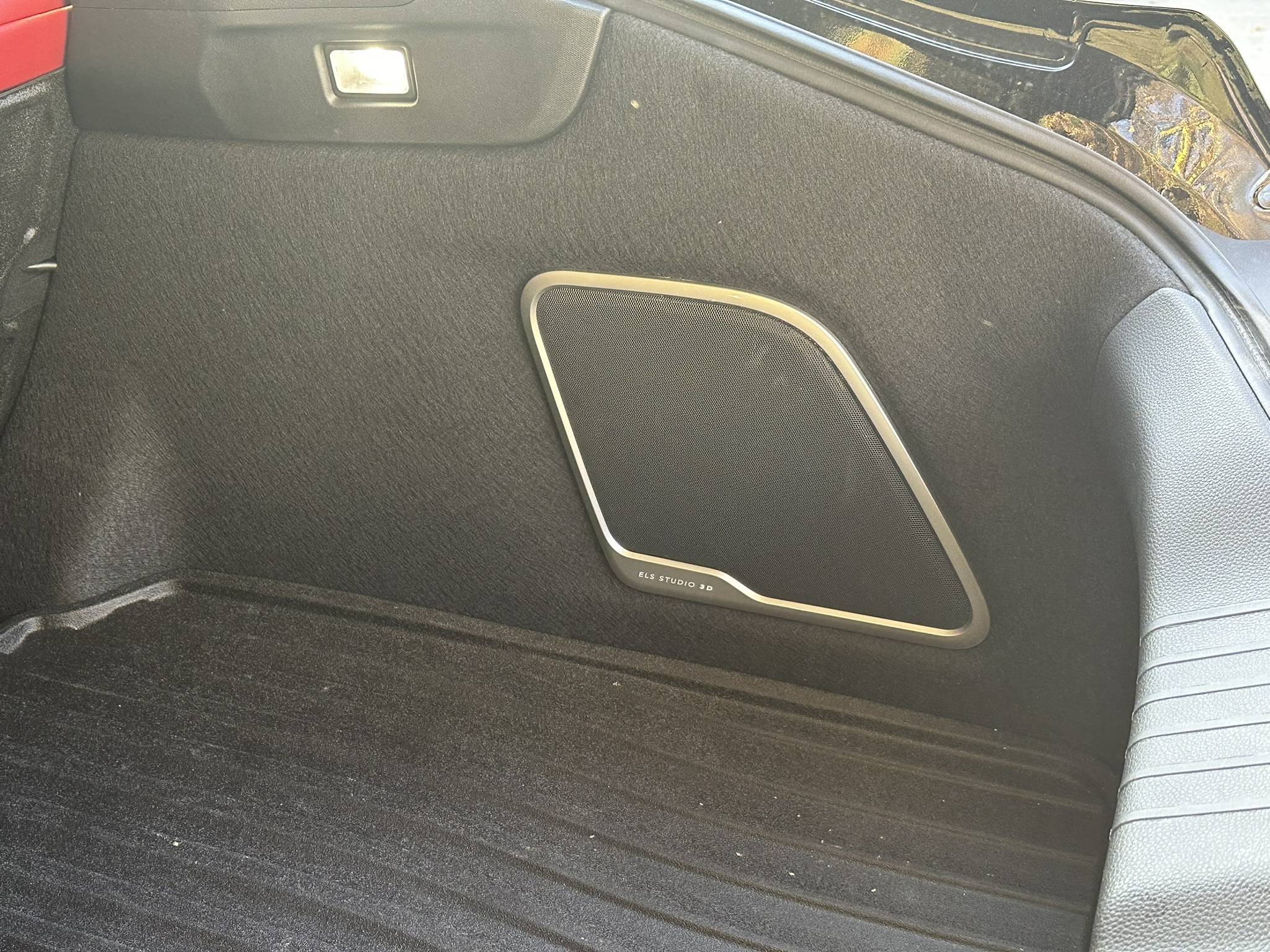

TBCH, I don't like the grille design or that it sticks out so far. I guess they had to do that so the upgraded sub-woofer would fit, but others have been able to upgrade the subwoofer and still use the original grille. Though, I think they did modify the stock box, so I guess that's the trade-off.
Do you know who nodded the stock box?
@acurax do you know who modded the stock sub enclosure? Would love to see exampkes/chat with them for inspiration
