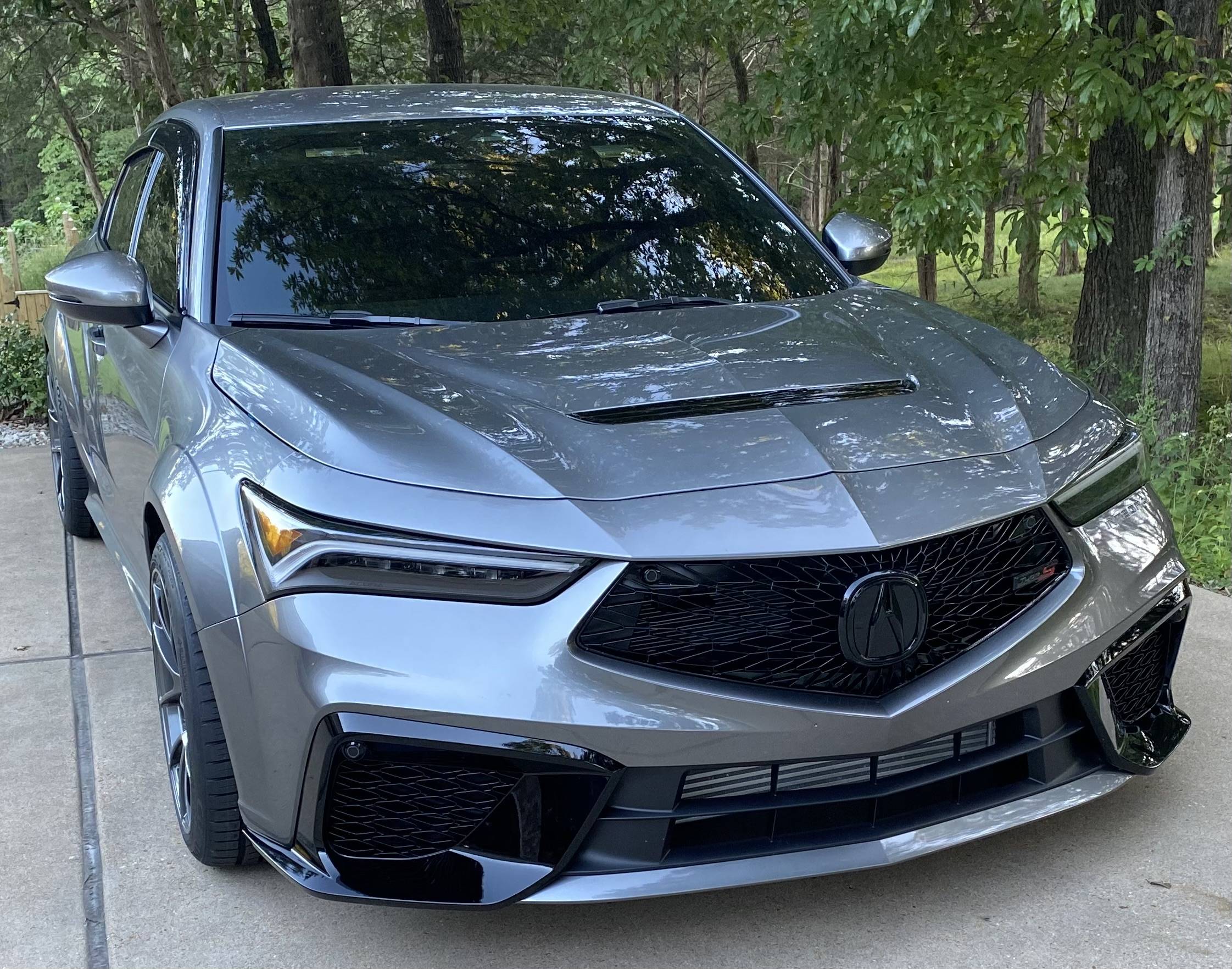

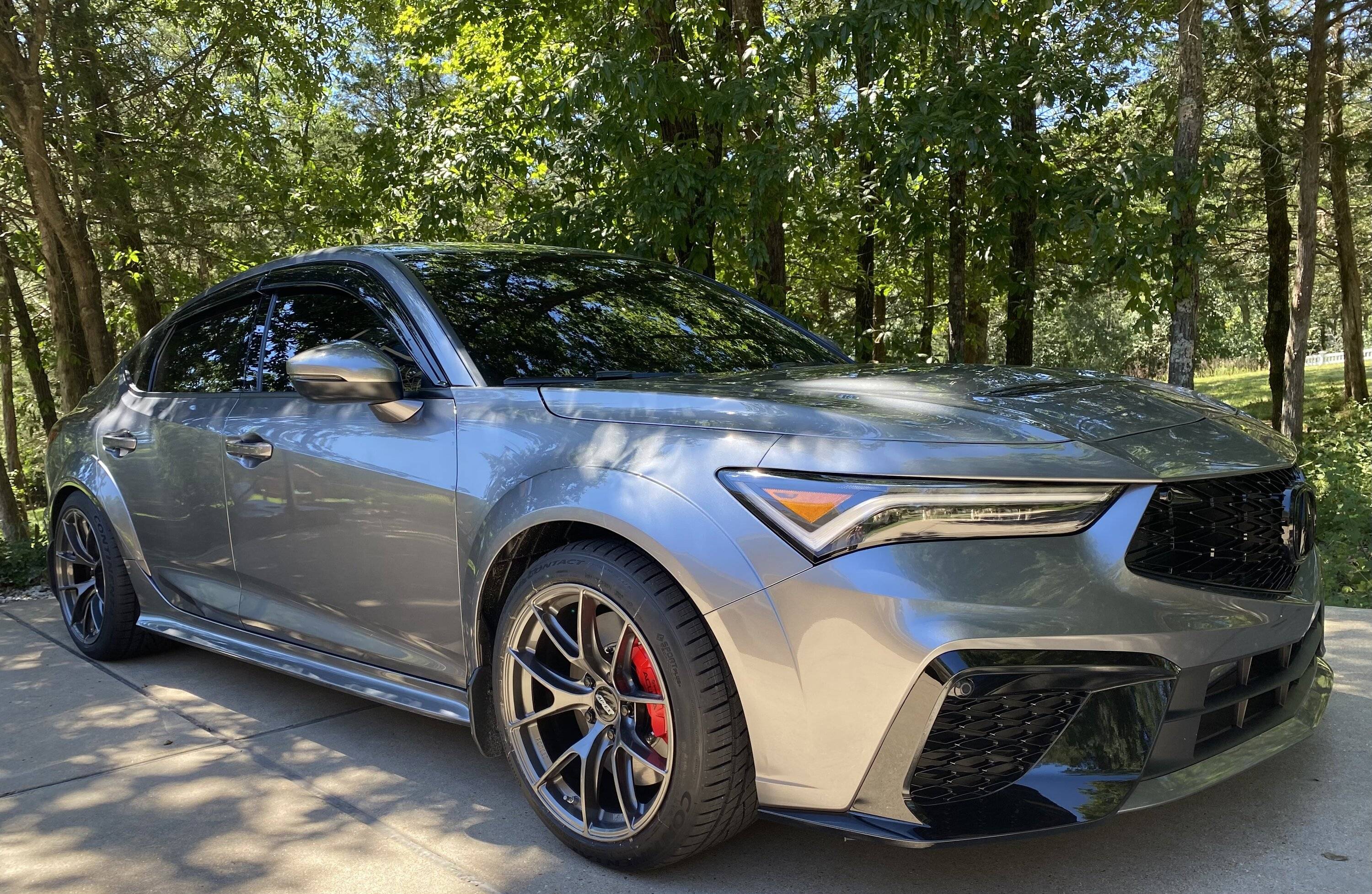

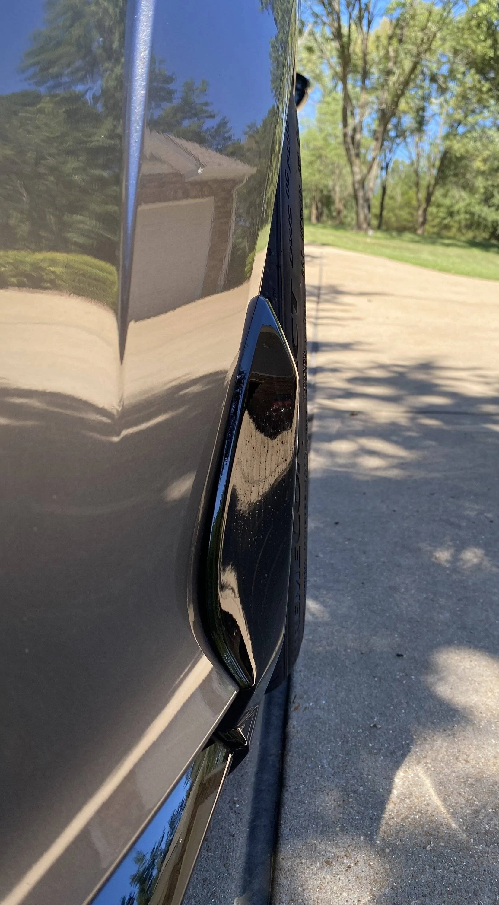

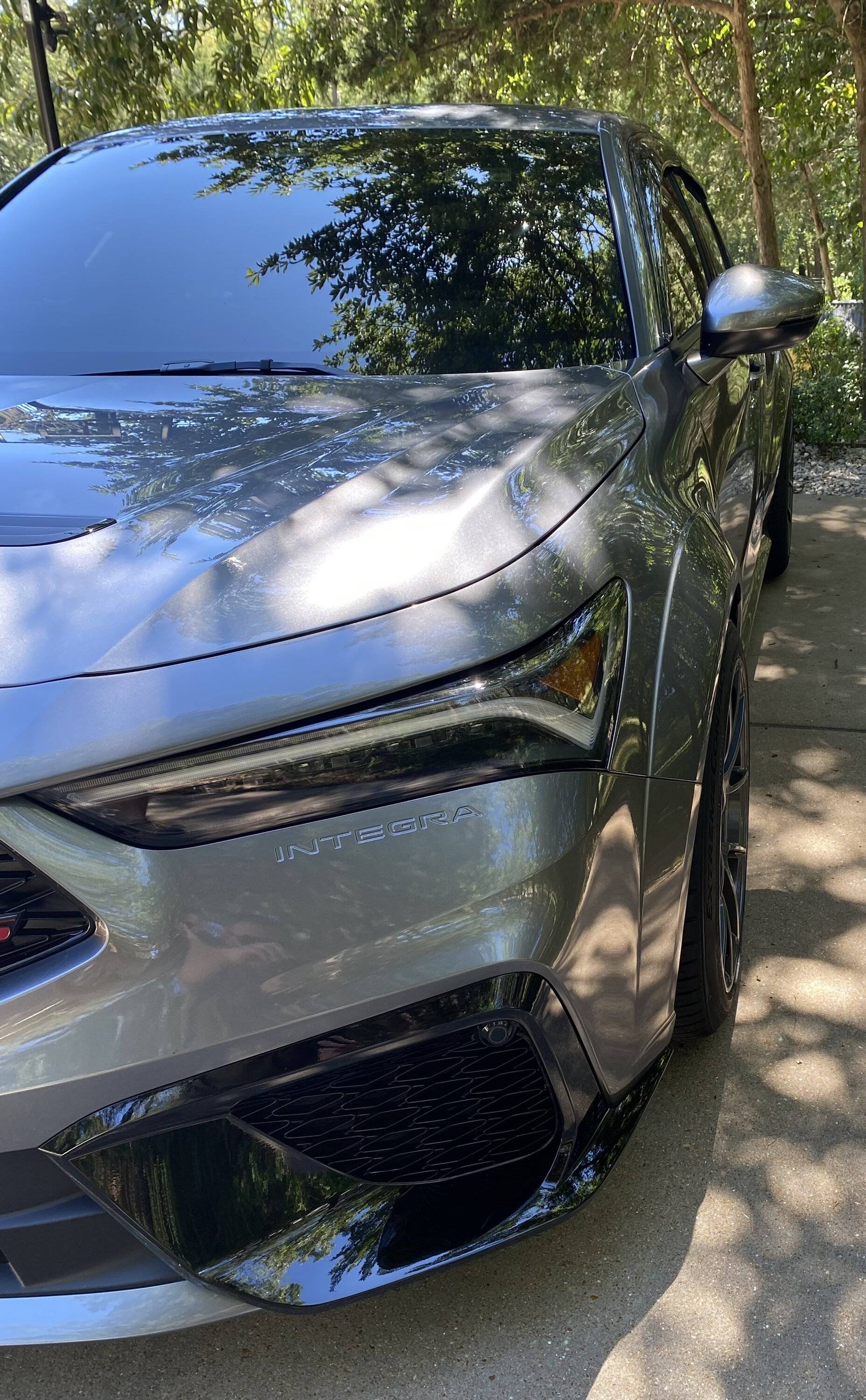

Ok, so posting here as requested as well. I don't have really any quality pics yet since I haven't removed the tire lube & had to rush inside for a meeting, this will give you an idea of the wheel/tire fitment. I was surprised there wasn't more of a tire gap. Looking at it now, I don't think there's any reason to lower it via springs or Ohlins or whatever else - as far as looks go.
Apex Forged Sprint Line VS-5RS face profile 3 in Anthracite - 18x10.5" ET47.
Continental ExtremeContact DWS06+ in 275/35/18.
Drop dead gorgeous😍
The wheel design, color and fitment are perfect!

Thanks! Couldn't be happier with them so far! After I send Apex the photos they want for that 10% rebate discount, I will probably put the Acura logo center caps back on.

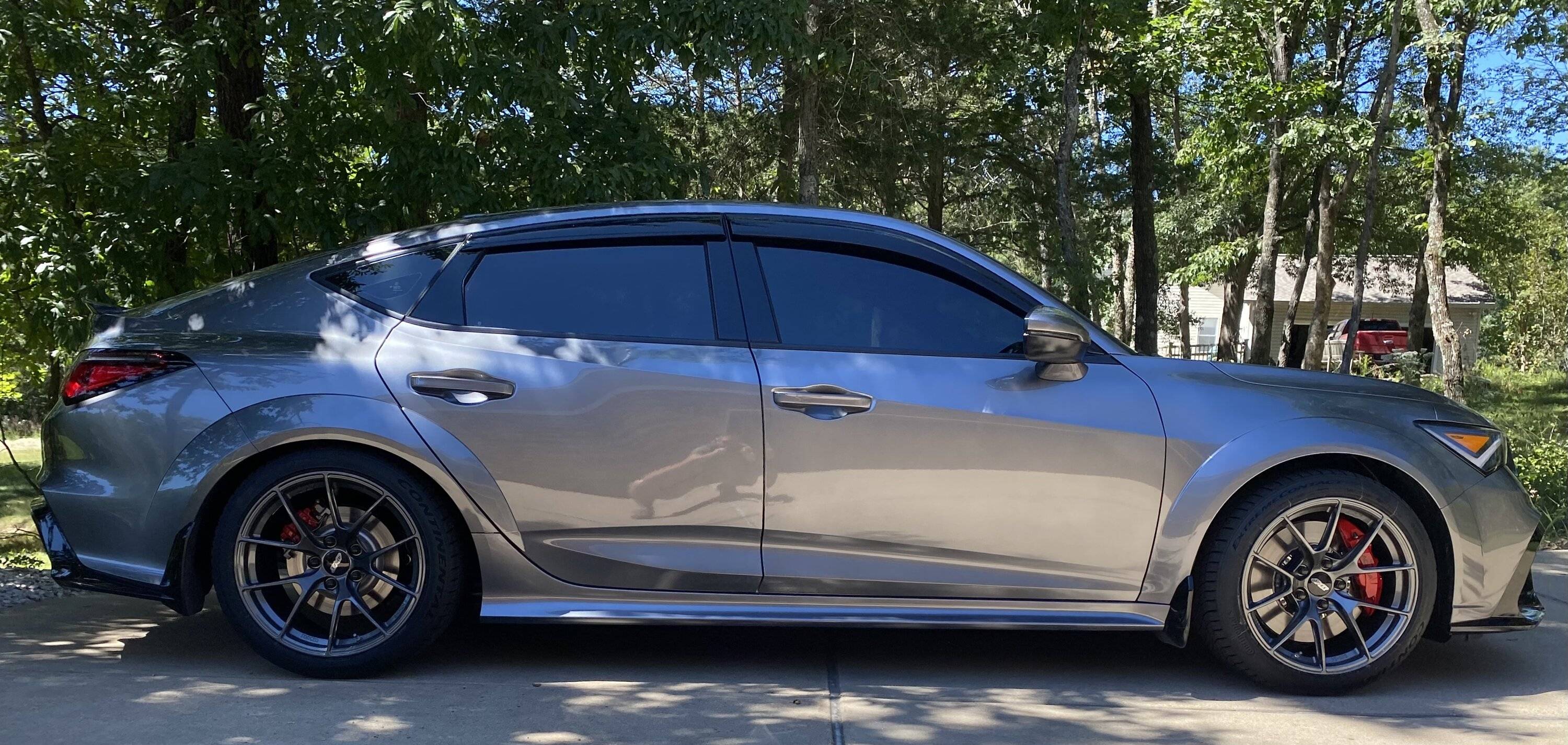

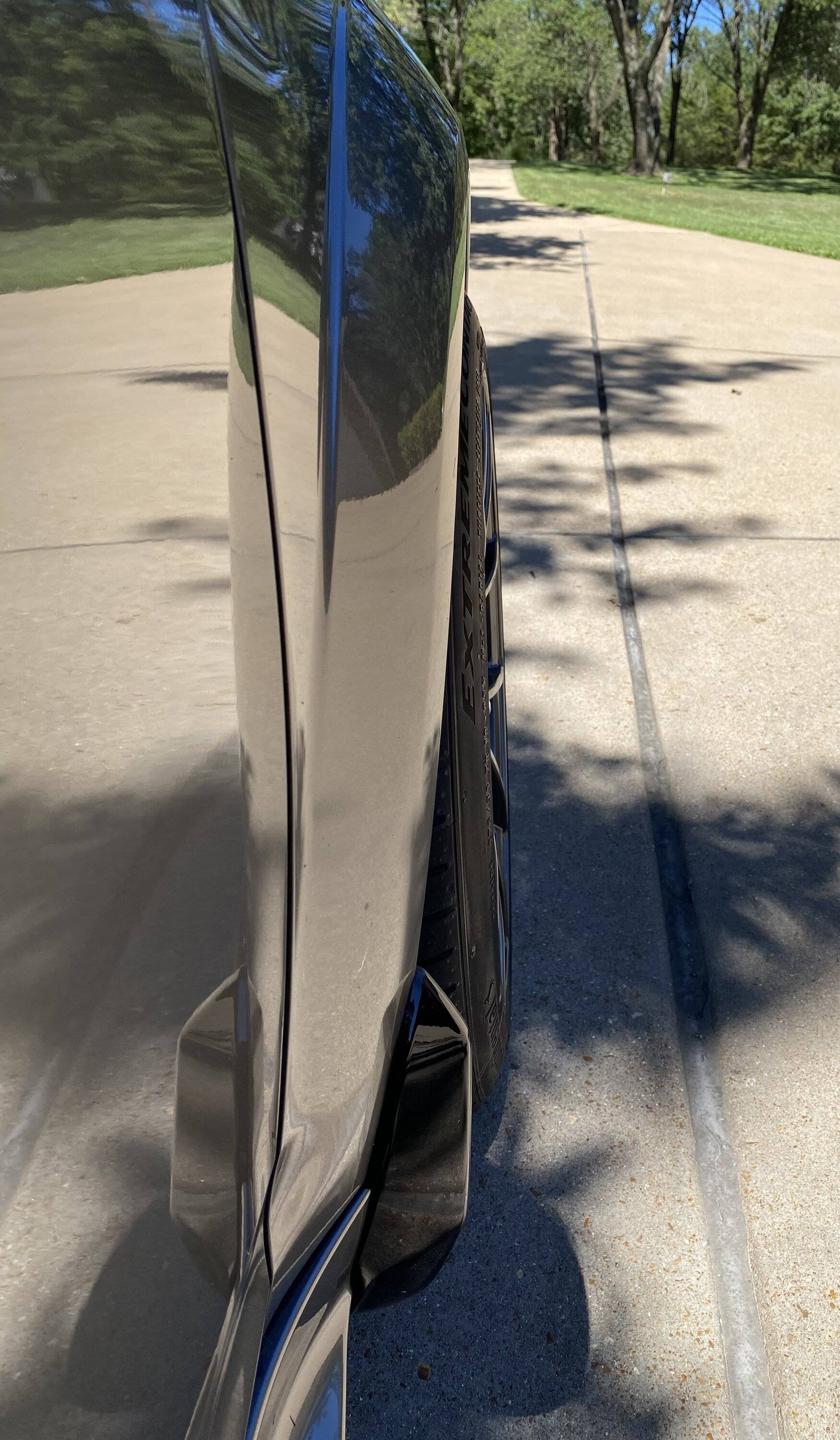

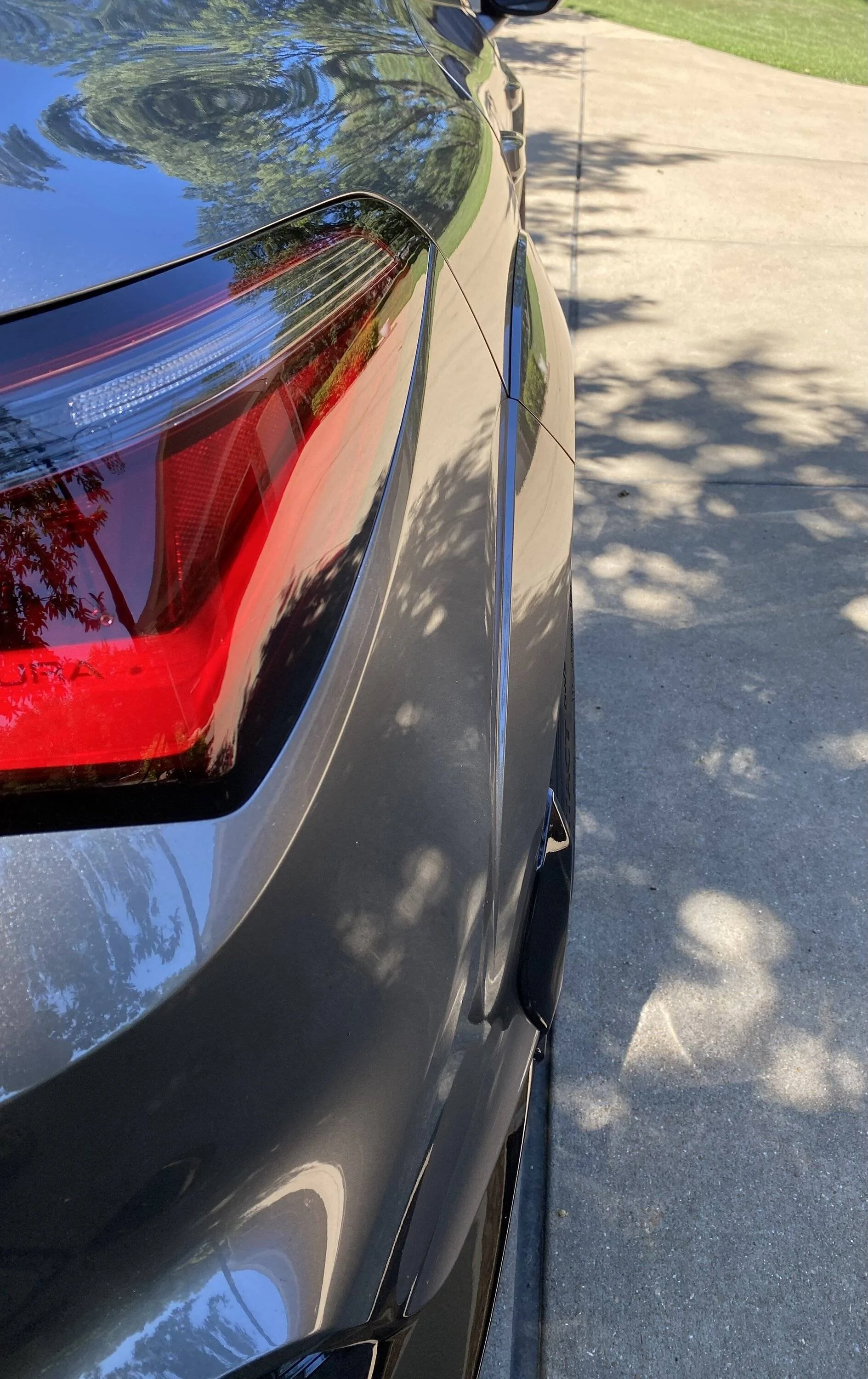

Surprisingly no rubbing at all even under load with the oem wheels & tires in back or at full lock!
Wheels look great and tires are meaty! Did you have the OEMs in the back when the pics were taken? Looks like less wheel gap on the rears.
1,465
1,149

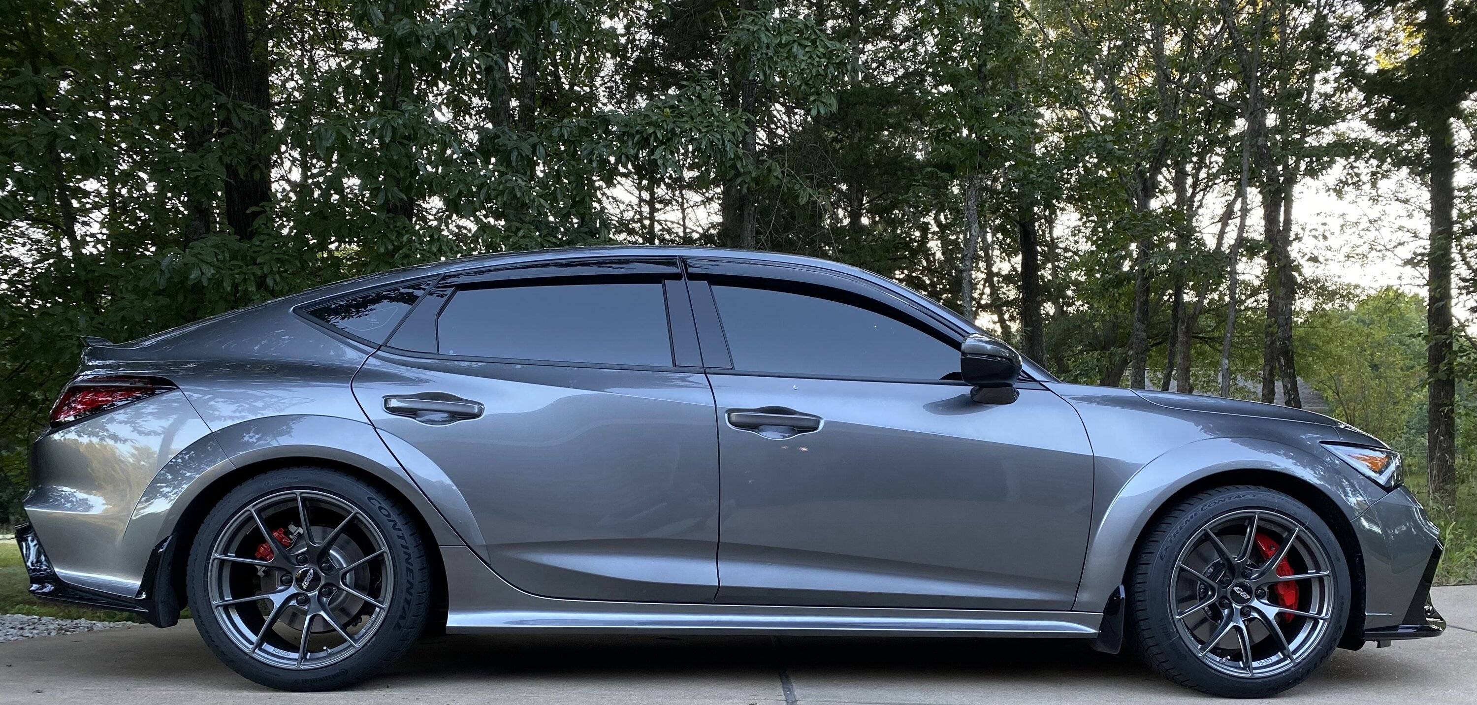

In the first group batch of photos, yes the oem wheels were still in the back - but the most recent photo above they were unloaded. I was very surprised with the minimal gap!
Sunny photo loaded, dusk photo unloaded.

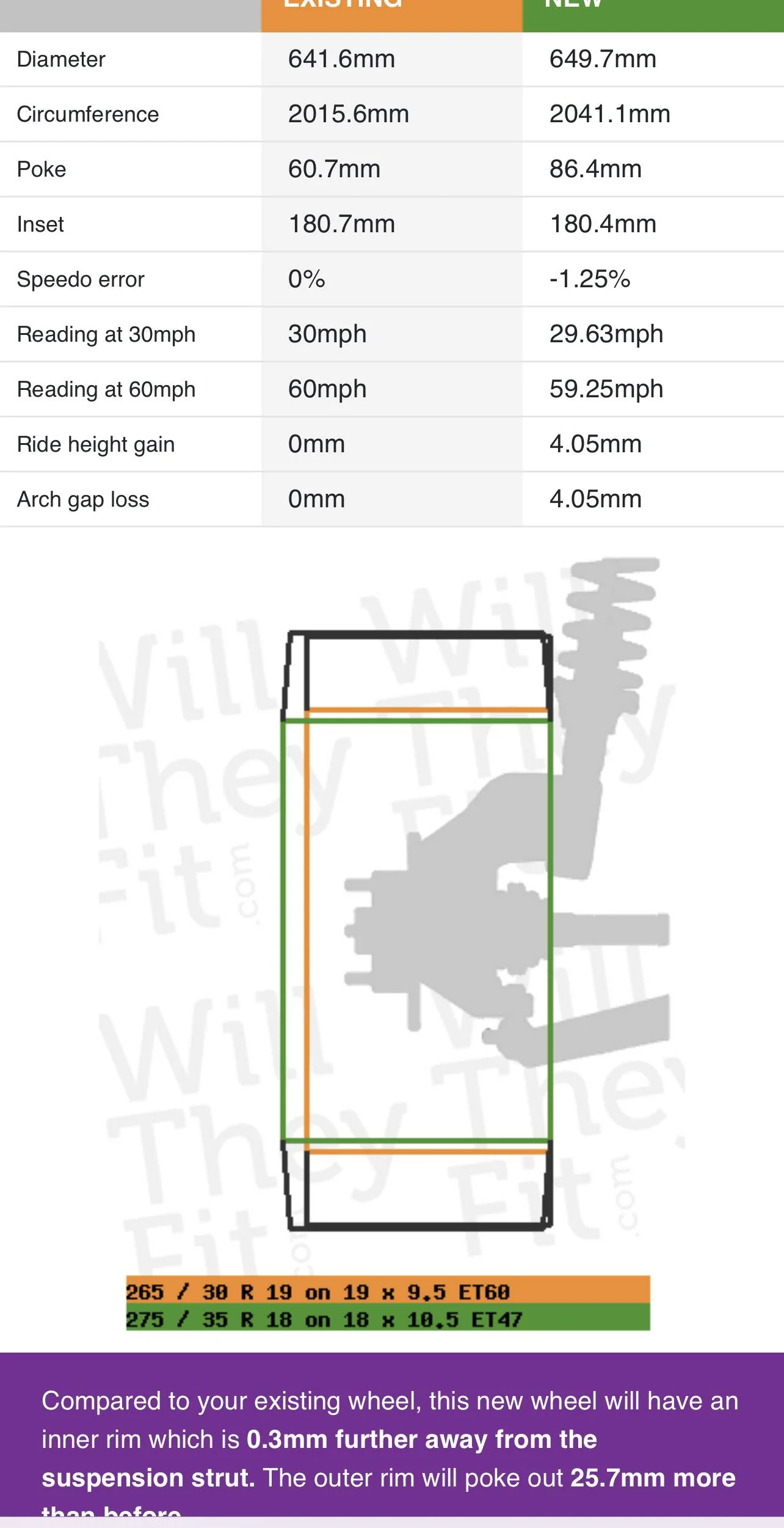

Looks meaty good. I could see just a small drop, if you wanted to get that full flush look. Inch front and rear could be perfect.
so that set up is just a bit taller too.​
