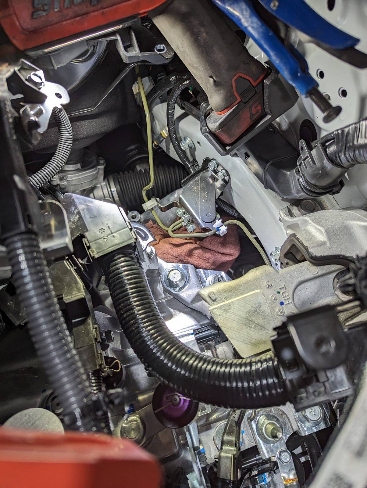

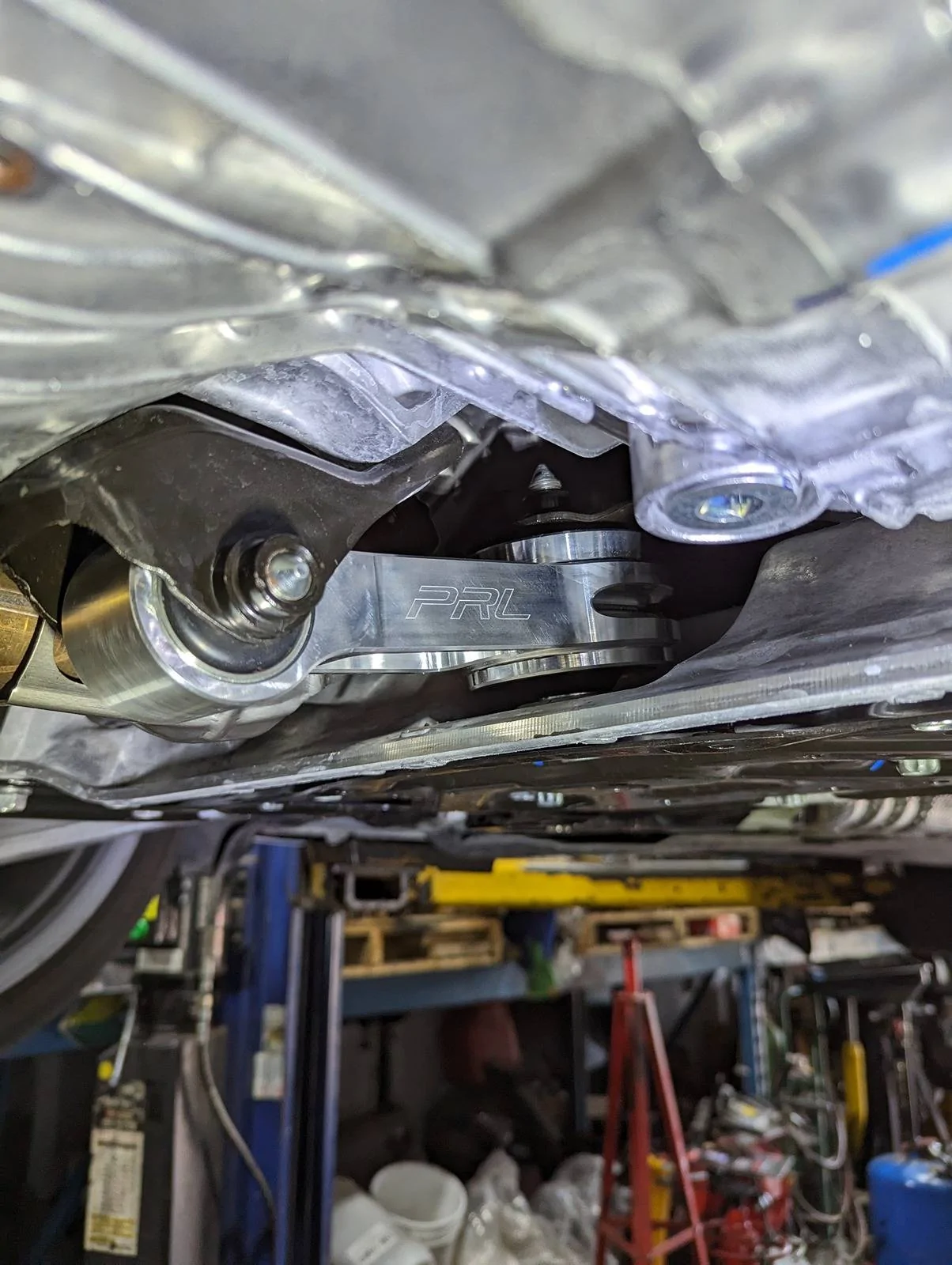

Installed today:
Spoon Rigid collars
PRL rear motor mount
Sirimoto clutch damper delete
Acuity shifter cable bushings.
The car does not like having its battery removed as it wouldn't crank for a short while after putting everything back together. Then the Christmas lights filled up my dashboard after we got it started. All good now though.
The motor mount increased a bit of vibration at idle and some noise as you're in motion, but it really is minor.
Overall the car feels tighter and the clutch is easier to modulate imo. Initially my concern was that these mods would dramatically alter certain facets of the drive, but that isn't the case at all.

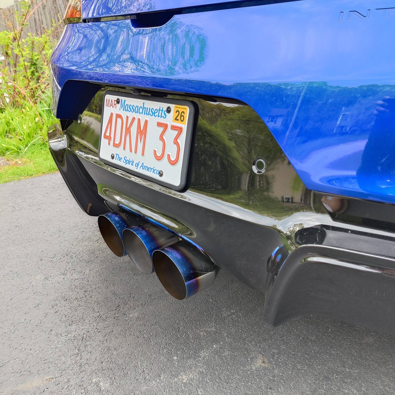

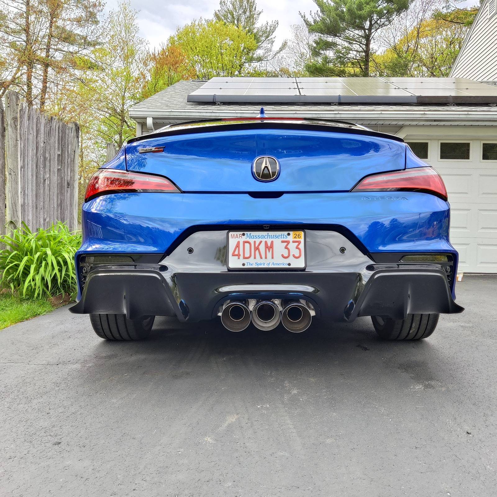

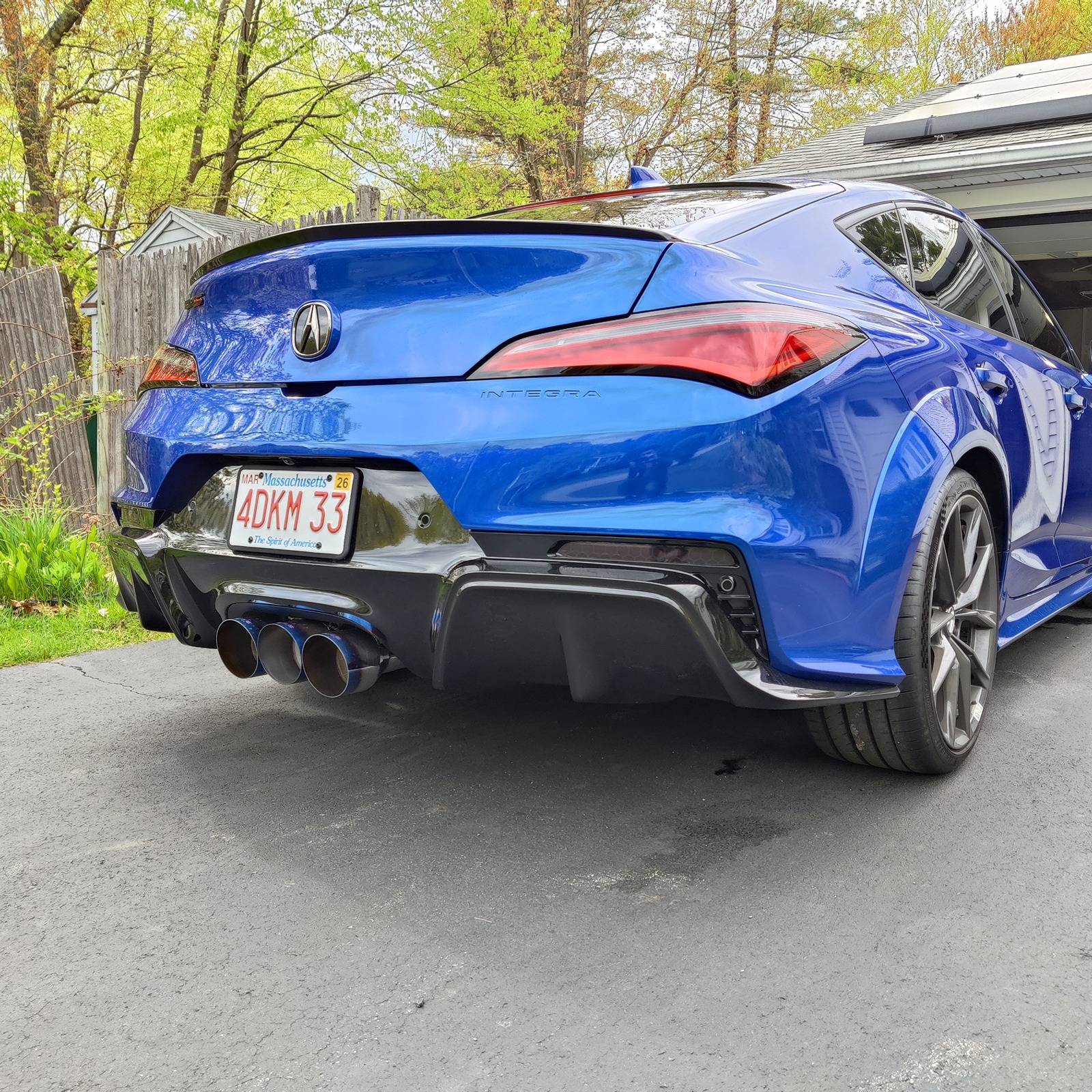

Sound clips of the MBRP (unresonated)!
There's a "hiss" in the audio which is just the sound bouncing off my garage walls and doors. Just general ambient sounds. I recorded the video about 3 feet from the rear so everything sounds louder than it actually is.
Notes: This is UNRESONATED.
Findings:
Sound - Is deeper than stock with a nice growl. All modes are like a tick above factory ie, comfort is now sport, sport is now sport+, sport+ is something else entirely, Race(?). Definitely an increase in volume across the board but not obnoxious. Haven't measured the db level yet.
Cold start - Also louder thank stock, not obnoxiously loud but louder for sure. Has a nice grumble to it and even a light pop on warm start. You can hear it at the 1s-2s mark. Neighbors won't mind, I'm sure.
Visuals - Looks great! I might still go with a polished/rolled tips option because I prefer a cleaner/factory look. I've also thought about having the tips coated/painted in a gray/gunmetal. You can adjust the tips (I still need to adjust mine) to your liking.
Impressions:
Comfort mode as we know it no longer exists, sounds like valves are open ALL the time, the biggest change is that burbles are more noticeable (see below on Sport/Sport+). In terms of noise and volume, Comfort is now like Sport, you'll definitely notice and hear burbles (no pops or bangs). If you're looking for stock levels of quiet, this is not it. Even though the exhaust is valved, the valve is only for the center pipe, the side mufflers bypass the valves, hence more volume in all modes. If you're good with throttle modulation you can get the exhaust to be dead silent still, but it's no longer quiet like factory Comfort mode otherwise.
Sport mode is now like Sport+, factory burbles and pops but definitely more volume (louder). No drone on the highway but there's definitely vibration you can feel from the resonance on the floor at about 2500RPM.
Sport+, same as Sport in terms of volume but let me tell you about the noise. There are no burbles here, only POPS and *BANGS*! Super aggressive in terms of intensity though still retaining factory behavior. Videos do it no justice, they are LOUDER than what the video leads you to believe. Those are *BANGS* and *SNAPS* at 58s and all POPS afterwards.
Overall, I don't know how I feel about it just yet because I typically drive in Sport+ throttle mode anyway but having a "silent" comfort mode is nice for when I don't want any attention. Now I'm in the "new" comfort mode most of the time instead because it's loud enough to be enjoyed and the burbles satisfy that part of my lizard brain. Sport mode for when I'm looking for a little more drama. Sport+ only when I'm feeling rowdy and no other cars around. I'm too self-conscious to open it all the way up otherwise. This actually works out for me because I prefer the throttle mapping on Sport and Comfort compared to Sport+. YMMV.
I'll try the resonated version next weekend as I get some more seat time on the current set up. I have I feeling I'll like the resonated version more.

Nice, did you happen to install the rigid collars yourself?
Curious how difficult an at home install would be, and how long it would take. If not, would you reco the shop you had it done at, I'm in the GTA on the east end.
wontondon
Apr 11, 2023
113
136
Ontario, Canada
DE5, MK7 GTI
No, had it done at a shop due to a personal lack of experience in lowering the subframe. It was about a 2 hour process when carefully following the instructions step by step.
i had mine done at RiWorx - located in Northeast Mississauga. These guys took the time to do things correctly - printing off additional torque specs for all bolts, for example.
Interesting to note for all DE5 owners - my subframe bolts were all very loose from factory, almost to the point where you can loosen them by hand. Even if you don't get the rigid collars installed, would highly recommend checking those to ensure it's within spec.
